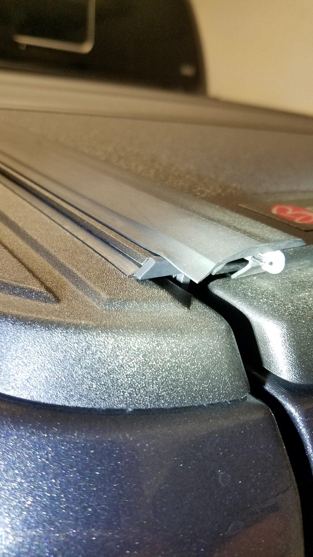

New rails came in. Still lots of aluminum shavings. These rails are matte instead of gloss (which match the bed rail caps) and the ends of the rails now have a rubbery cap to cover the aluminum ends and sits up against the tailgate. The prop rods are held by a much more secure clip then the first holder. The right rail is still a touch long due to the white plastic rail insert being 1/8" too long so it raises up a bit after closing the tailgate. Overall better fit.

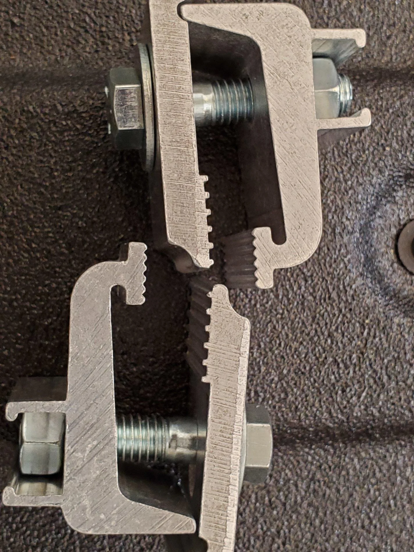

Update: I managed to install my cover with one hand. I removed all the shims from the rails and completed the installation. I didn't like the fit of the rail top seals to bed trim nor the clamp fitment.
got the use of both hands and reinstalled the rails after adding the shims back to the rails and making a slight modification to the clamps.
the instructions for the Ranger states the importance of fitting the clamps as high as possible on the grooved surface of the rail. The clamps will not go up to the top groove so I removed just enough metal from the clamp to allow the clamp to fully engage the top grooves. This allowed a better fit of the bed side of the clamp onto the tiny metal lip of the bed. With the shims in place and the clamps fully engaged, the clamps stayed straight and tightened down properly and the seals along the top fit better. Here's a before and after comparision of the clamps. Not much material is removed, I tried the fit until the clamp would slide in the grooves.

Thanks a million for this tip. I installed mine which was an absolute pain. Then I read this tip. Removed each one trimmed and reinstalled = fit perfect. Would have saved me an hour if I read this first. Thank you so much. Mad at myself for not thinking of it. A little off made all the difference.

Do you have a picture of the rubber cap on the end rails at the tailgate? Mine did not come with anything.

Hi,
I have serious concerns with this mod It compromises the engagement of the pinch weld flange. I wonder if there will be loosening over time. I had no trouble with my install with no clamp mod.

This mod increases the contact with the pinch weld flange and allows the clamps to fully engage with the rail. Works perfect. Clamps kept trying to flip out before. 1/16” is all it takes.

The groovei n the clamp for a reason. By not using the groove it may cause the clamp to slip in a vibratory environment. the clamp forces are not opposed, thus createng a moment which could exrbate the loosening.

The first rails were just raw, unfinished CNC cut aluminum ends which is probably what you have. These ones have that thin rubber bumper piece. Its enough to not gouge the tailgate but not sturdy against any sort of torsion

Yes mine are raw cut. Luck of the draw I guess.

Mine OEM did not have end caps either, I used silicone. Just put some where the end caps go, cover with wax paper. Shut the tail gate and cover and let dry, then remove wax paper. The reason for the wax paper is so that u do not glue the pieces together. Easy to do and you can get clear, or colored.
