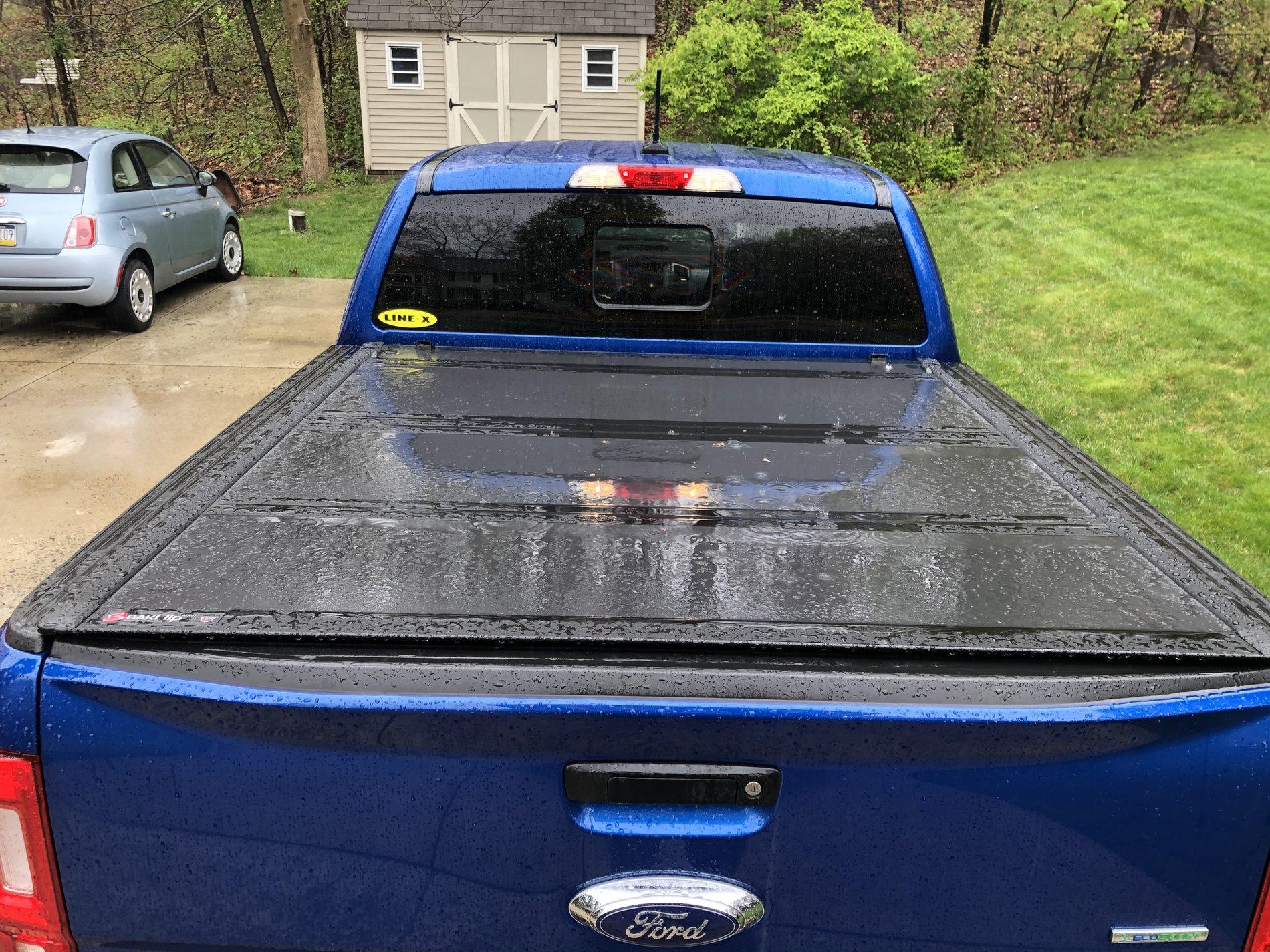

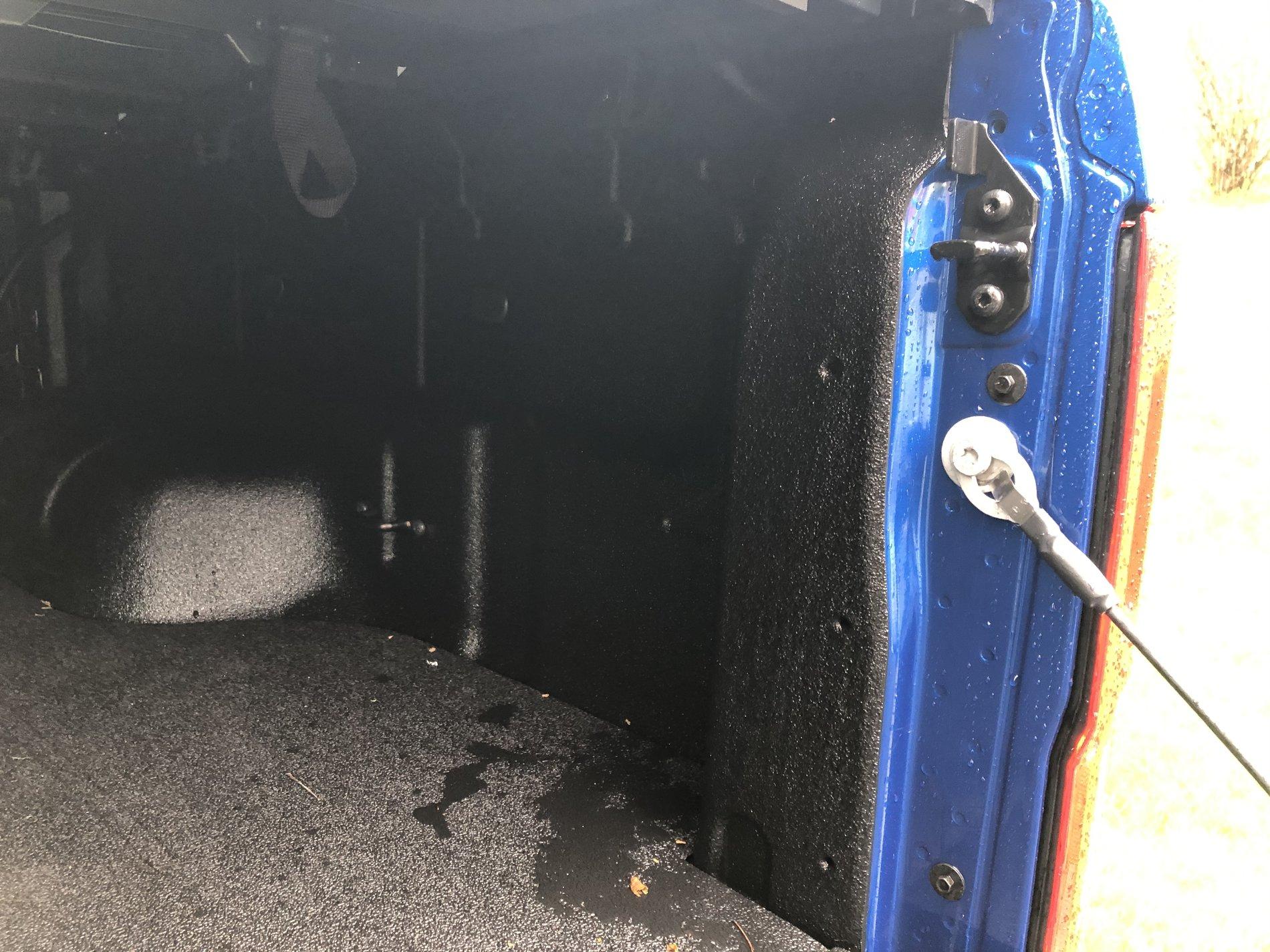

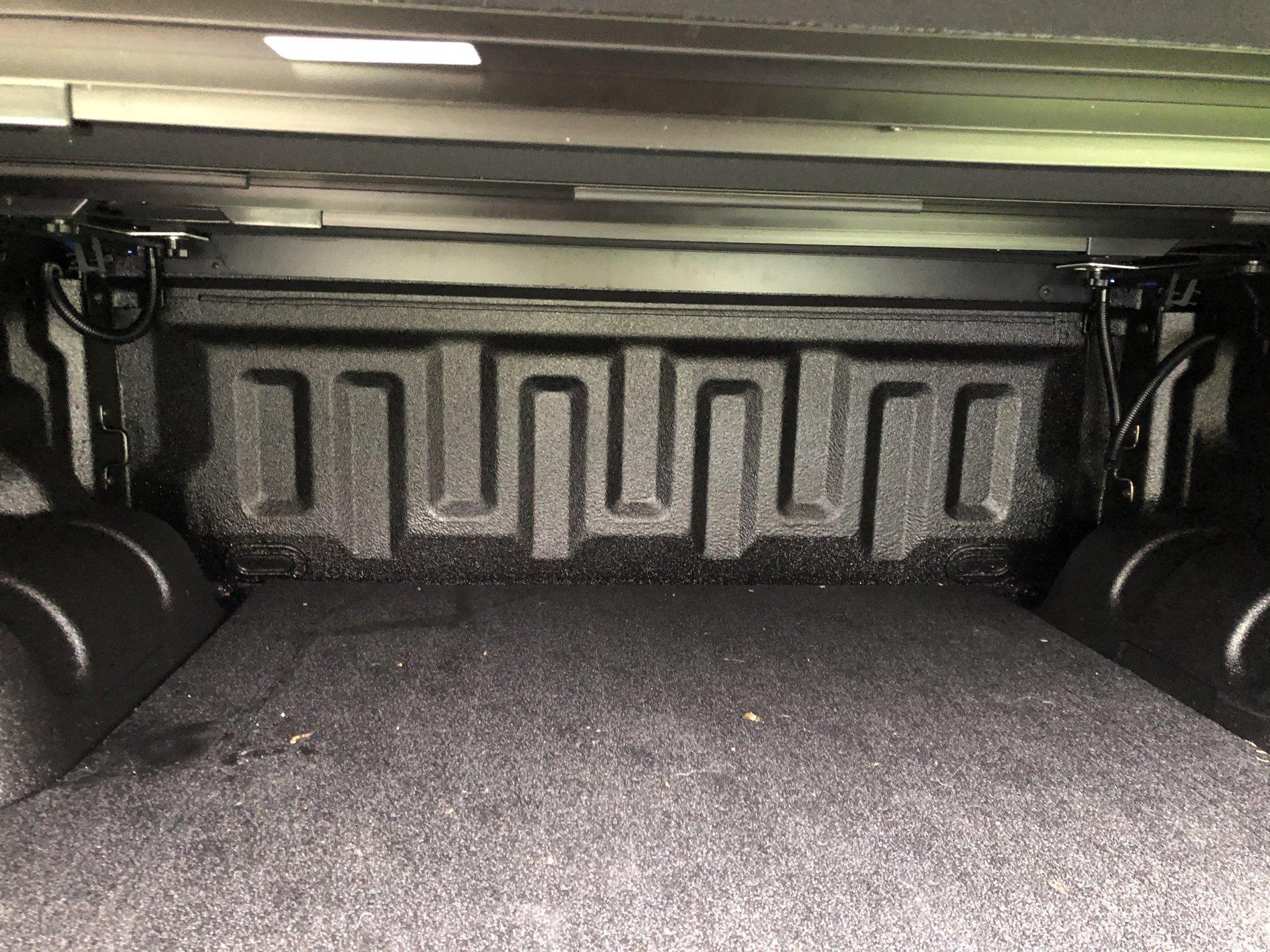

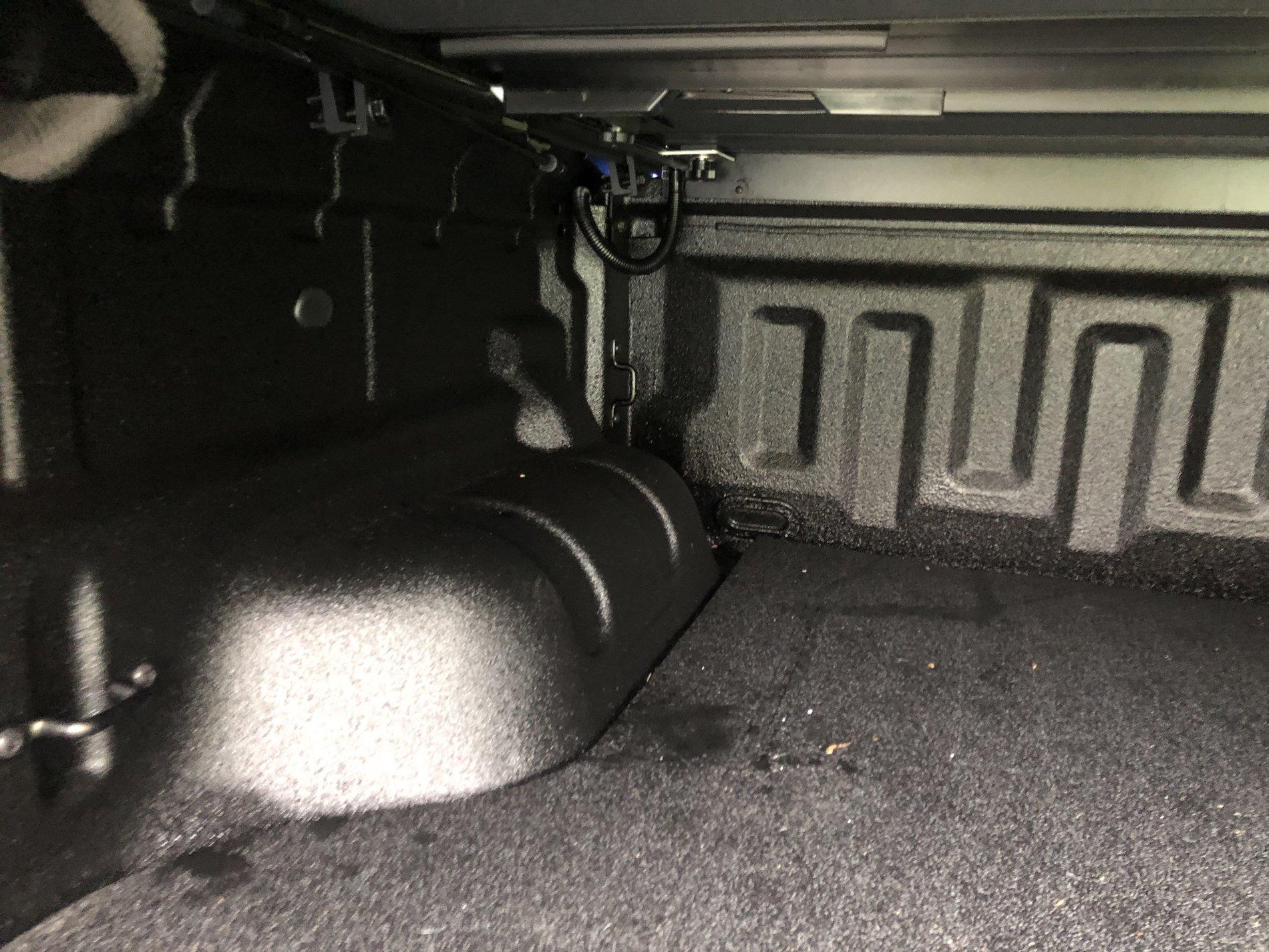

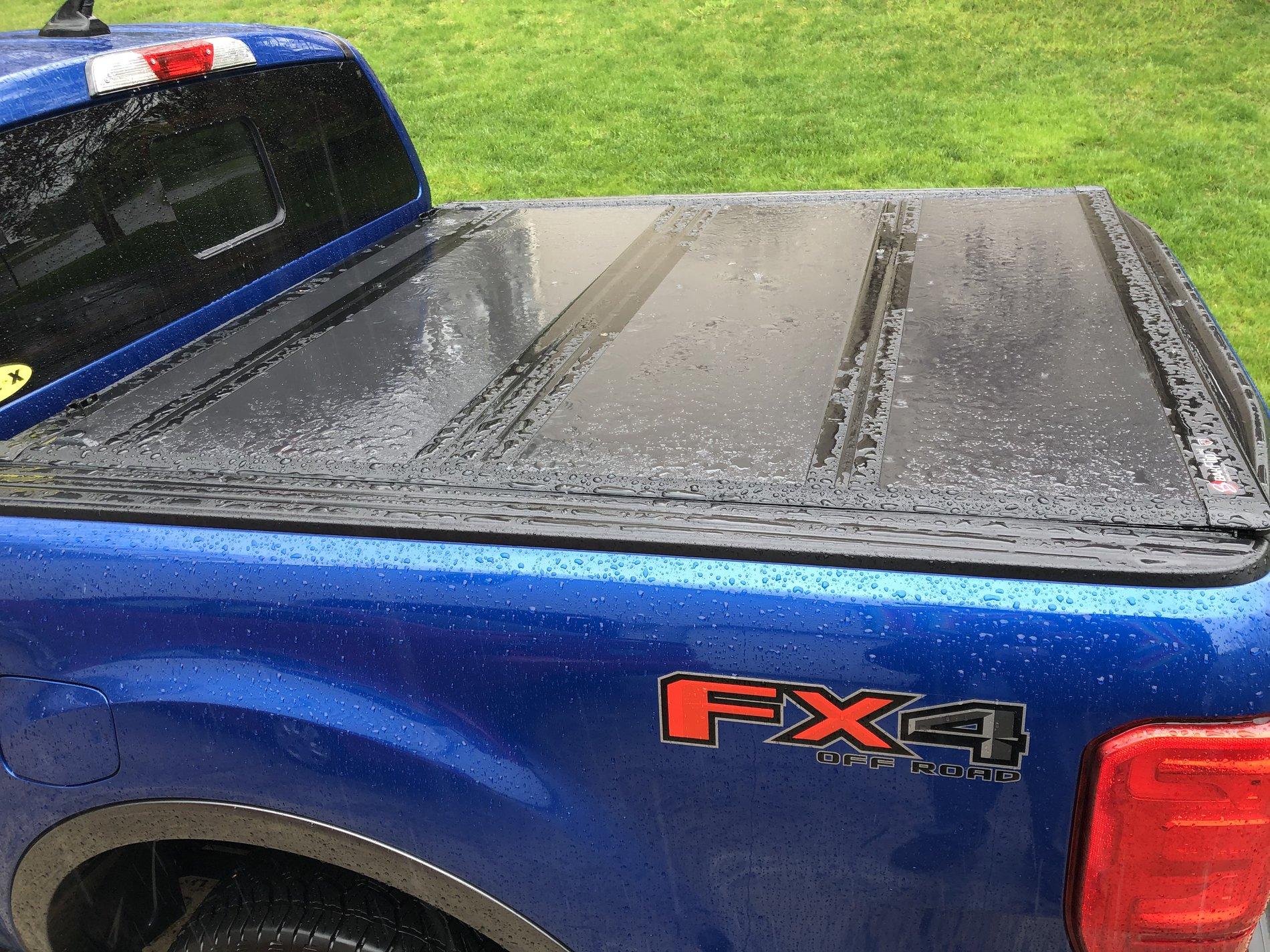

Hello All,

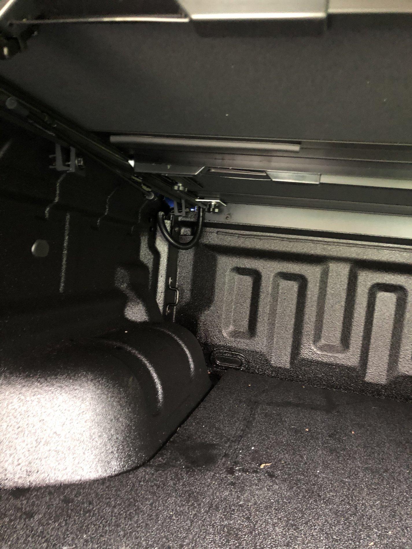

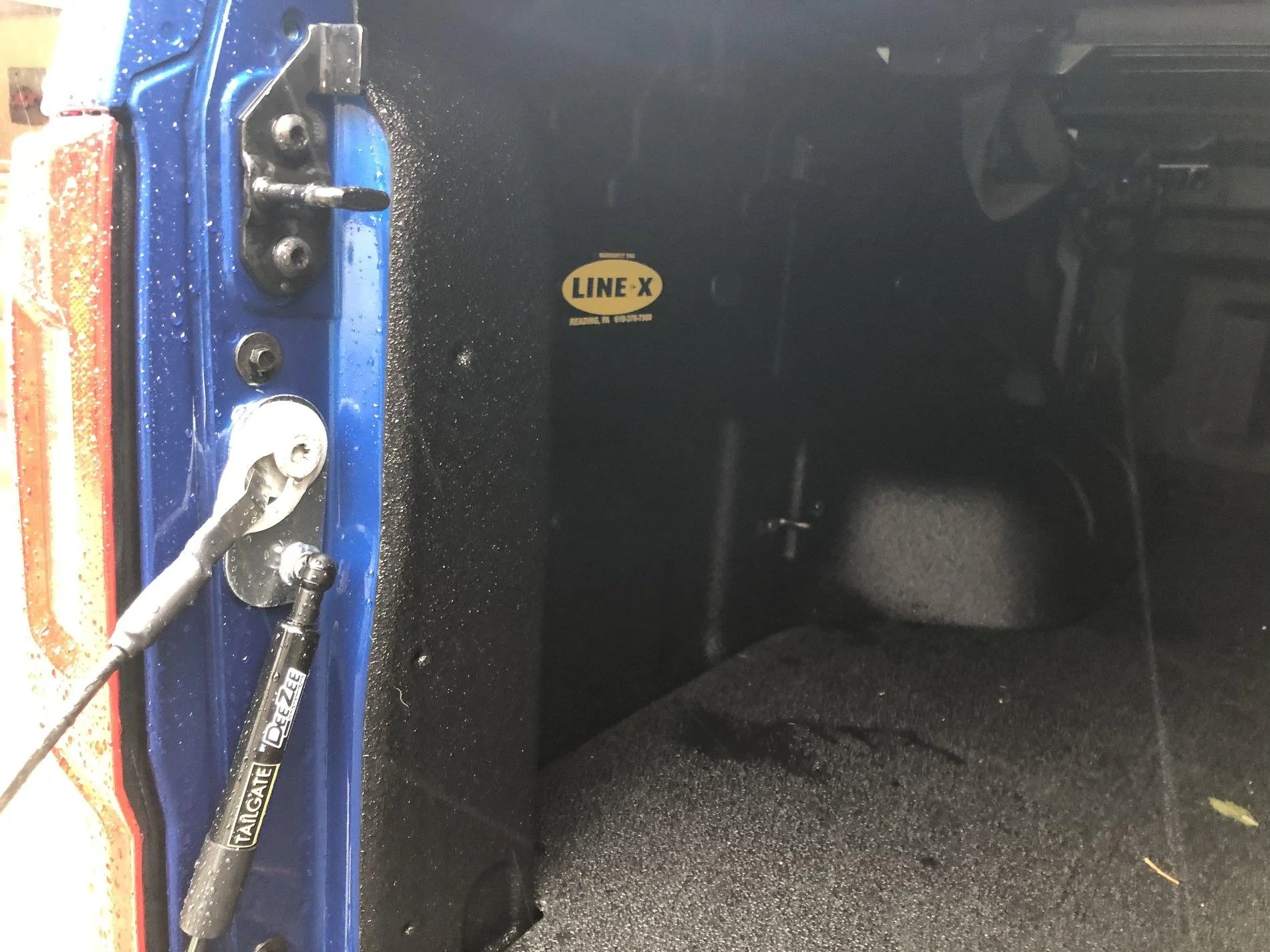

I’d appreciate it if the people with the MX4 would comment on where and how much water leakS nto the bed.
today, we have had a steady rain shower beginning about 9pm last night and continuing until now. It is a steady rain that when driving 35 mph through my neighborhood, the wipers need to be running without any pause to keep the window clear.
I drove about 6 miles chauffeuring my bride around local stores. Other than that, it has been parked in a level driveway, outdoors.
Below are the pictures of the bed after sitting in steady rain for 16 hours with the MX4 and the tailgate buttoned up.
Caveat, i needed to order a 7/8th drill bit. The two water tubes in the back are not installed yet as per spec. You will see them below and where the water is.
I’m not sure if I need to adjust or be concerned. This is my very first tonneau cover.
