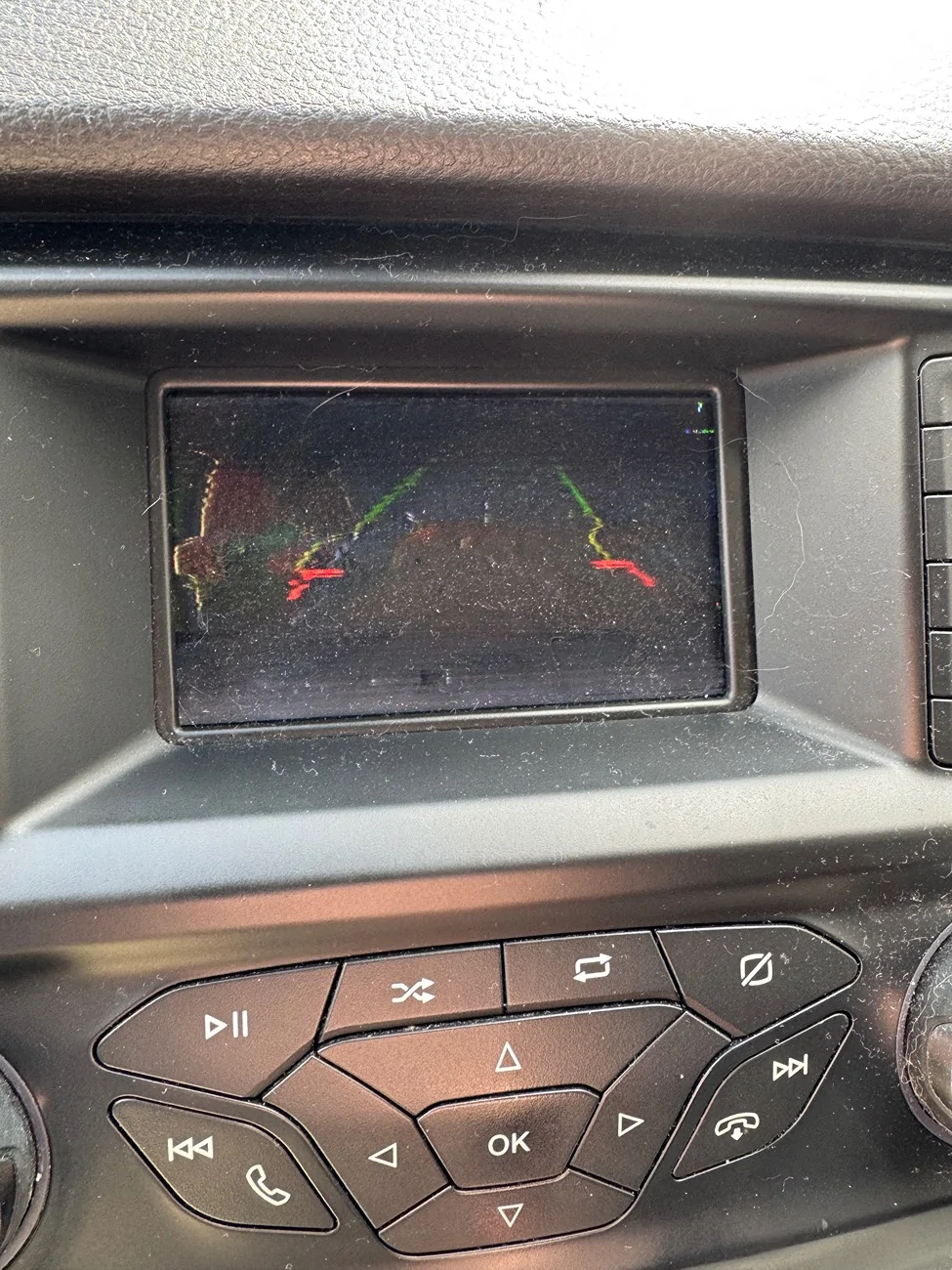

It shows a very distorted, dark image. It won't even show the green-to-red bars for how close you're backing up to something.

It’s actually a little clearer today
Okay so I think you have the same thing that is going on with mine. Whatever engineer designed the camera and wiring run from the tailgate into the vehicle did a very bad job. Basically the wires from the tailgate to under the bed pinch between the two pieces especially when below freezing. I have been thinking about cutting the plastic to help relieve the strain when the tailgate is closed. For me this started happening this winter. There is no rip in the plastic loom but they are getting so compressed it cuts the signal or distorts it.

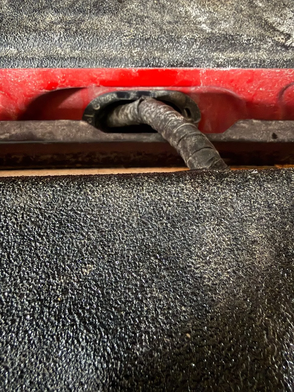

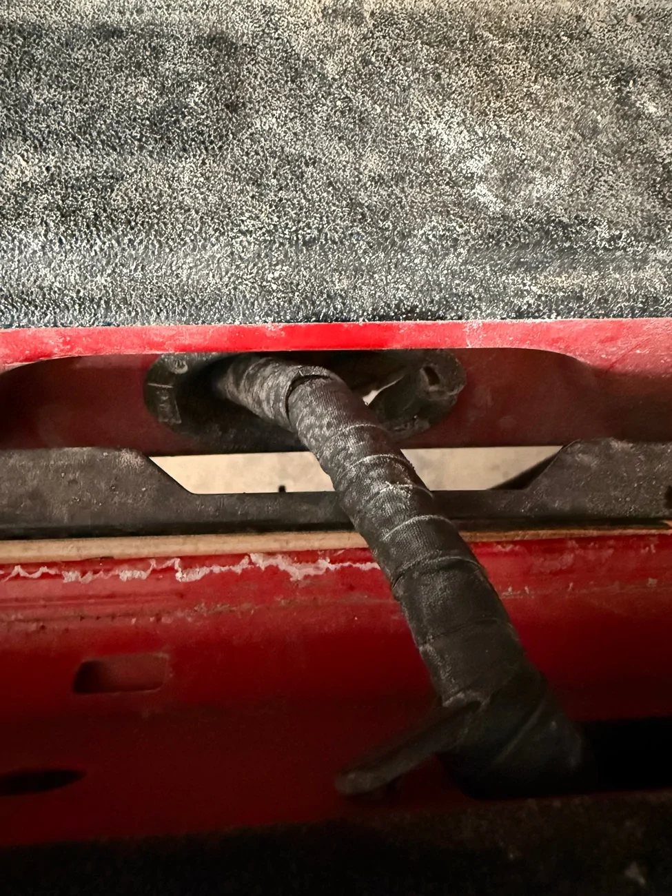

I have no idea why or how I disconnected that connector under the bed to check for corrosion and it doesn't fix the issue, but when I actually drop the tailgate and pull the wire back and forth, it fixes my issue. My issue also started with that freeze a couple of weeks ago when it dropped into the low 20s here in Houston (our normal cold winter is mid-high 40s).
Trustable
Jan 20, 2021
816
2,058
4Runner
I would inspect the loom in that area and maybe post some pics of it. I’d be willing to bet we have the same issue if it started when it got cold outside. I think I will end up having to splice the cable at some point from it being smashed so much. Along with the bad placement the material they used freezes up in the cold, just like the parking brake boot.
if you try to push the loom downward while closing the tailgate the camera image should be normal.

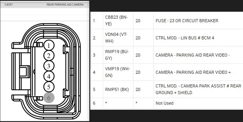

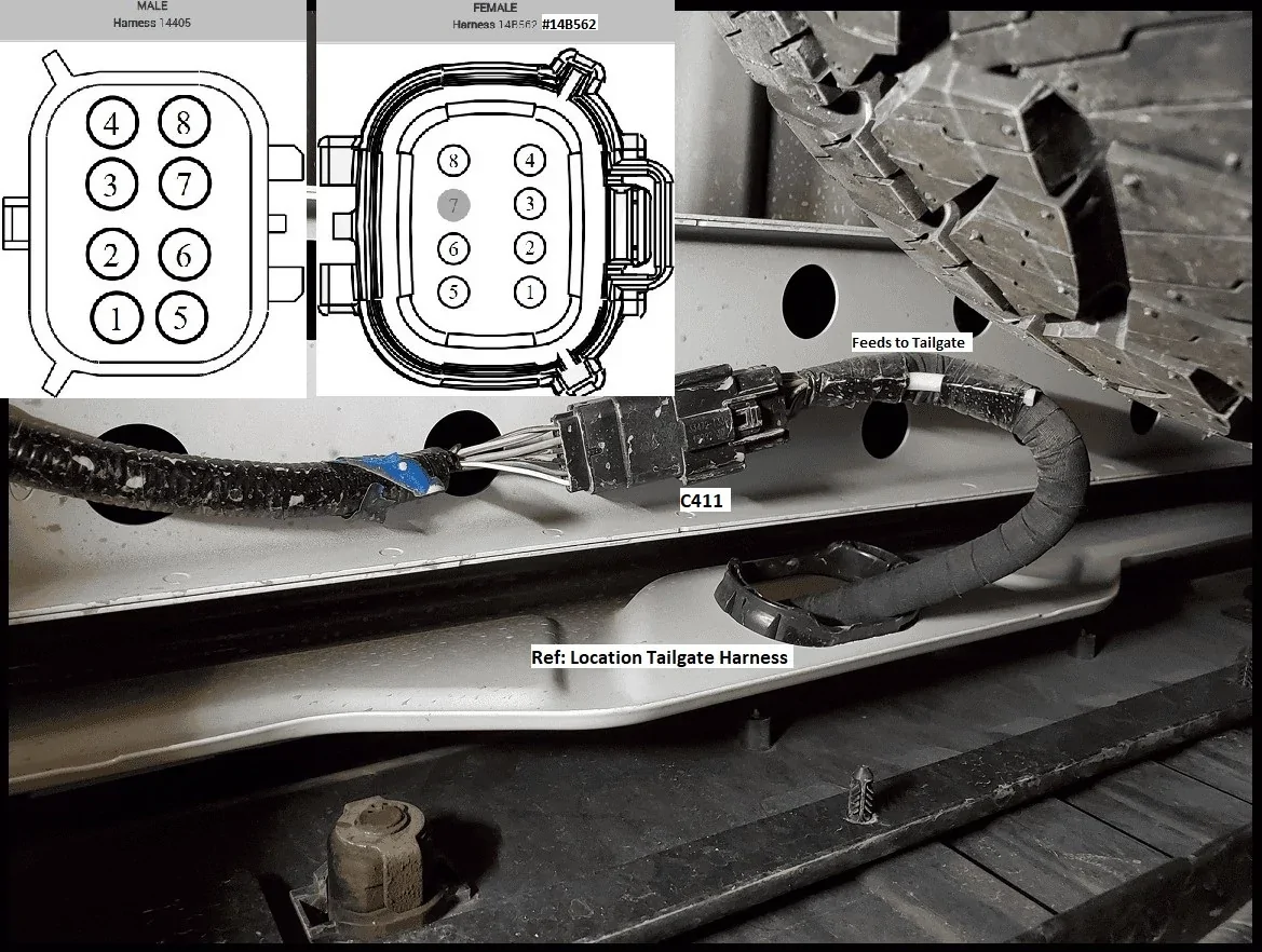

I will have to (build a pinout) pic for C411
But for rear camera only
C411 to C4357 =s C411 connector (pin numbers to the camera feed)
Pin 6 = Pin 1
Pin 4 = Pin 2
Pin 3 = Pin 3
Pin 2 = Pin 4
Pin 5 = Pin 5
You have 2 options
1. Repair Damaged Wire (Most likely on either video feed + or - or the ground (shielded)
2. Replace the (Tailgate Harness) - have to locate part number for Harness # 14B562
To repair - will need to (ohm) the harness for each pin and find the spot where they are touching
To understand - Pin 5 is the Ground for both the camera (power) and the (video feed) if you have ever dealt with home coax cable (this is the silver layer) on the cable - this is similar. something is interfering with the video feed and the shielded ground
At least you have isolated the issue - The harness
