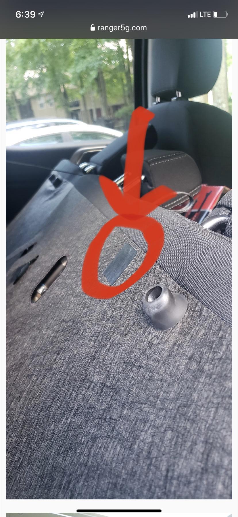

Mine had the same problem. There are several circular, rubber bumpers on the back of the seat. Just remove the one on the passenger side and you will be all set.
huh haven’t seen those. It worked somehow by lifting up the center head rest.

Sounds like you have it working. Here is a pic of what I was talking about in case you or others don’t want to mess with the headrest. The arrow points to the one that should be removed.

Good to know thanks!

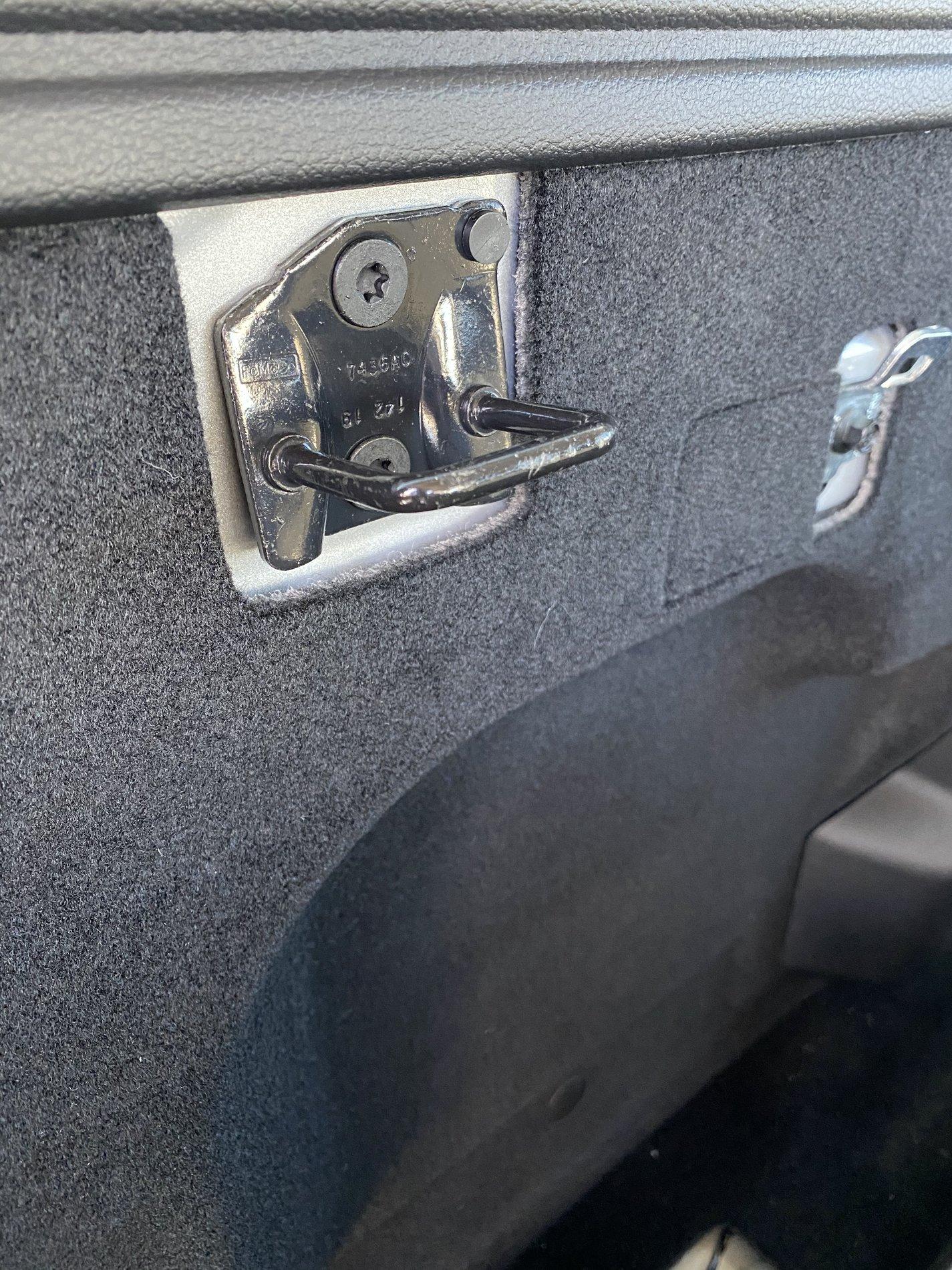

Like some people in the thread previously discussed, mine only has the three bumpers but still didn't want to close. Yeah I heard a thump from the seat back there every time I went over a bump.

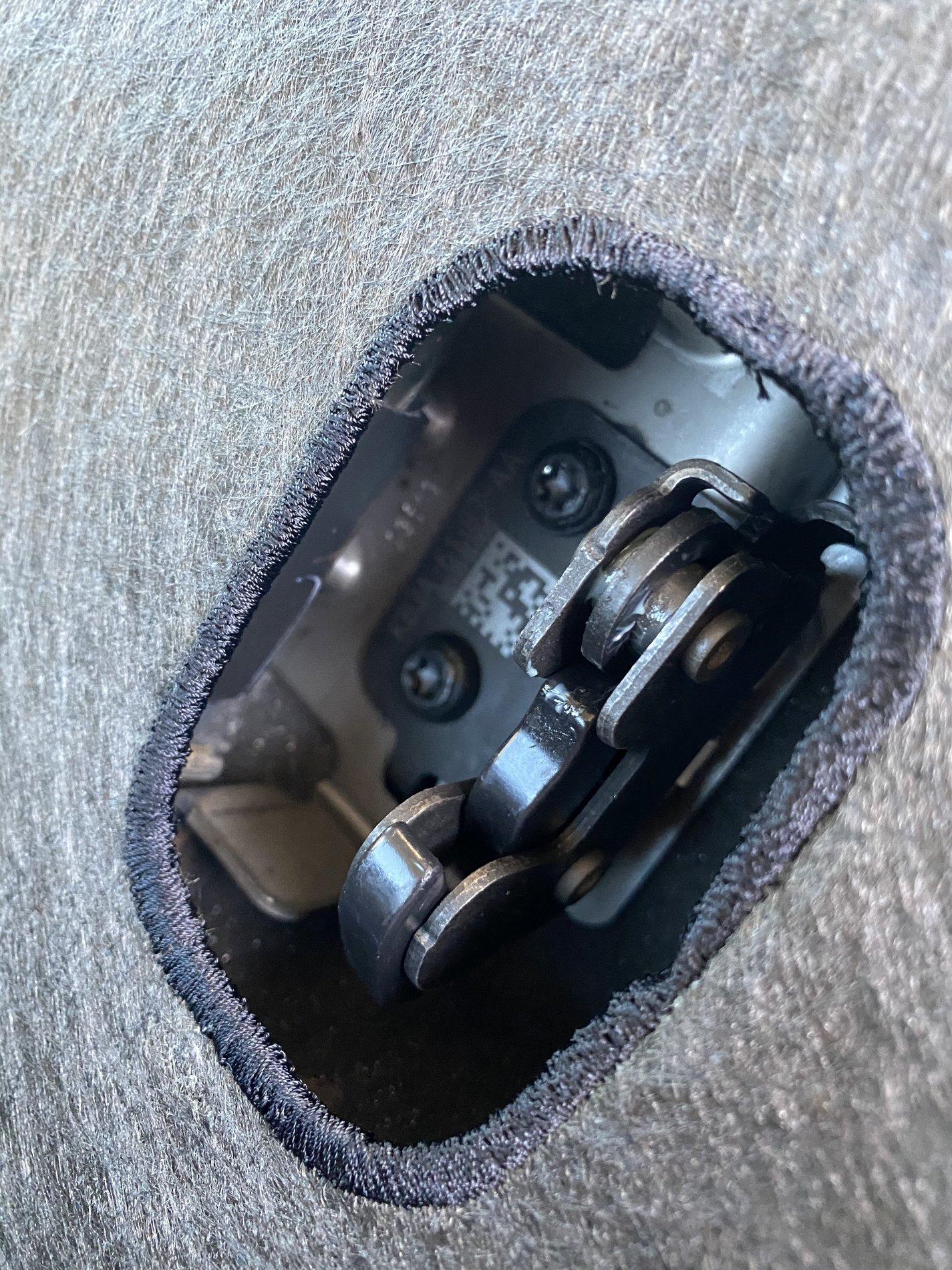

The first thing I did however was make sure the latch on the seat side was open and ready to accept a loop. Latches of that design can be closed, and slamming the hell out of them in the closed condition destroys them. You take a screwdriver, and "close" the seat on the screwdriver to make sure the latch is functioning correctly. Then open the latch with the strap and the screwdriver pops out.
Confirming function of the latch and alignment of the loop, I slammed the F out of it. :D The bumpers will compress over time and with use of the back seat. No worries.

Even with the rubber bumper removed near the latch it still will not latch. Place two washers behind your two studs coming off the back of the cab and it will correct the problem

If you just want to have an easier close before the rubber bumpers break in, (and that's all this is really, mine closes easier now) I'd sooner stay home and put two washers behind it. Never trust a dealer to repair something simple. There's a good chance they will just F it up worse or do something stupid like replace the latch (which is fine) then strip the mounting threads for that in the process and then cobble together a fix for that.
Some people don't see it... keep your truck away from the dealer whenever possible.
