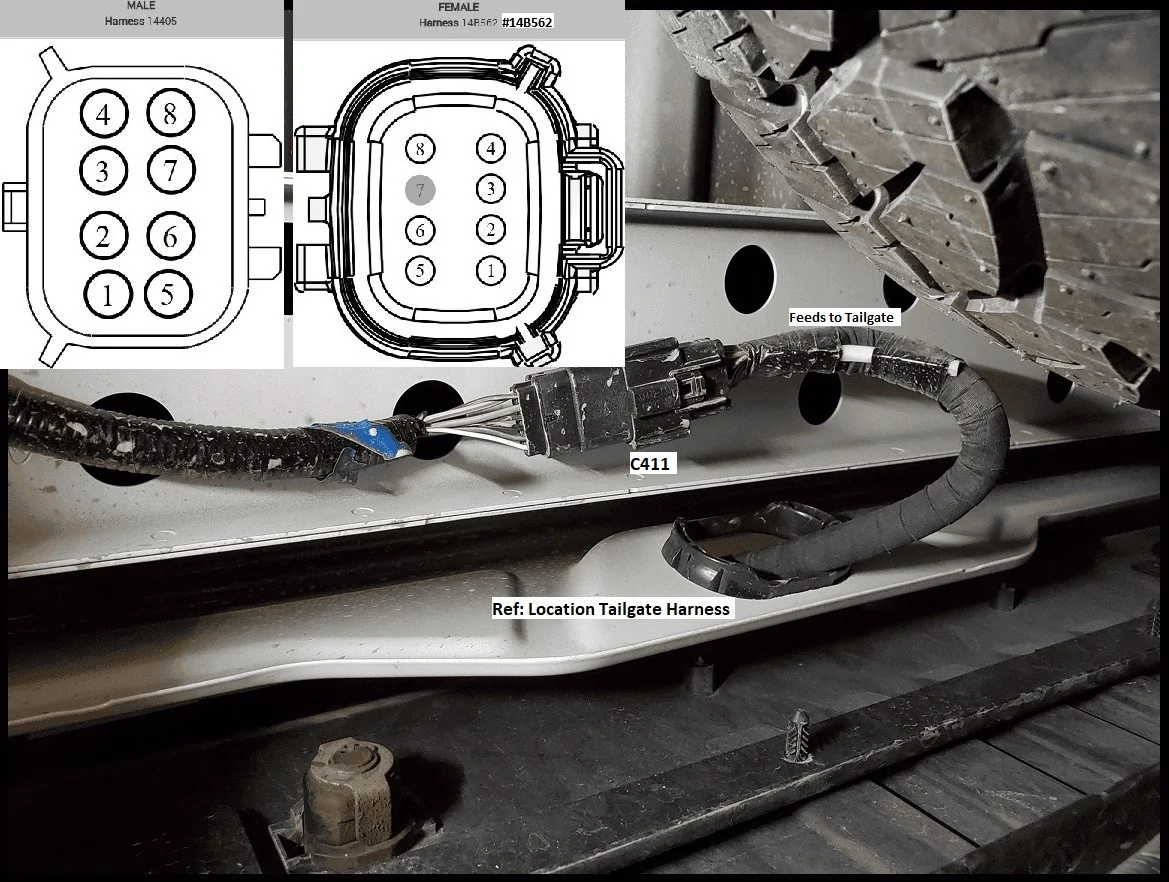

4 connectors to check for integrity - there are some others, but these are the external ones
1. The camera connector itself
2. The Tailgate Connector C411 - where it connects to the truck harness
3. C422 - Inline connector on the frame - Contains the (Video Feed)
4. C408 - Inline connector on the frame - Contains the (Camera Power Feed)
I highly suspect C422 as the issue
C411 Ref Location
C408 & C422 Ref Location
