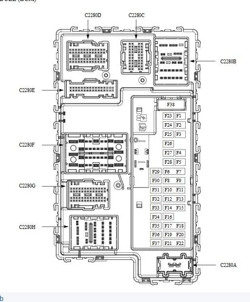

BCM: C2280D
Inline: C1147 - Drivers Side Footwell

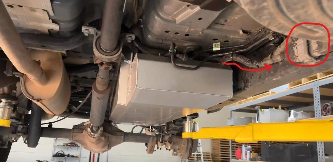

Inline: C408 - Along the Left Frame (Most -Aft Connector) this will be the most likely connector
