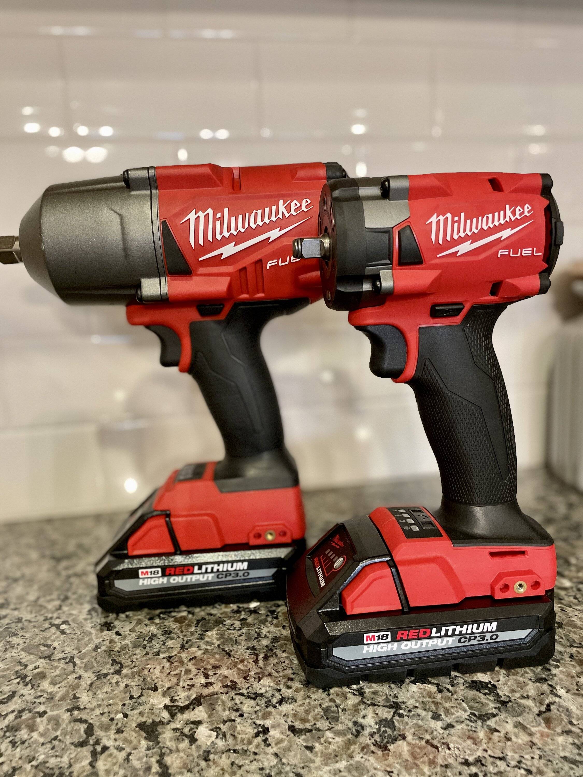

I have done three Rangers in the last couple of months and I am going to do one more axle nut removal next weekend. I use a half inch cordless Milwaukee impact which removes it like butter. Borrow a half inch impact from somebody, it will make your life 100% easier!!!!!

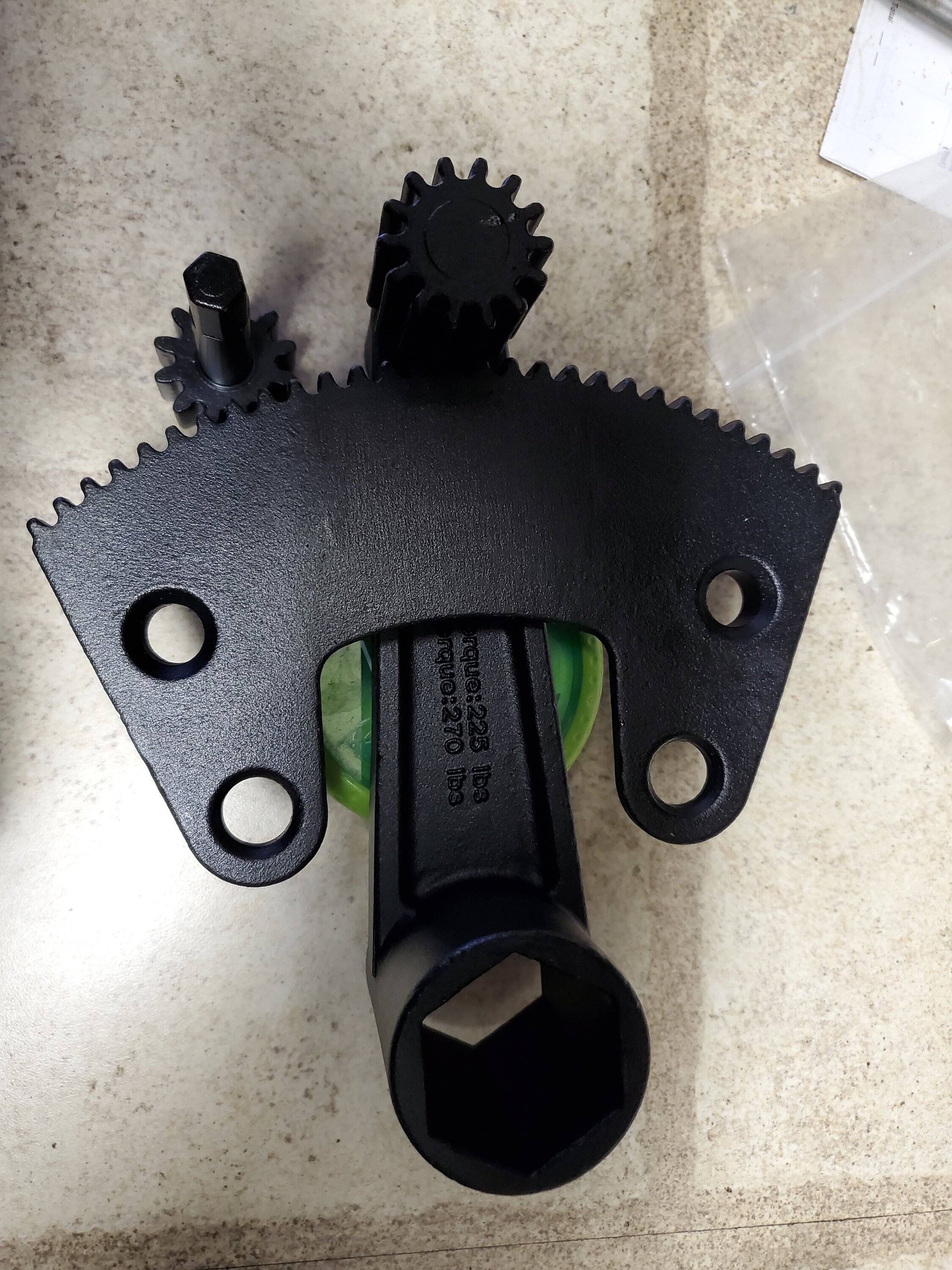

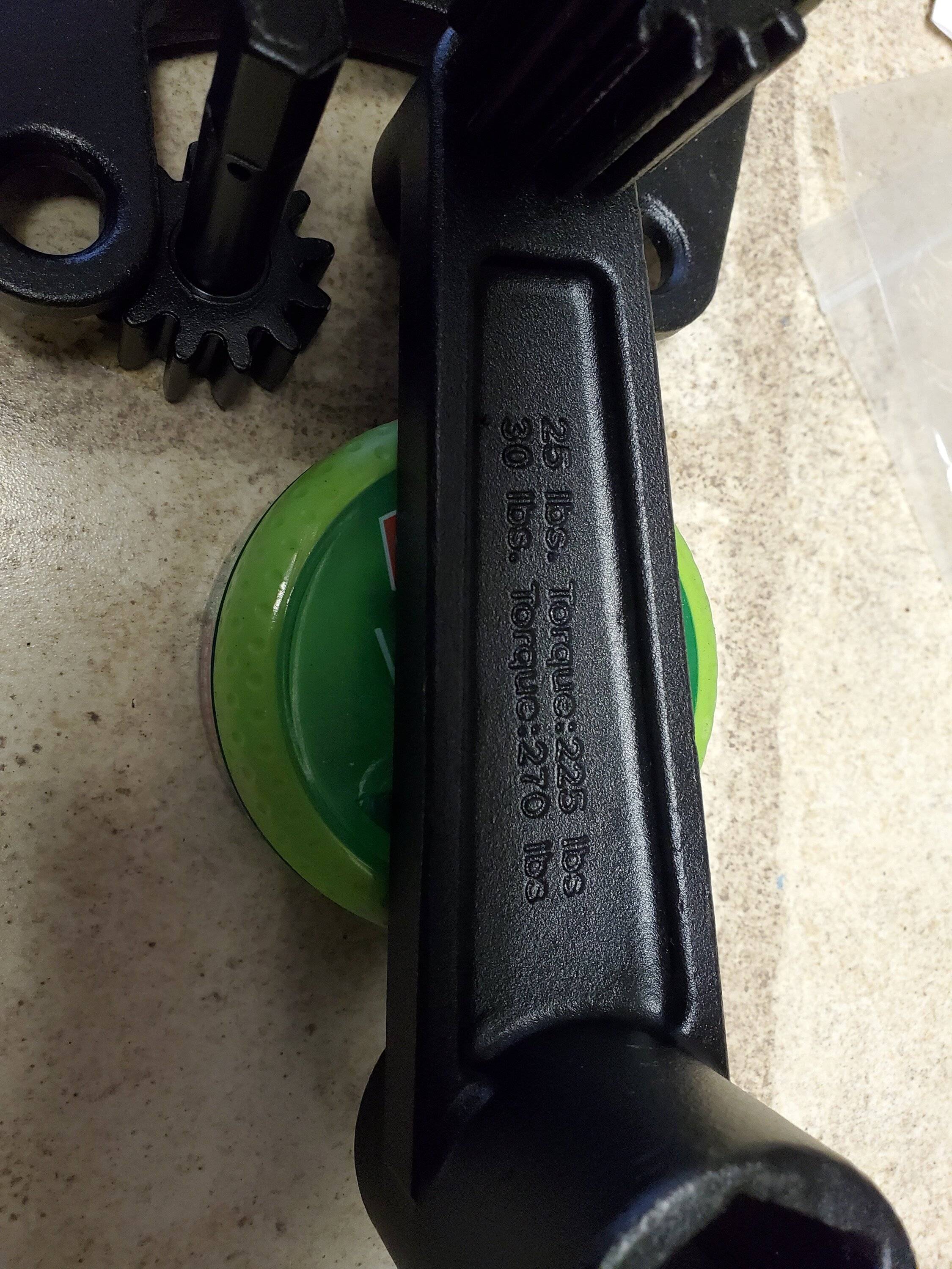

Here's a shot of a torque multiplier for my VW. Its setup for rear axle nut and flywheel nut. Even a damper guy can muster 25 or 30 ft lbs of torque.

As others have said get a Impact gun. Electric might work but air is best. When installing just use the impact again.
I don’t know man, the Milwaukee 18v Fuel 1/2” Impact is a beast. 1400lbs of take off torque.
That is with a Battery at 100% charge. Below that it goes down. In my line of work(Forklift Mechanic) I have times that Electric Impacts are the better way to go, but when I have Air Available I will use Air over Electric.
