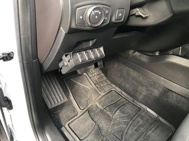

Couldn't really bring myself to spend hundreds on fancy lighted flat panel switch controls. Got this aluminum housing switch box on Amazon for $30.00 - self contained fuses with 40 amps on the entire circuit and 20 amps on each switch. All I had to do was add some relays.
Single power and single ground, then just 4 ACC lines. Setup rigged using a trigger fuse in the factory fuse box so it only gets juice when the vehicle is turned on.

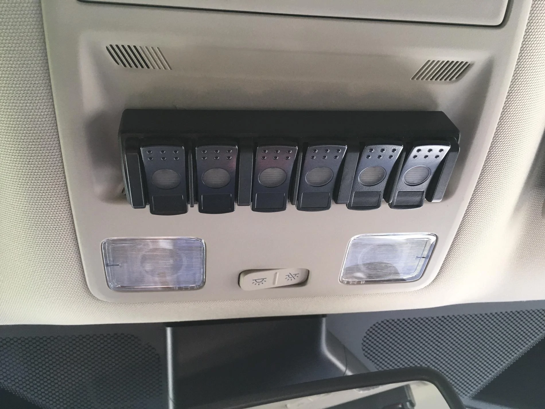

I'm happy with the LightForce switch fascia.
I am also. When I am done, it will have an rj45 pass through connector for remote mic to radio on back cab panel and two serious switches - 1 for flux capacitor and 1 for mini-guns ?

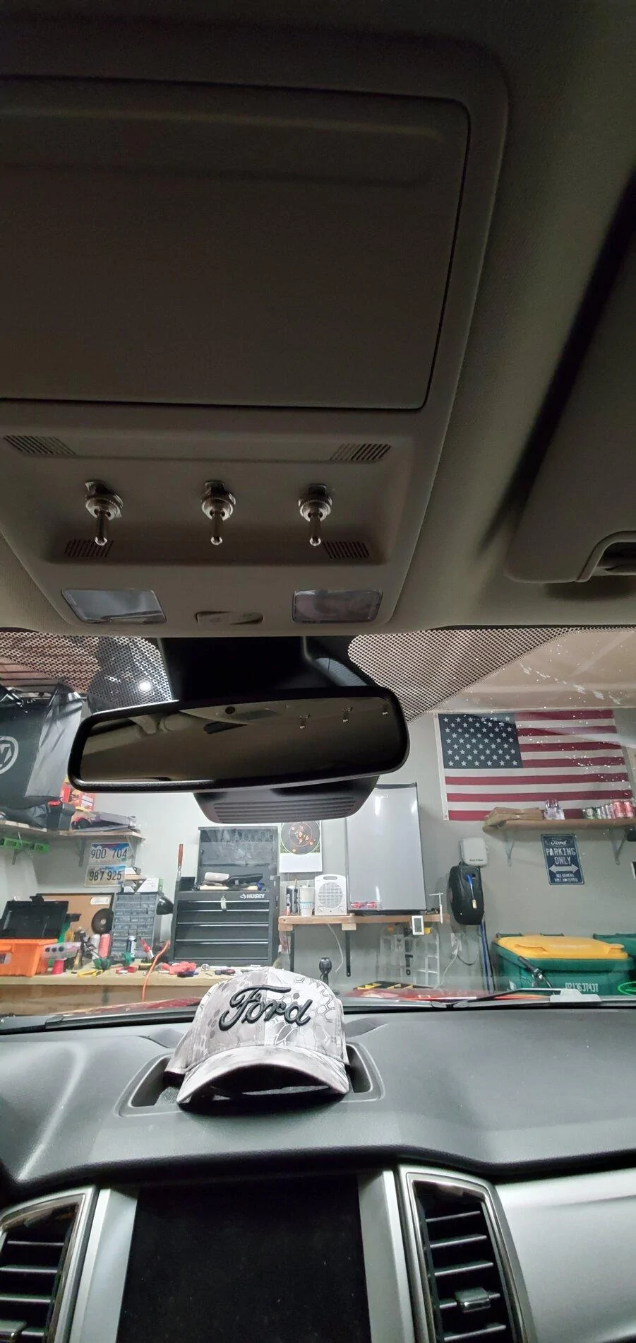

Definitely not fancy, but they are robust and get the job done. Run a couple of lights on the front.
Maybe not fancy, but probably the most subtle and discreet. I dig it.
I wanted to do something similar, but couldn't bring myself to mess with getting the wiring up there and drilling the two holes on a black section of interior you can't see made me cringe enough.
How did you run the wiring from front of truck to the center dash?
I really love how that looks! I am wanting to add a lower light bar and maybe some hood-mounted lights, but I am nervous to spend a good chunk of change and not be able to get the wiring done correctly. Never tried this before on a vehicle and hear the firewall is really tough to get through.
There is a large rubber boot/grommet on both the driver and passenger sides of the truck on the firewall. For the wiring for the lighting, I used a "wire insertion tool" (https://www.amazon.com/gp/product/B073WZCL8Q/ref=ppx_yo_dt_b_asin_title_o07_s01?ie=UTF8&psc=1) to get through the firewall boot/grommet on the driver side. from there it was pretty easy to run up under the dash to the light panel, and then back to the fuse box (driver side under the steering wheel) from the light panel for power using an "add-a-circuit" (https://www.amazon.com/gp/product/B07SR71LPP/ref=ppx_yo_dt_b_asin_title_o04_s00?ie=UTF8&psc=1).
To use the wire insertion tool, you push it through the rubber boot/grommet from the inside of the truck. This leaves the pointy end in the engine bay. You insert your wires through the pointy end, and then go back into the cab of your truck and finish pulling them through (they'll be poking out of the handle). Then you pull the tool out of the boot/grommet and off of the wire. It was pretty easy.

There is also an unused rubber grommet right under the driver side floor board all you have to do is cut through the sound deadening material and carpet backing material and then push the wire through and it pretty much comes up on its own where the gas and brake pedal are
