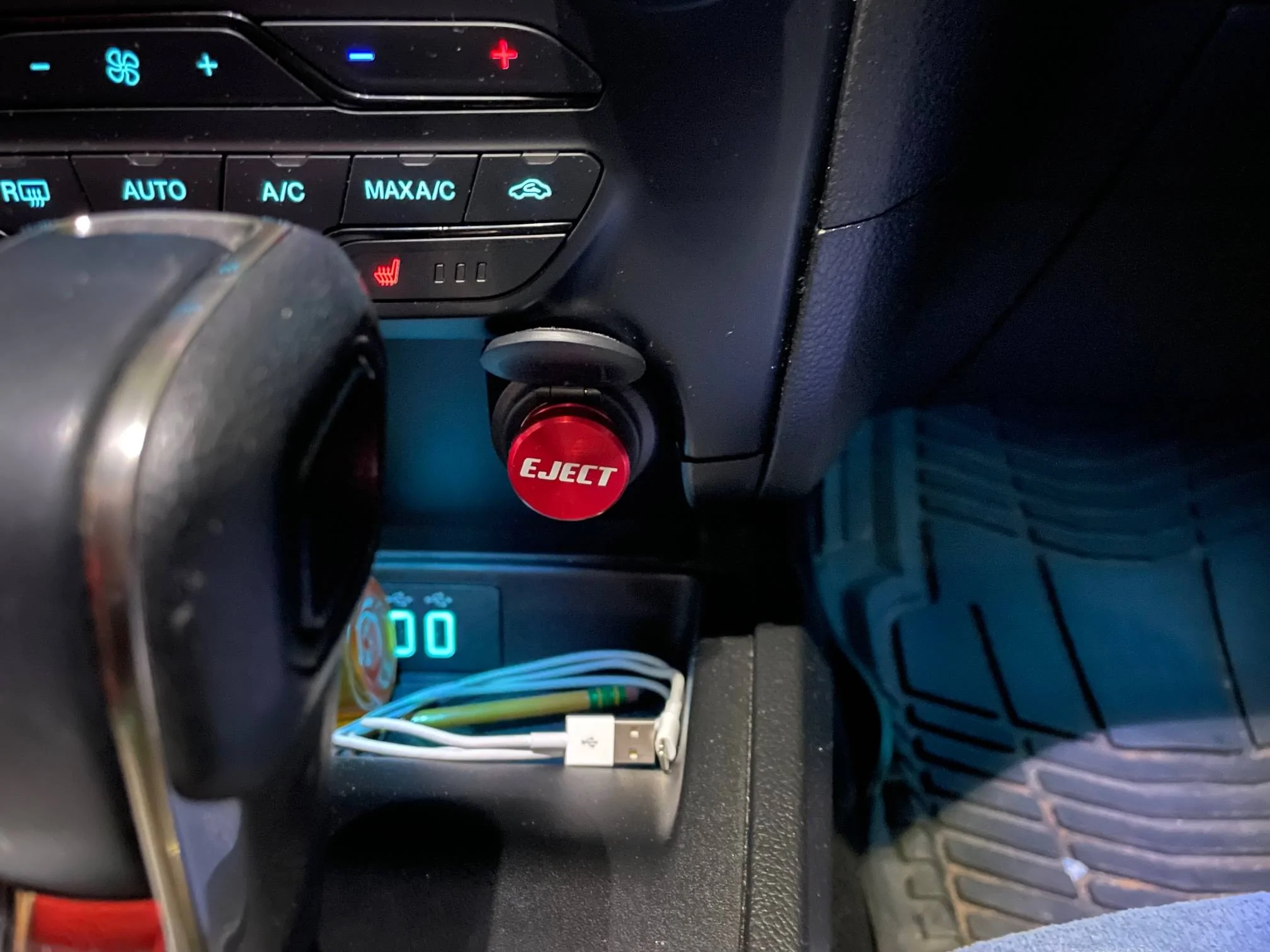

I put ditch lights and plan to add some area flood lights for around the bed.
Really though, I think the switches are poorly placed... I can't reach them while sitting in the seat, I have to lean forward to hit them.
It sounds silly until you're bouncing around or turning and trying to hit the switches...
The placement of the switches in the Colorado makes more sense - right where our 12 volt outlets are...
As always, YMMV
