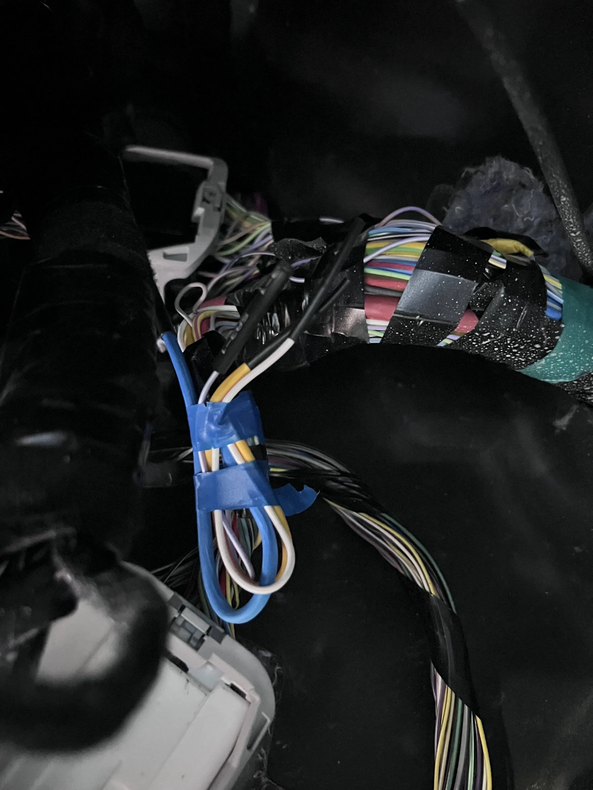

Have a 2022 ranger XL work truck and trying to install upfitters. Spotted 3 blunt end wires under the driver dash. Anyone tie into these and/or know what fuses they are wired to?

Are you talking about the factory wires left for the trailer brake controller?
not sure what they go to, but I have the tow package on my truck so I wouldn’t think it’s that’s.

Those are the wires for the brake controller. When you get the tow package Ford saw fit to not include the controller.

there is no wiring for the upfitter switches ......only if the swittches are installed from factory ......
