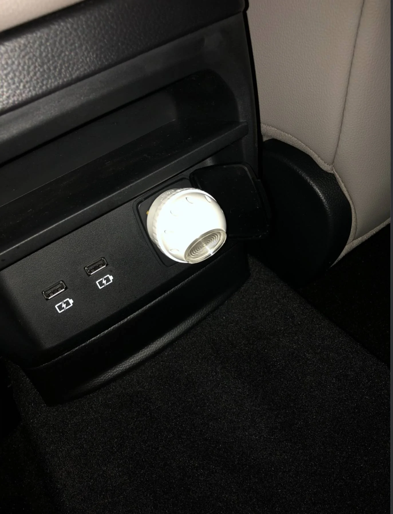

Here’s my A.S.S. disabler
I saw these on eBay but just wondering about the "on at dusk" sensor. Will it come on during the day or is it dark enough in the cabin to keep it on? If not where is the draw or will it only work at night? Looks like a cheap and easy remedy.
My understanding is that the outlet isn't always powered on. It's only on while the engine is running and then another 20 minutes or so after the truck is off. Someone please correct me if this isn't right.
I would think you'd have to black out the little sensor on it with some tape or paint. That way the light would think it's dark and always on and make the a.s.s. think there's a draw on it. You could also paint the lens black or use something to cover the light.
The question I got is why you can't find one in black so it would match the interior
