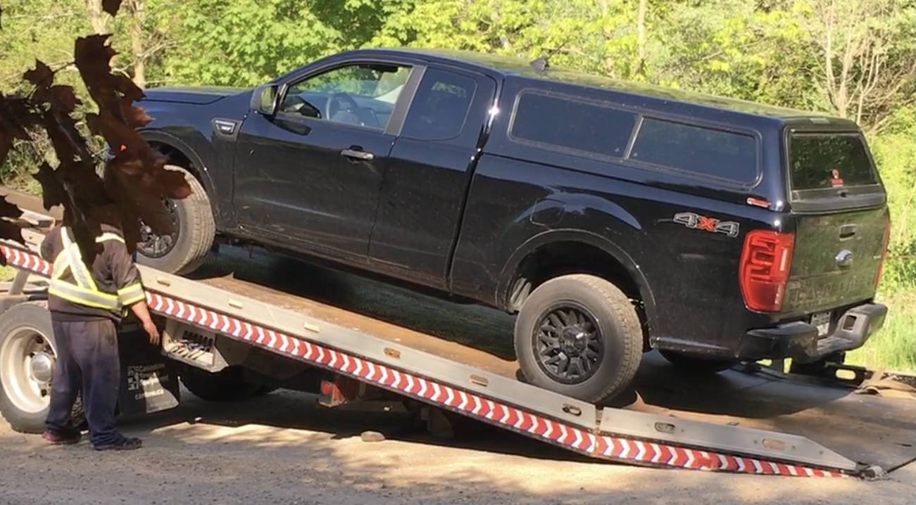

My Auto Stop/Start was hit and miss for a while - I read all the reasons for this to happen in the owner’s manual and figured it must be one or more of the simple things listed there.
It was about a year old at the time so how could it be the battery, right?
Then this happened…
Turns out it had a bad battery - replaced under warranty - haven’t had an issue since. I recommend that anyone having this issue get their battery load tested.
