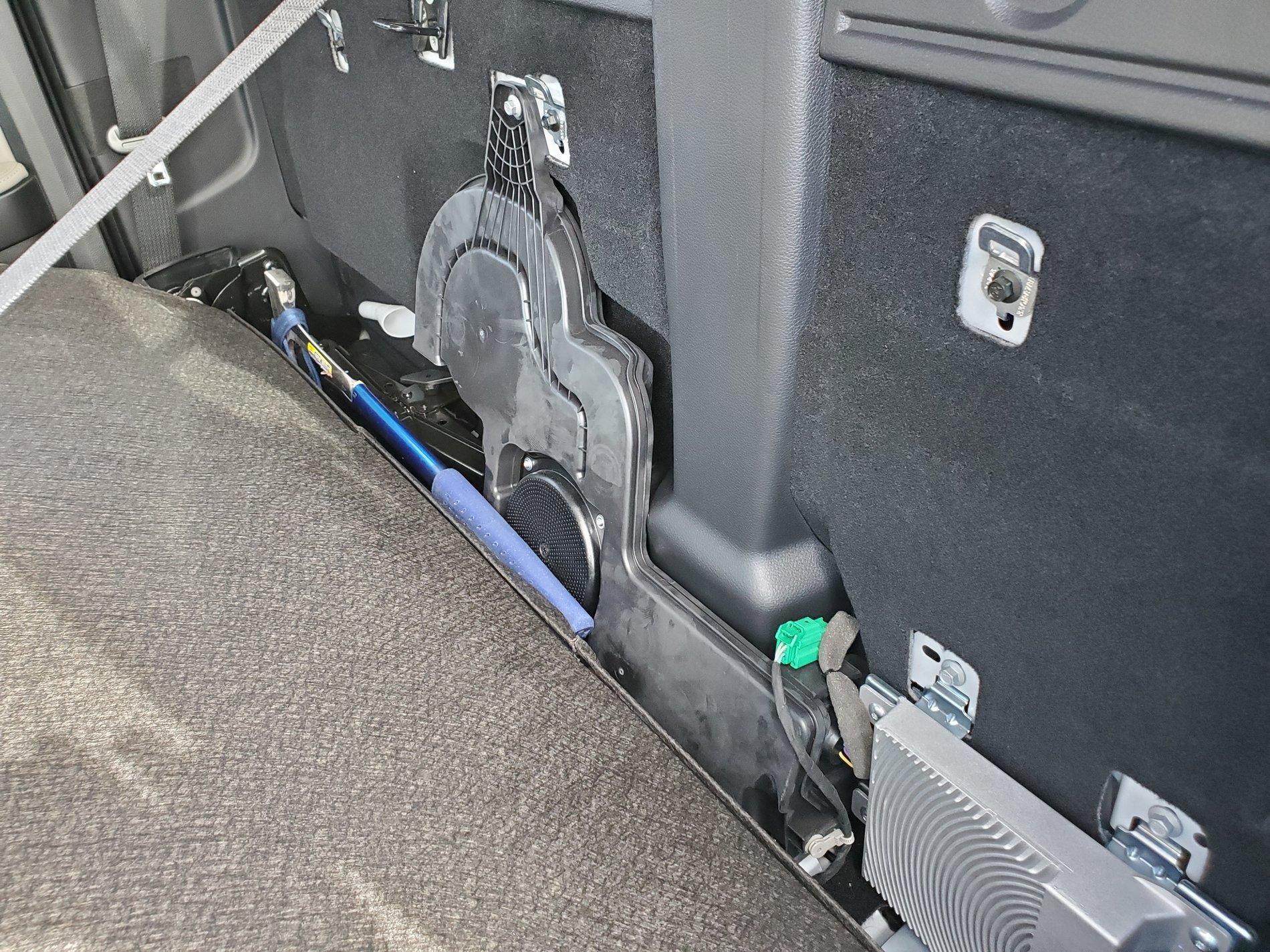

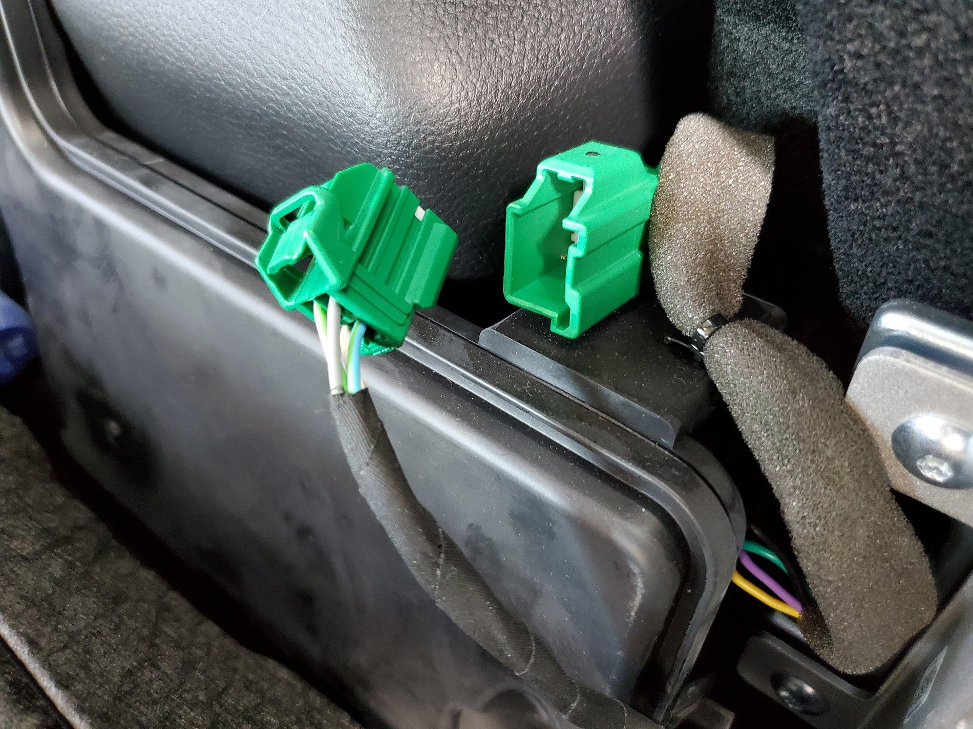

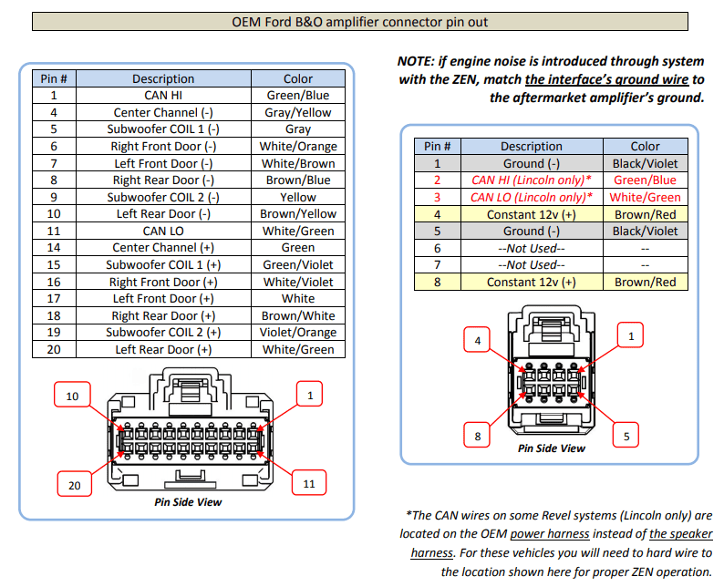

Here's a small collection of subs people have added and info I have found regarding the subwoofer replacement in the B&O system. From the sounds of it, one would not want to use the factory high-level signal to a new sub since it is heavily tuned by the sync/B&O system such as cutting bass for high volume. The approach looks like using the Zen2 and then RCA to a 5ch or 4ch + sub amps.
https://www.ranger5g.com/forum/threads/b-o-replacement-speaker-sizes.2697/
https://www.ranger5g.com/forum/threads/kicker-sub-upgrade.3659/
https://www.ranger5g.com/forum/threads/kicker-sub-upgrade.3659/#post-55411
https://www.ranger5g.com/forum/threads/kicker-sub-upgrade.3659/page-2#post-58355
