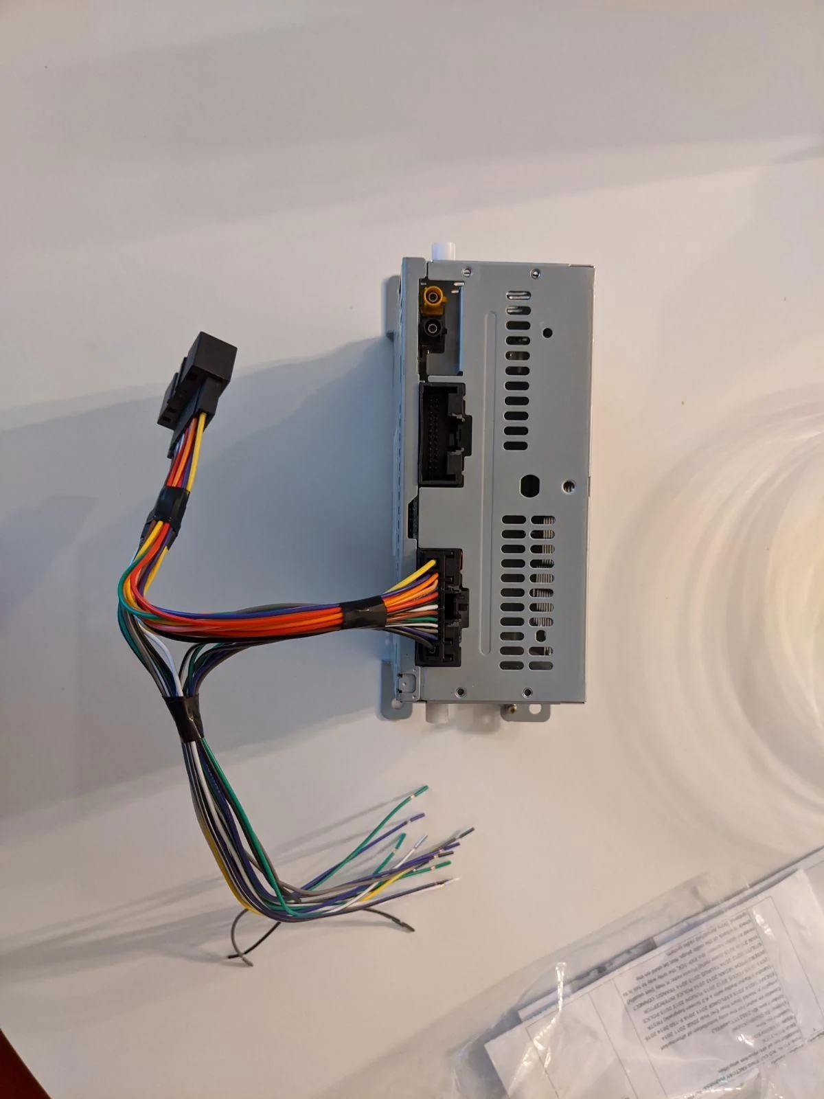

Update: Got an answer from Safewireless. They didn't know if the harness worked for the 2019+ Ranger. He said:
"The harness works with the 2019 F-150 non amplified radio, you will need to contact any Ford dealer parts department with your VIN# to confirm if the same radio is used in your Ranger. Returns are always okay."
Okay - I ordered up the Safewireless harness from Amazon. Hopefully I get it in time for the weekend so I can dig in and see if it fits.

Ed Venture
Ed
Jan 1, 2020
54
98
Austin, TX
2019 Ranger XLT
It fits!
