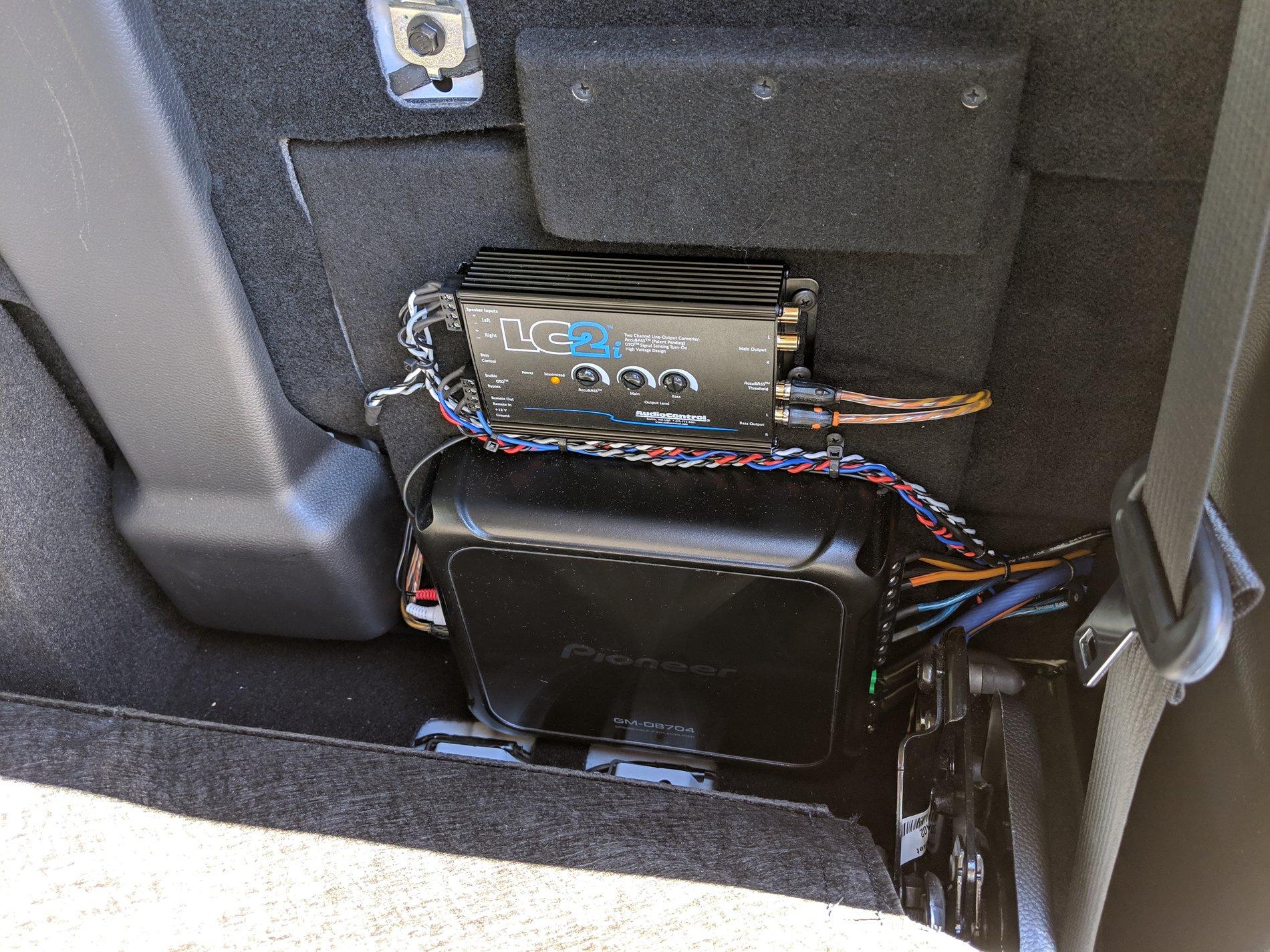

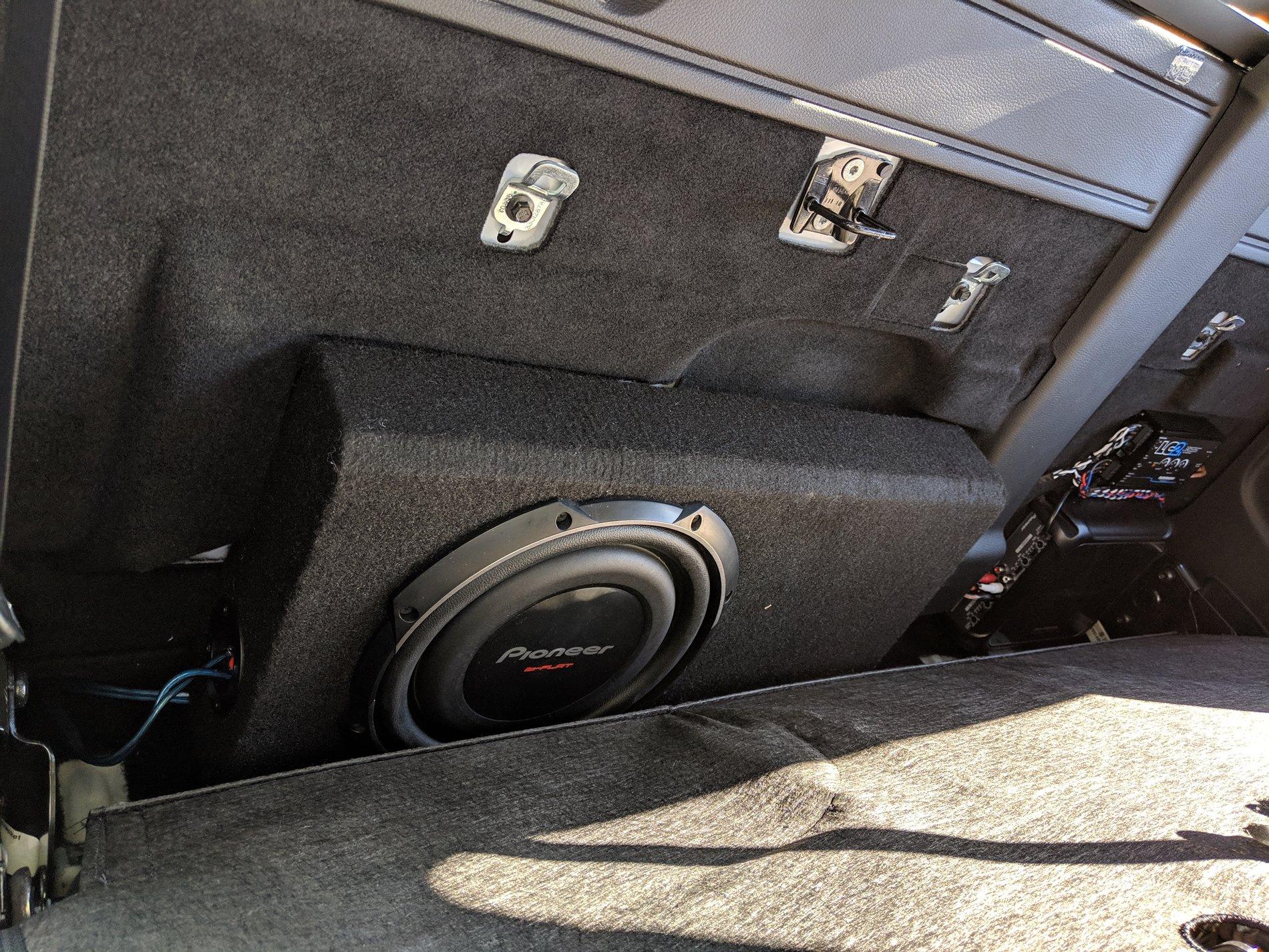

I specifically picked the above parts for the limited space. Pioneer made the thinnest prefab box and shallowest 10in subwoofer i could find. Still, a bit of carpeting that protruded behind the subbox needed to be cut out (where the cabin pressure relief is).
Shops wanted me to get one of those powered 8in sub kits that Alpine or Kicker make for under the seat, but I knew I would end up wanting more later, so I made the effort to get this 300w 10in put in instead. It keeps up nicely with my 100w components up front.
Note: My install required an LCi2 to restore bass that the sync3 stereo removes at higher volumes. Dont know if the B&O setup does the same.

What is this under neath?

Yeah this is all behind the back seat. Note that the subwoofer sticks into the seat a bit and has left a mark, so I suggest adding some form of grill or spacer to keep the subwoofer surround from rubbing against the back seat (it can wear the rubber out). That is next on my to-do list.
