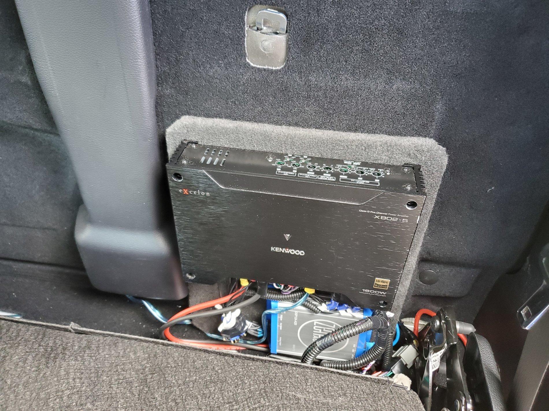

I am 98% sure that I have eliminated the enhanced engine noise via the NavTV Zen A2B and an aftermarket amp, removing the stock B&O amp!! I guess that's a secret unlockable feature on crew cab Lariats that other trims may not be able to do...

Hmmm... I could see the Zen unit being smart enough to take that out of the processing. Good to know for the B&O unit guys. Honestly, I don't think there's any truly good way to upgrade the B&O system without the Zen unit. Without that it's just an amp on top of an amp, making built in processing issues worse.

I am guessing the engine sound is a digital feed from the Sync module that would get summed at the head unit or the B&O amp. There's a chance that replacing either may do the trick. Has anyone with more basic Sync HU tried an HU replacement or upgrade?

For what it's worth, I noticed that my symposer sounds completely went away when I added a 4 channel speaker level input amp to my XL (4" screen). It also routed my chimes to the IPC speaker--which I didn't want.
I tapped the rear speakers for a powered subwoofer and there is no engine noise being routed to it.
Now, if I didn't add a 4 channel amp, I'm pretty sure the engine noise would still be routed to the speakers. I think it has something to do with the sync module not detecting the usual resistance from the speakers and assumes they aren't there.
This is an interesting comment. You may be on to something. Did you add a line out converter unit like an AudioControl LC4i? I have to wonder these units present a standard load to the speaker inputs.
In any case something I'm toying with is taking a signal off the rears both while leaving the rear speakers driving output and while having them disconnected. I'll both see if I enjoy the tonal balance and lack of rear fill with them gone, and also see if any enhanced engine sound is being reproduced.
HI Zaph, I used an Alpine 445u along with a parrot cable. The sub is a Rockville 8" powered underseat box connected before the alpine 445. I'm assuming if there was no alpine amp, the synooser sounds would have fine to the subs and annoyed the crap outta me
