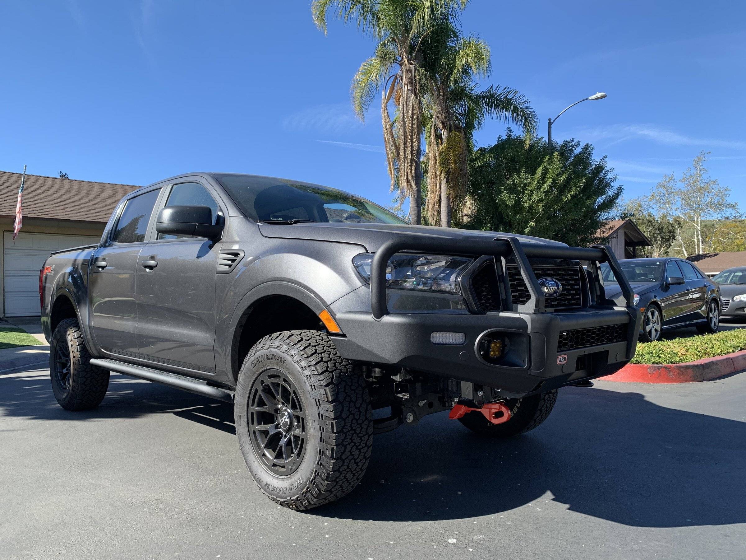

So I just finished installing the ARB bumper and Warn VR Evo 10s winch. I have Fox 2.5's. It looks great. I had to leave the control box in-place and not relocate it due to the short cables. I'm fine with that because I'll just stick with the wireless controller. An extra benefit is that now I have extra real-estate up top for lighting instead of the control box being in the way.

you know the rules. Pics or it didn’t happen!

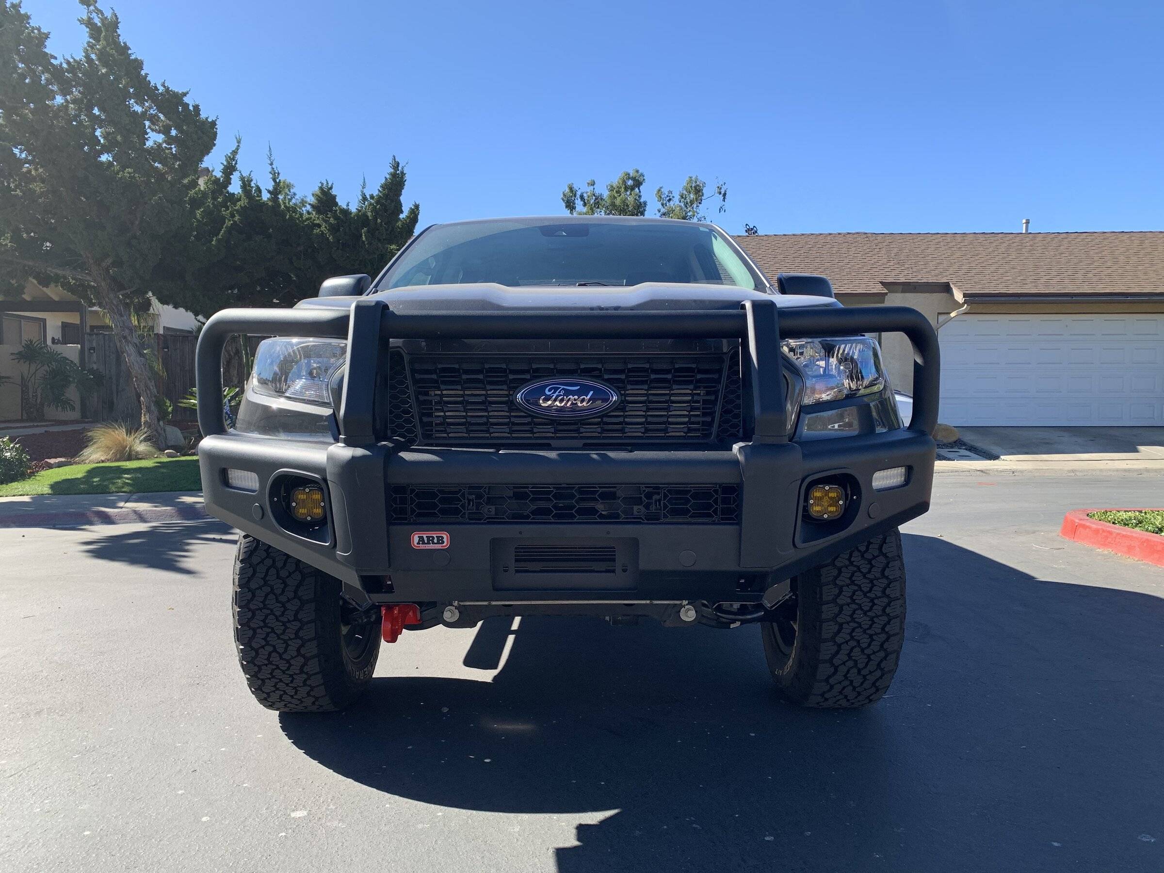

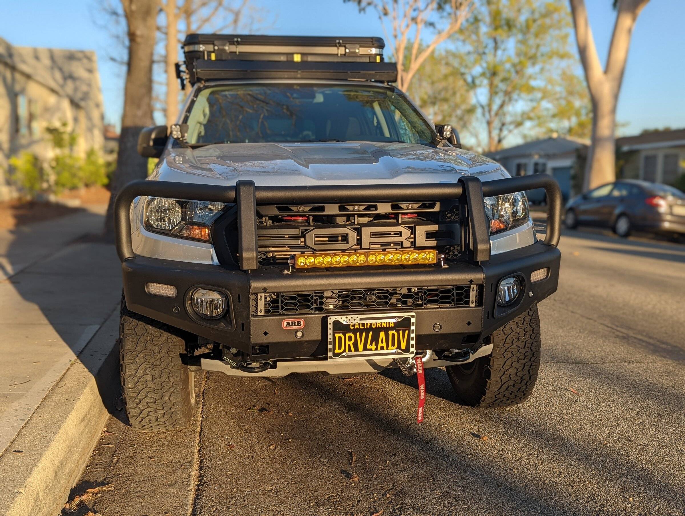

I also got through (most) of installing the Summit bull bar yesterday. Need to finish it up next weekend and install the ARB skid plates but LOVING the look of it all so far.

That one recovery hook is expensive!
I have a very important question for you. How did you fit your Baja Designs Fog lights in there? Did you make a special bracket. The ARB fog lights suck. I have the Baja's but could not figure out how to mount them. Heeeelllpppp!
