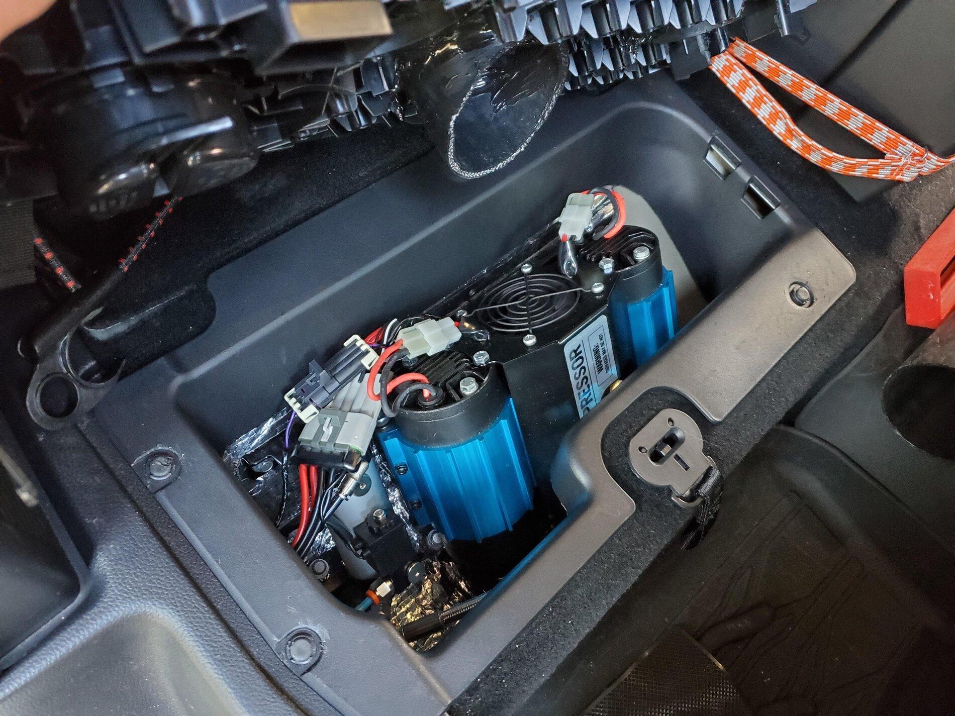

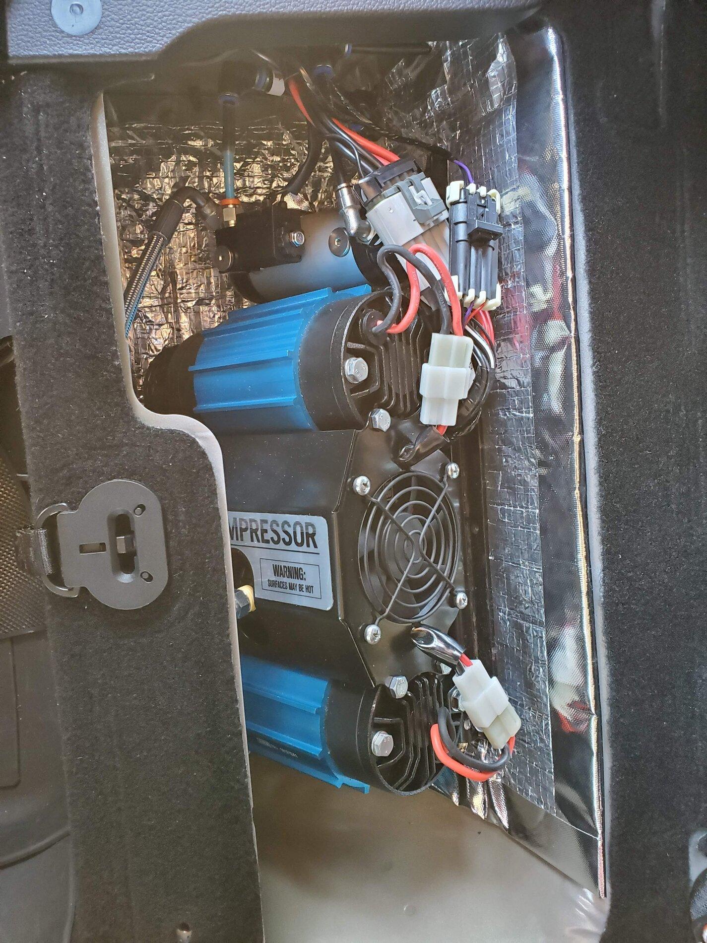

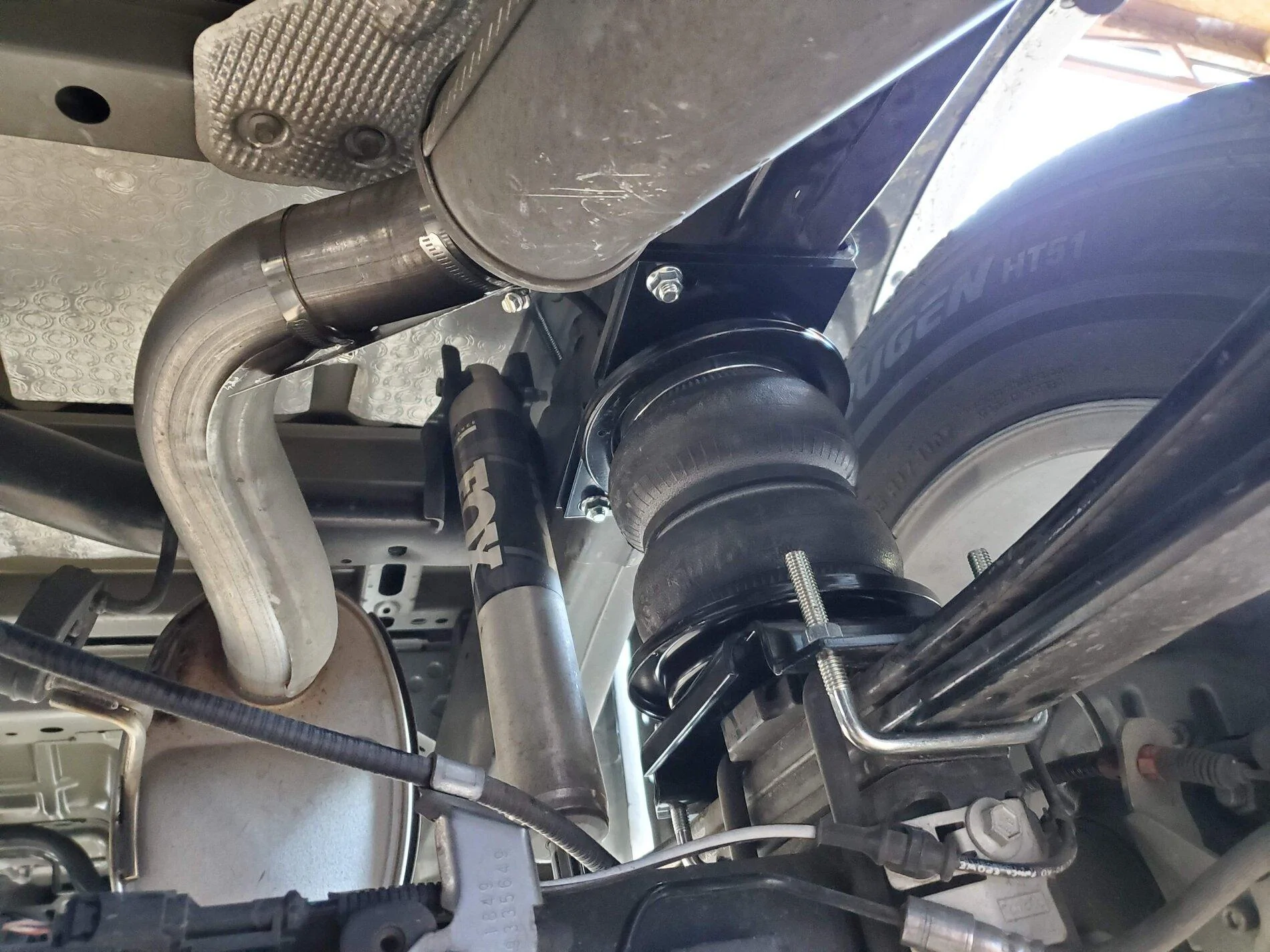

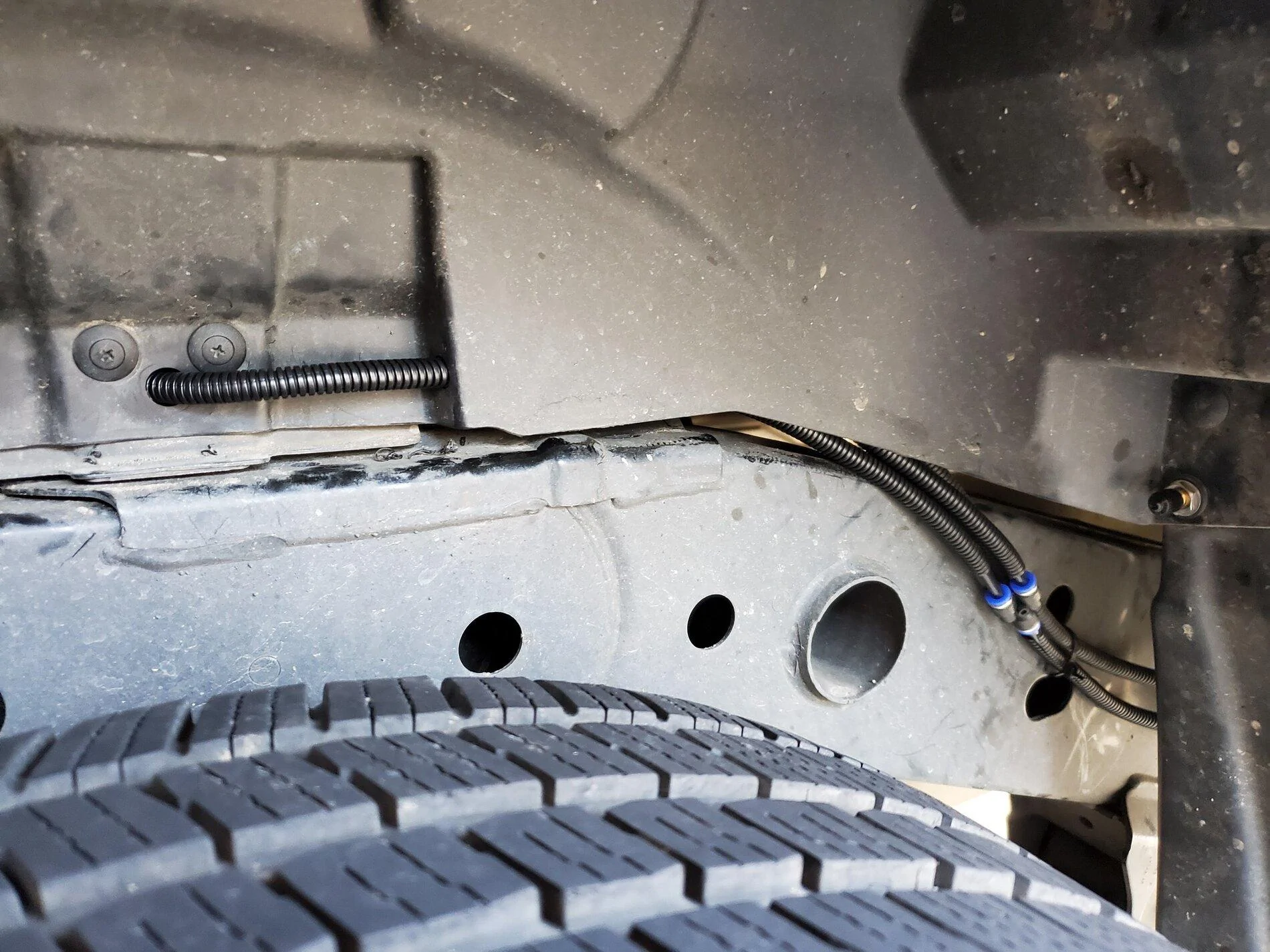

I installed the ARB duel compressor last winter, but forgot to post. This thing will pump up the airbags in a second or two, it'll pump up a tire pretty damn fast too. I would hate to imagine how many hours I have in this install, but this setup in VERY handy in my business.

That’s a great install! I have been thinking about a compressor and couldn’t decide in a location - that works really well. is it loud when it’s running?

It's loud, but not deafening because it's enclosed. It was a VERY tight fit and required a modified aftermarket mounting bracket to make it work. You may notice I lined the cavity with sound deadening material also.
