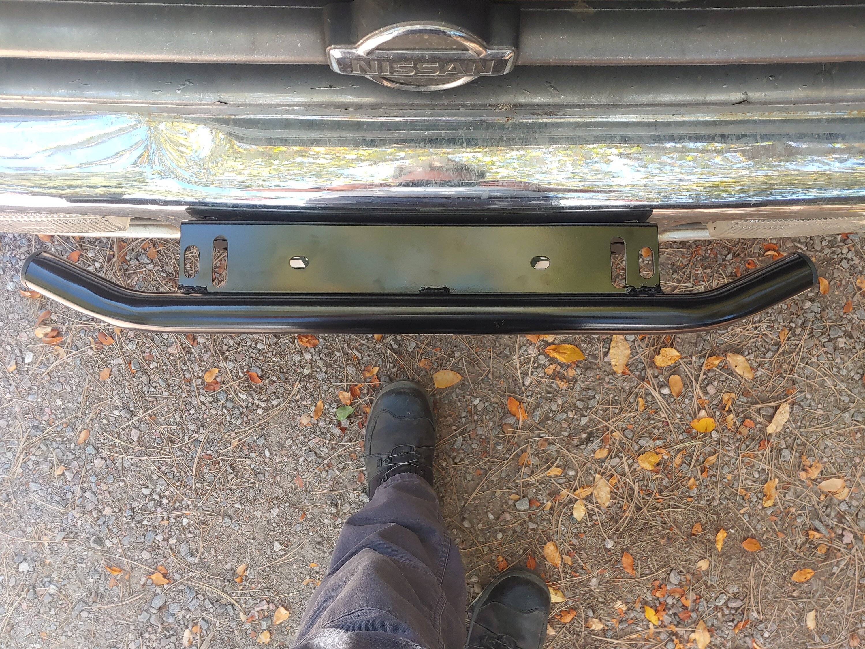

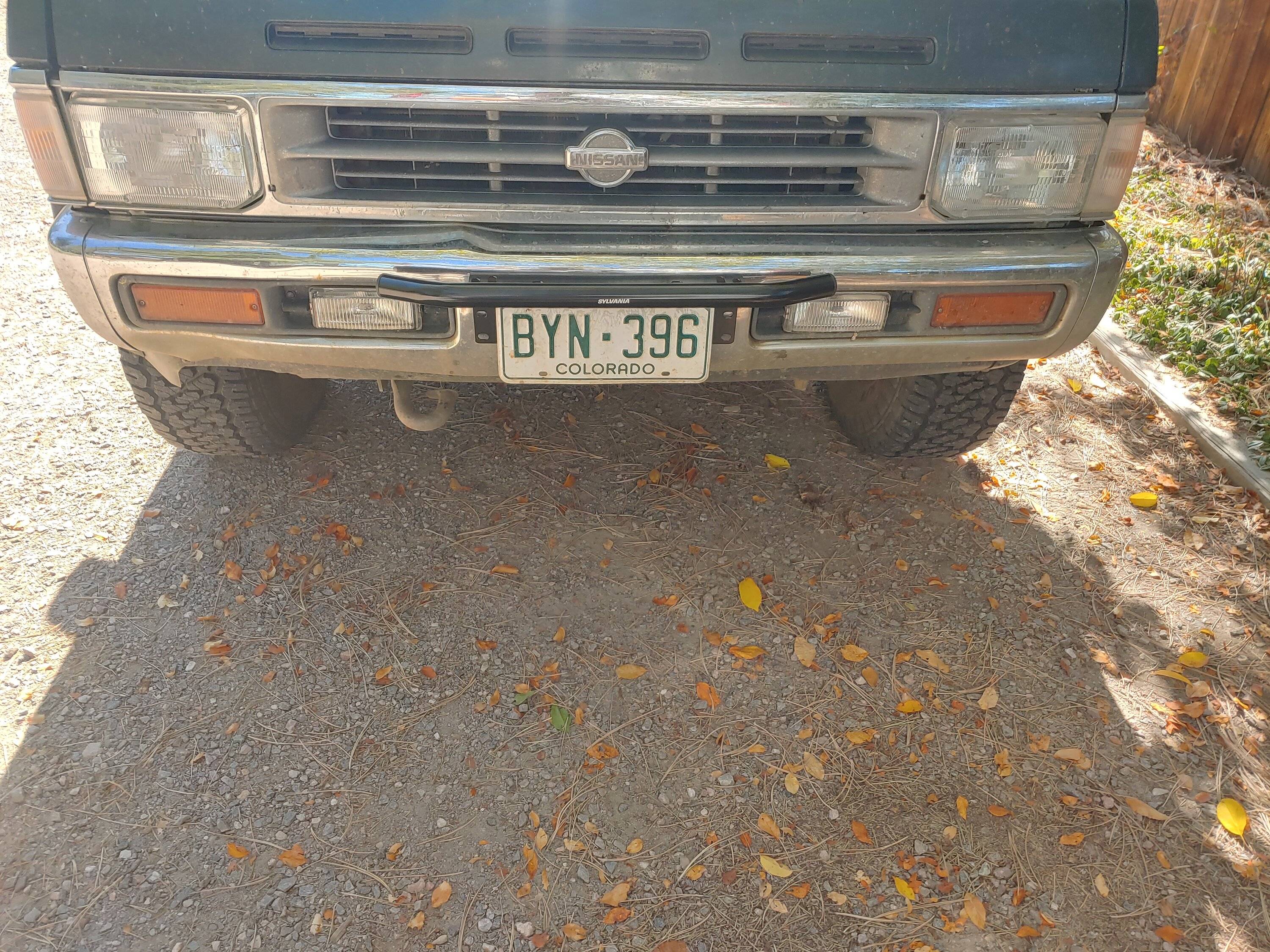

Do not mount lights or a bar to your license plate.
It is nowhere near stable enough.
I’m with you on that Doug.
I recently snapped my plate holder off with a hose. It is cheap, flimsy, brittle plastic with two small bolts and two clips.

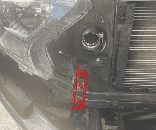

Those light bar brackets typically mount to the license plate holder (bad juju) - some bolt straight into holes in the front of the bumper (best) but our Rangers don’t have those holes, leaving folks to mount it to the plate holder. I’ve seen installation instructions that show it sandwiched between the plate and the bracket. ?
Add that steel plate, the bar, and some lights and I wouldn’t trust it to hold up at all. Then, of course, there’s dynamic load.
If anyone gets one of these, they better fab up something very tough that will allow them to mount it to the existing bumper holes or get out a good drill, a freshly charged battery, and some cutting oil.

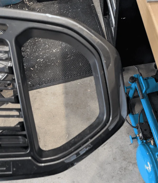

My presence on R5G is sporadic... Anywho, cut up an XLT grill:
Add aluminum angle and maybe some washers/spacers somewhere around here, cutting/clearancing shrouding as needed for the angle to pass through:
The specific lights I used are Lightforce Striker 170's and I had to buy additional Lightforce "low mounts" to get the fit I wanted.
I would not expect this arrangement to stand up at all to some use cases; I've actually been surprised it hasn't fallen off and maintains aim... Other approaches could be stouter.
