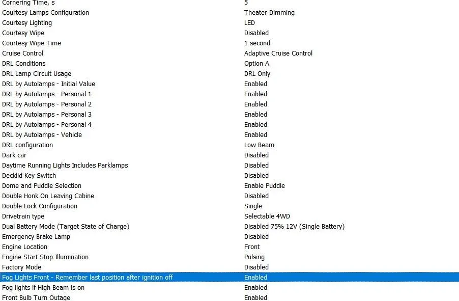

Not quite sure exactly what your question is, but in order to set your fog lights as DRLs, you need to make a couple changes in the BCM.
First, you must change the Allowed DRL Settings menu item to "All Options". This allows you to change what lights are used as DRLs.
Second, you must change the DRL Configuration menu option to "Fog Lamps".
Thirdly, if you want, you can change the Day Time Running Lights Includes Parking Lamps menu option to "Enable". This will include your front parking lamps, side markers and taillights with your DRLs. This is how mine is set up. I have switchbacks in my XLTs turn indicaters, so I have white parking lights and fog lights as my DRLs instead of my low beams.
Hope this answers your question. All this is done in the BCM configuration menu, no need to edit AsBuilt.
PS: This works on XLs and XLTs not sure with Lariat lights.
I just tried to set my fogs as DRL but got an invalid entry warning so it didnt stick. I did not see the BCM setting for All lights though. Triple checking but here is what my menu looks like. XLT Tremor if it matters.
I changed Low Beam to Fog. I also tried enabling the park lamps option then went back and switched to fogs but still had that error. In the image I set it back to stock basically.
I generally drive with DRL because of my halogens, fogs would be perfect though.
What is the menu option set to for the "Allowed DRL Options" item? It is in the beginning of the BCM menus. It needs to be set to "All Options". Otherwise Low Beams is the only selection it will accept.
Man, thanks. I swear I looked up and down in that area but you literally were right. Was like the 3rd thing listed. That allowed me to retain the fog light setting. That should be added to the Forscan wiki page. Gonna link your post.
