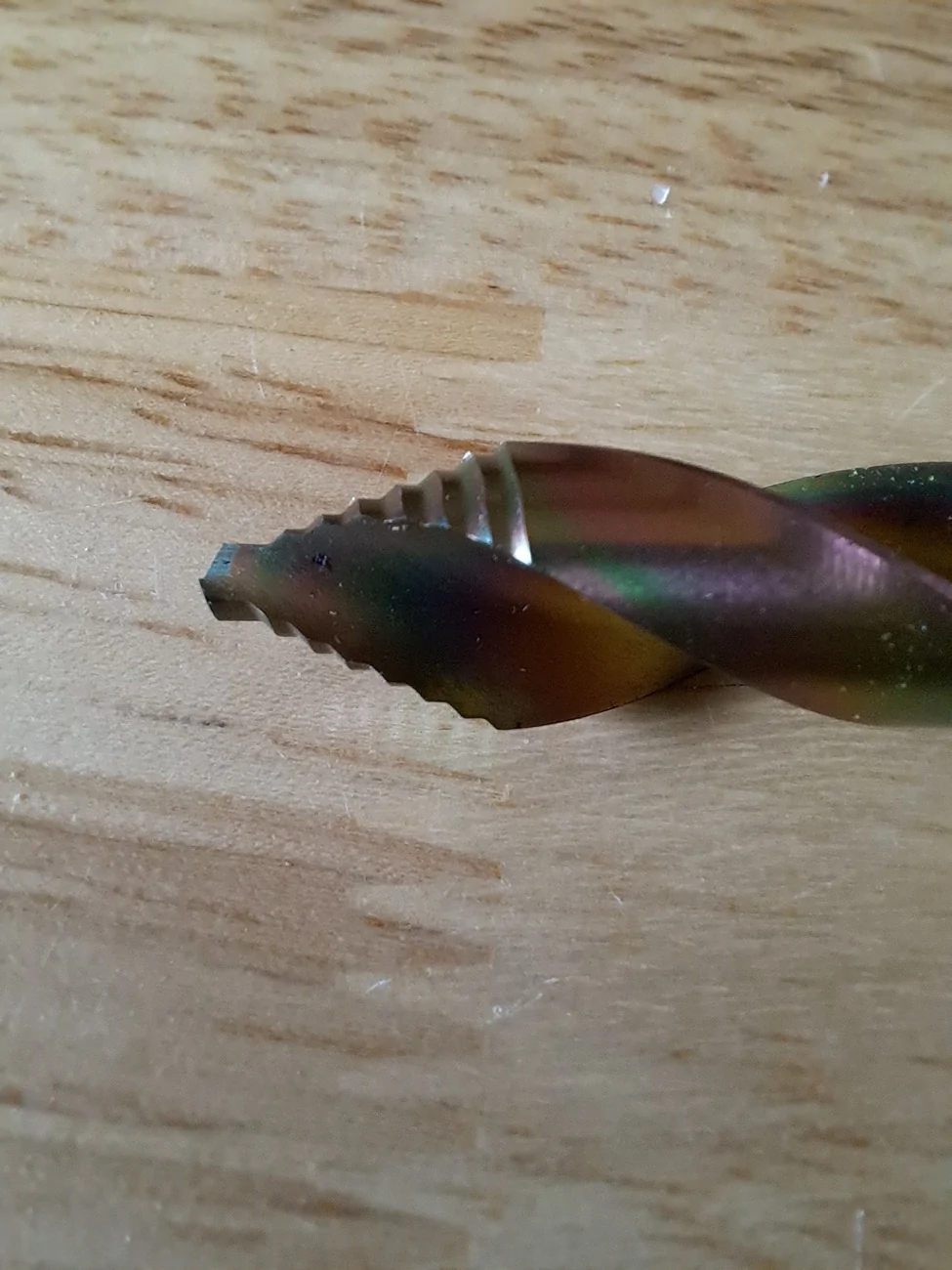

I have used well nuts in thin steel successfully. They're an expanding rubber rivnut that eliminates vibration. Also have a set of tiny step drills for thin steel that don't catch.

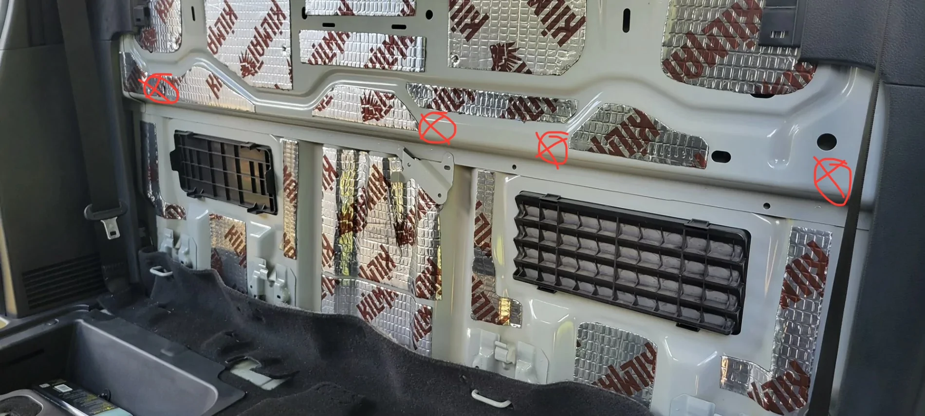

No but if I was going to, this is where I’d drill.
That's exactly where I was thinking for the top. Hopefully the bottom has the raised sections in the right spost for drilling as well, they're kinda random lol.

I'd use those loops (circled in green) to secure the bottom. Cut a piece of fuel line hose to length of the metal loop ( the ID of the hose the same size as the steel loop), Slice it lengthwise and wrap it around the metal loop. It protect and secure you panel and the loops, and minimize vibration rattles. What ever fastener you use will bite into the hose securing the bottom of the panel.

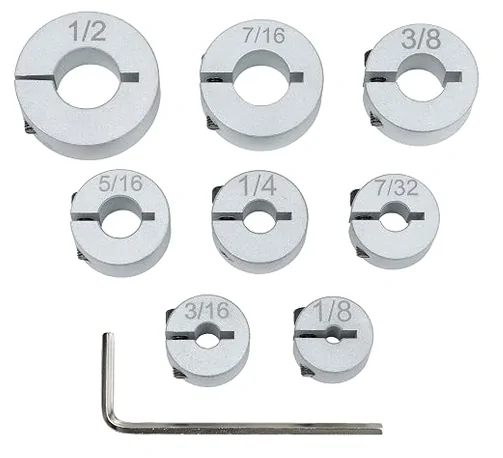

And I'd also use a drill bit depth collar to insure I didn't drill through the back of the cab.
There are many designs, and the link above is an Amazon search result showing all the different styles. This is cheap insurance.

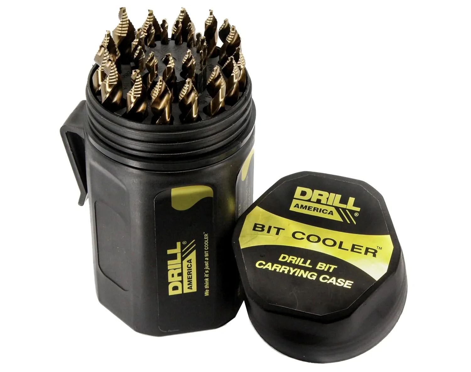

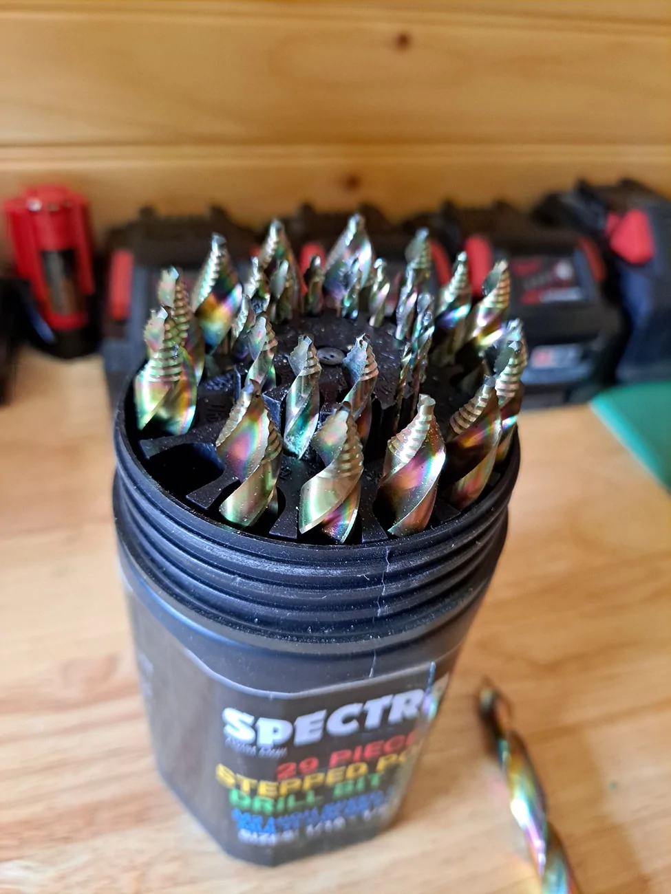

These are the actual drills that I use on thin metal to get accurate holes without pulling through at the end. Be careful because thin metal is tough to drill and work hardened from forming.
Just checked Amazon...:shock: pricey little buggers lol.
Get some L-brackets and anchor them to the floor. That’s what I would do.
You could always use L brackets for the bottom and anchor it straight to the floor. Might need to pull back or trim some of the carpet.
