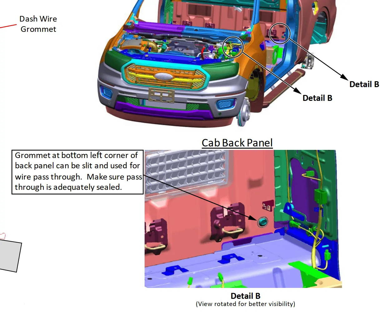

Tried to search for some info and couldn't really find anything for a double cab Ranger. I'm trying to find the best wiring route to go from the cab and into the bed for a WeBoost install. I did an install on my Maverick when I had it and it was cake, but the Lariat Tremor doesn't seem to have any noticeable passthrough spots. I can see that the bed has the passthroughs, but cant find the cab one. Anyone have any tips or suggestions?

Through the cab vent behind the rear seat...release the seat back and pull forward...the vent is slightly covered by the panel but if you put your hands into the cutout and up towards the right you'll feel the vents...you can then pass a fish wire through and catch it between the cab and bed...

That’s where I was thinking it was, but I think I was feeling down instead of up and to the right. I have the BO system, so the drivers side is covered with the amp and sub. Thanks for the confirmation!

where can I get more of those cad drawings? I'm also trying to figure where all the wires in the tremor aux switches run to and colors
That diagram is from the Ford's Body Builder Layout Book.
Proper wiring diagrams will show Tremor aux switches.
