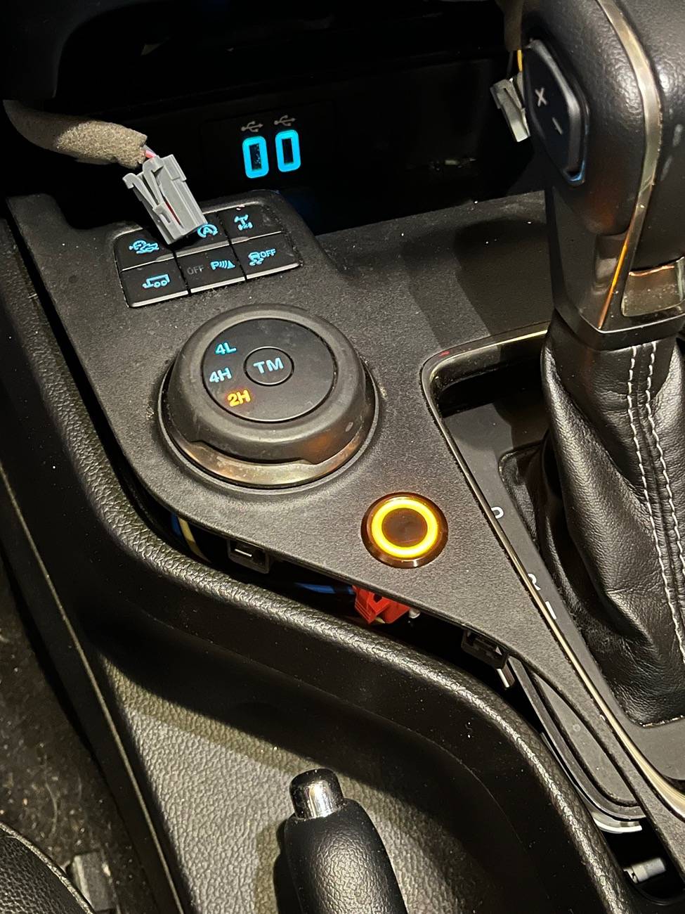

Oh, right. Pardon my slowness. I’ve installed a backlit button for an ooga horn, and it’s a bit bright at 100%. Here’s a photo of it:

Gotcha. We used to have an ooga horn on our lawn tractor when I was a kid. Shame that light can't be programmed to be a red backlight. Any chance of putting a dark smoke tint on it? Our Caprice police package had a dark out mode on the dash lights but Chevy forgot to kill that huge led speedometer light. We had a pc code card I used to stick over it. Some of the guys found a vinyl static tint cling to use.
With the placement of that button, had you considered just disconnecting the backlight function and press the button by feel in the dark? Muscle memory builds up quickly.

Thanks for your suggestions. I actually quite like the color of the light: it matches the other orange lights on the dash and I think a layperson might not realize it’s a mod. As for the brightness, I will eventually pursue @airline tech’s suggestion and try one of the power taps from a nearby switch. For now though it’s going to be bright—other work to do!

Either one of the 2 front console switches would be the easiest.
The Shift Lever at one time was illuminated but that got deleted (Year?) however the wiring is still in the connecter for the shifter (Intergrated) with it.
But pull either switch - up front - Parking / ASS / Traction - Etc
and Pin #5 = Power and Pin #3 = Ground
Pin 1 - starts at the bottom
Hi @airline tech! One more question for you. And anyone else who'd like to chime in. How do you typically prefer to tap for power on a a plug like this? Do you modify the connector itself, or do you tap the wire somehow? I can strip and solder but I imagine there is another preferred method.

You could use a wiretap like this.
The best thing to do would be to use a - Back Probe and slide down the wire with the connector connected and then tie in the lighted switch.
This would be for a TEST before you wiretap or splice into the wire.
As I mentioned, I am thinking you MAY NOT get the results you are seeking.
You state you have a separate power feed for the backlight.
Unknown Questions
1. Is it DIMMABLE without the light flickering or turning off? can the switch light handle a dimmed light?
I have a feeling it is not and if you reduce power (dim) the light may simply start flickering.
2. Will the Trucks, Backlighting circuit allow another light source on the circuit without causing issues? The flickering from above may cause the trucks circuit to do the same.
The extra draw on the circuit MAY trigger the FET (internal protection) of the circuit to shut the whole circuit off.
By Back Probing the circuit will allow you to TEST both of these unanswered questions before you tap / splice anything.
If the test proves - GOOD, then proceed with the tapped power source.
If it FAILS, then you will have to remove the tap and have a (pinhole) in the wire from the removed tap if you only just try the tap first.
You can very carefully insert a (Sewing - T-Pin) or Paperclip and slide it down the back of the connector so that it touches the contact pin (on the face of the connector) if you do not have a back probe. (Do not force it or chafe the wire when inserting)
Then use a (Alligator Clip) to hold the switch wiring to the (T-Pin or Paperclip) and perform the lighting test.

A million thanks to you for the detailed suggestions. Like you, I also prefer to test that things will work as expected before making any permanent changes. But I do not have a back probe, so I will find a similarly thin piece of metal and wire things up to test.
In other news: the Ooga V1 is complete and I can now Ooga all over town! Some parts aren’t so pretty but it does work.

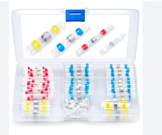

I'll go against the grain, I hate wire taps. I'd rather spend the extra few minutes actually splicing the connection together, even if its a 2 to 1 splice.
I've been using these self soldering connectors for years now, pretty much exclusively in any 12v work I do.
I would agree here, but since this is just a simple switch light and the unknown- of operation- dimmed.
I made the suggestion of the tap, did not want to see a cut wire for something that won’t work.
Now if this was exterior lighting or a high draw circuit - by far a solder splice - no question.
Well I take that back, I have used T-taps to verify if something works, then I actually go back and splice it. LOL
