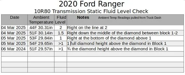

So this morning I began taking ambient temps from inside the truck by simply turning the ignition on and recording the temp from inside the cab, them checking then checking the transmission fluid level. Here are my first two entries. The truck has not been started or moved. A 6F change in ambient temperature moved the fluid level up 1/2 a block on the dip stick. A bigger jump than I anticipated.
It reached a high of 66F today, but my garage remains colder longer. I'll keep updating this chart at spring progresses to quantify how ambient temps affect fluid level measurements.
It would be interesting if others could confirm my findings.
