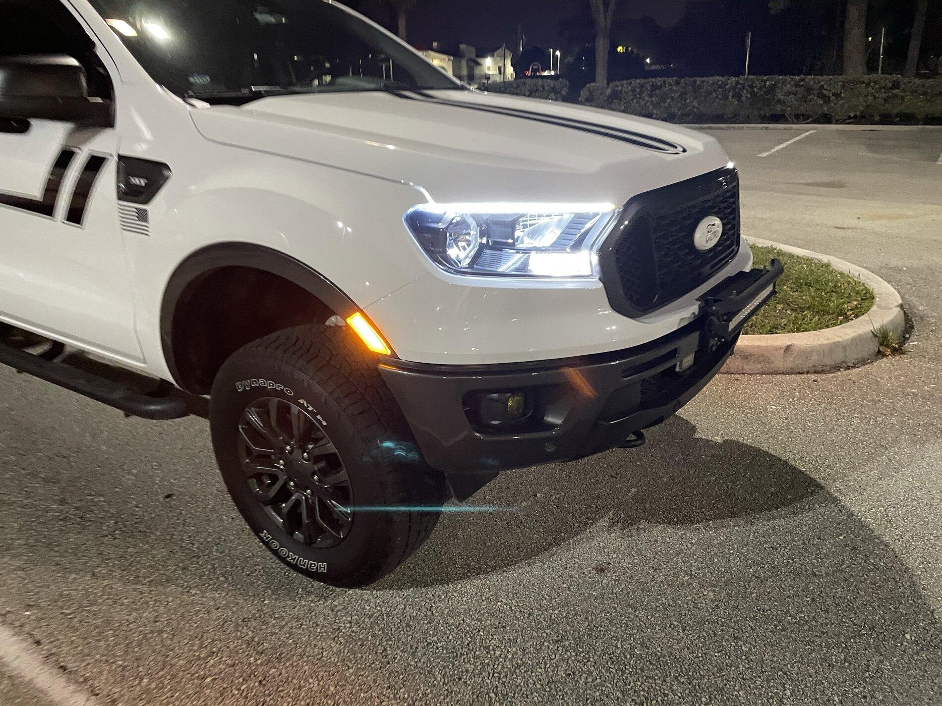

Here's the DRL on the Luxx.
While I have the Luxx, I'm still interested in how the Pro with LEDs look. Wonder if the cutoff is the same which would be a cool option (and possibly better than the Luxx with the ability to change bulbs :D).
I have seen pics with LEDS put in the pro but I guess I cant link to the facebook group where the pics were posted. From what I understand talking with the alpharex rep it is the same lens in both luxx and pro. I received my pros today and will be installing shortly and I do plan on putting led in the housing.
