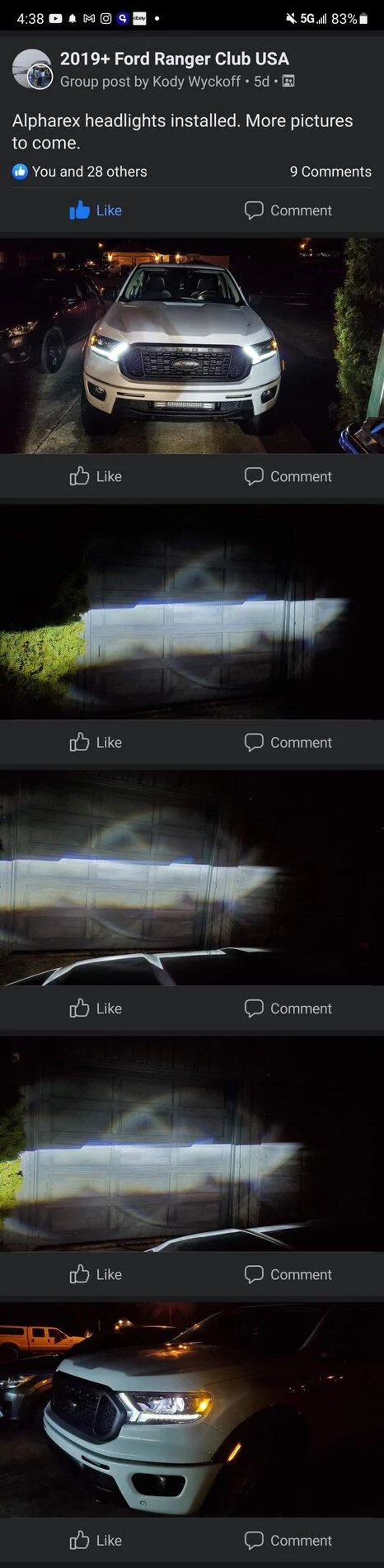

I posted those pics in the other thread. I don't know if it is exactly what you want but this is Pros with leds swapped in. He is testing 2 different leds. This is not my truck.

Interesting. Doesn't look as good as I had hoped with an LED bulb swap. Maybe that person is using insanely overpower LEDs though, so who knows. Seems like the first option is really the only one that would be remotely acceptable since it has very little bleed over the top.
Not the best quality pictures. Looks like he is quite close to the garage door and shooting through his windshield. Might be cause of some of the glare/flare. Agree with the brightness of the bulbs. More lumens is nor always better or technically legal.

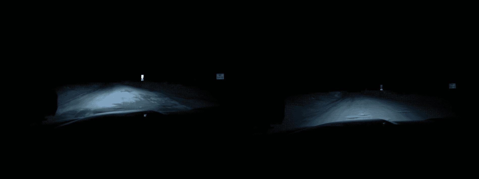

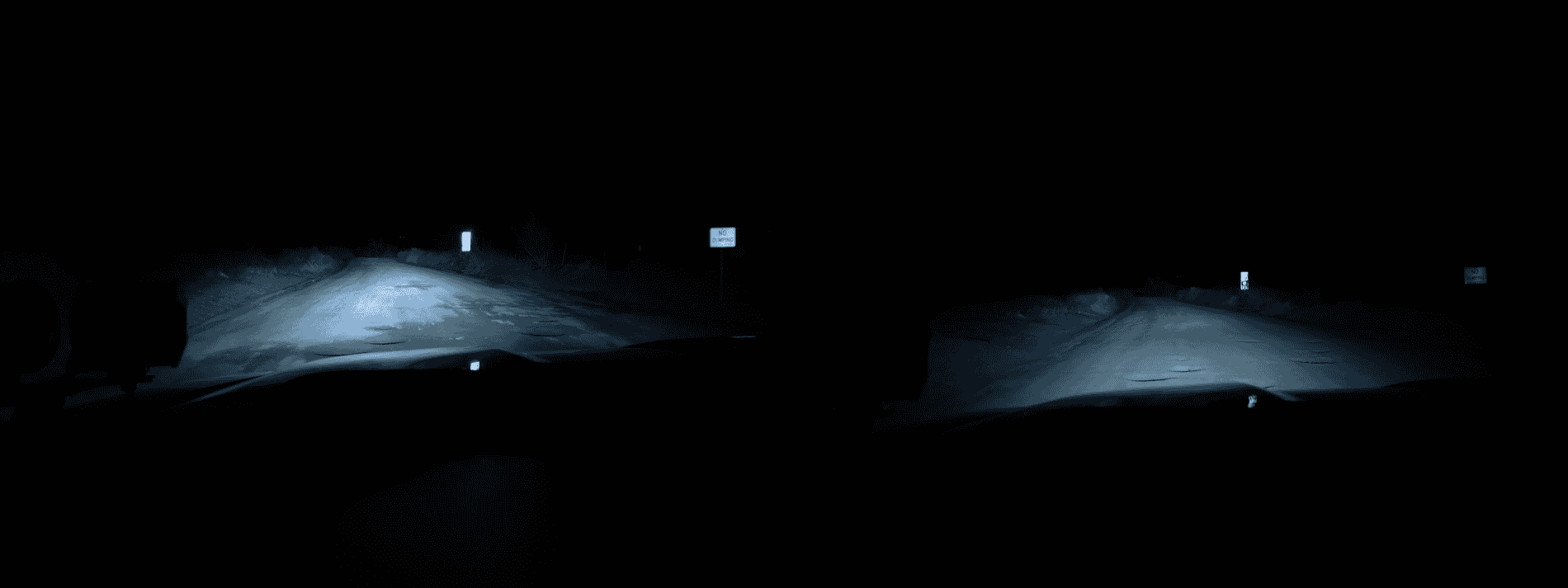

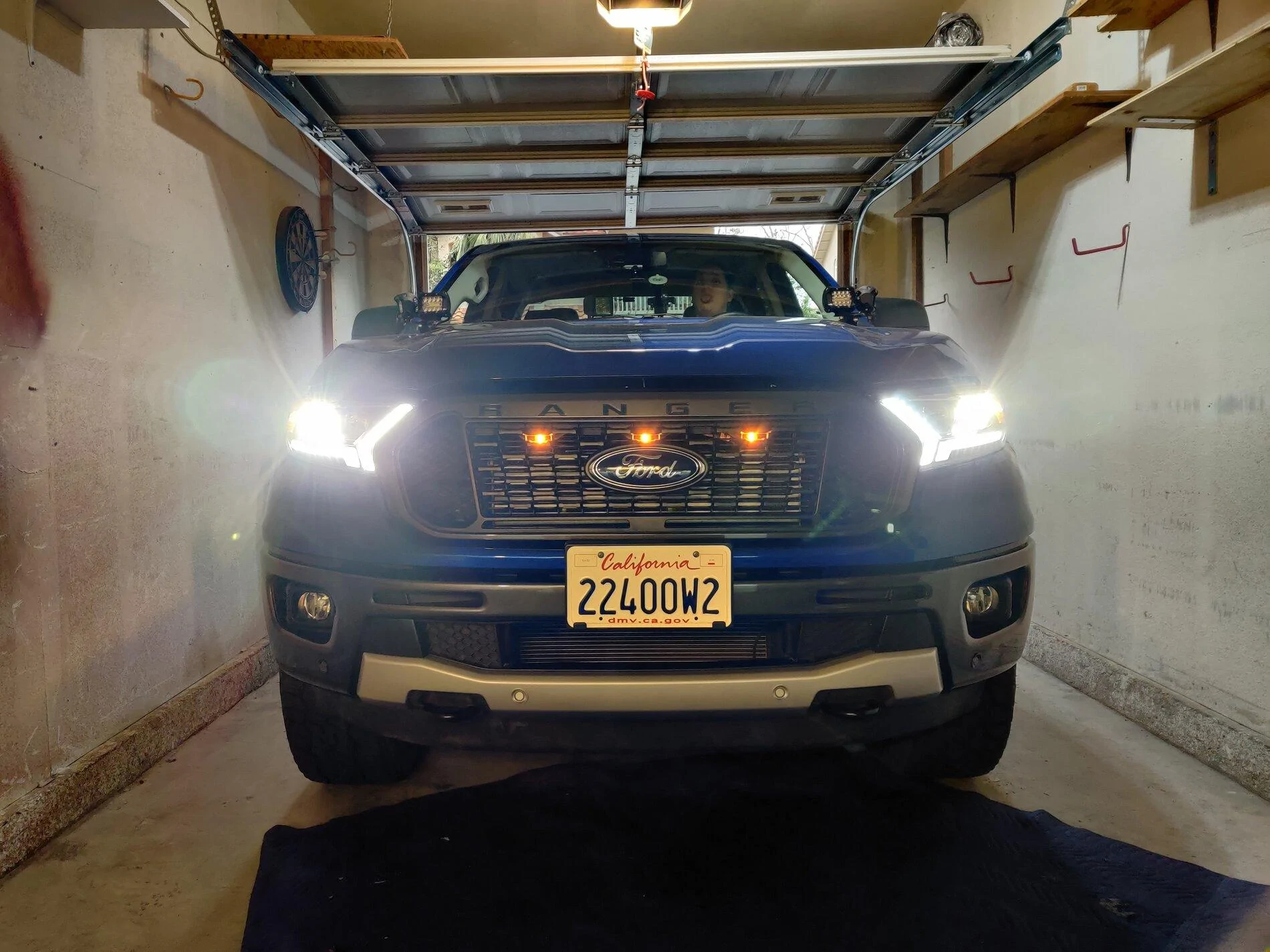

Sorry it took so long to get the pictures edited and uploaded. Below is a comparison of stock XLT headlights with overpowered LEDS vs the Alpharex LUXX headlights.
In my opinion, even though there's a little less output from the Alpharex housings, the output is more focused and actually useful, especially compared to the 16k lumen high beams which are impossible to use on the street (and I only used them off-road at night). The LEDs were "ok" in the stock housings but the focus is pretty bad overall.
These pics are taken at as close to the exact same location as possible, all using the exact same camera options (phone camera, but manual mode).
Photo options:
ISO: 250
WB: 4090k
Shutter: 0.5
LEFT = Stock Halogen Assembly with Car Rover 55W (10,000lumen) low beam and Easy Eagle 80W (16,000lumen) high beam bulbs
RIGHT = Alpharex LUXX headlight assembly (the end-aim was within approximately 1 degree of correct).
Low Beams (No fogs):
High Beams (No fogs):

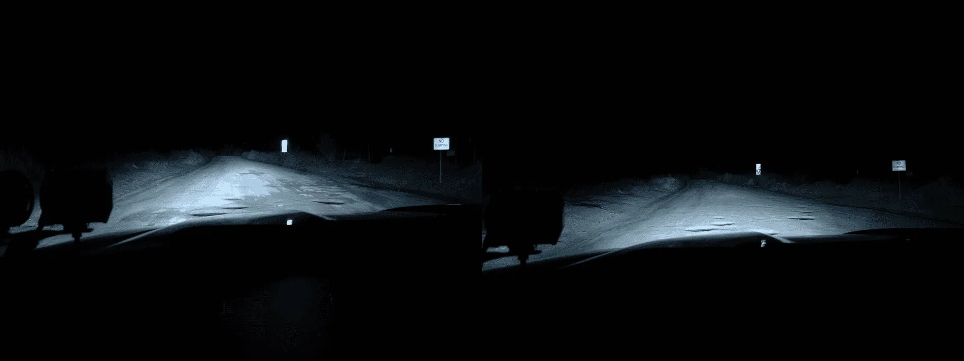

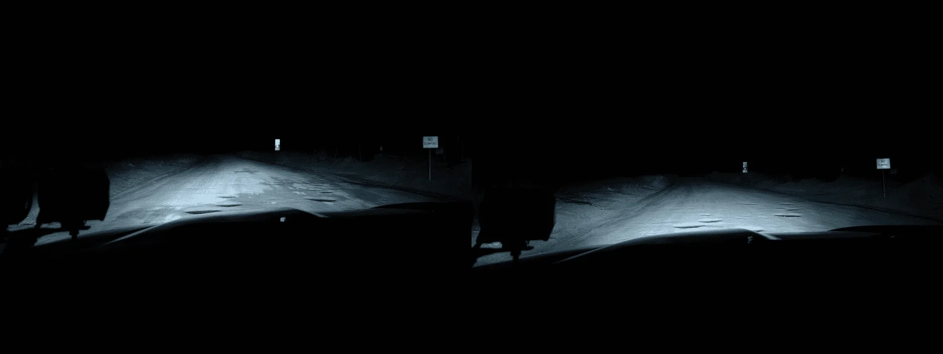

The fog lights I'm using are the same in both below pictures - stock housings with Diode Dynamics SL1 bulbs.
Low Beams (with fogs):
High Beams (with fogs):

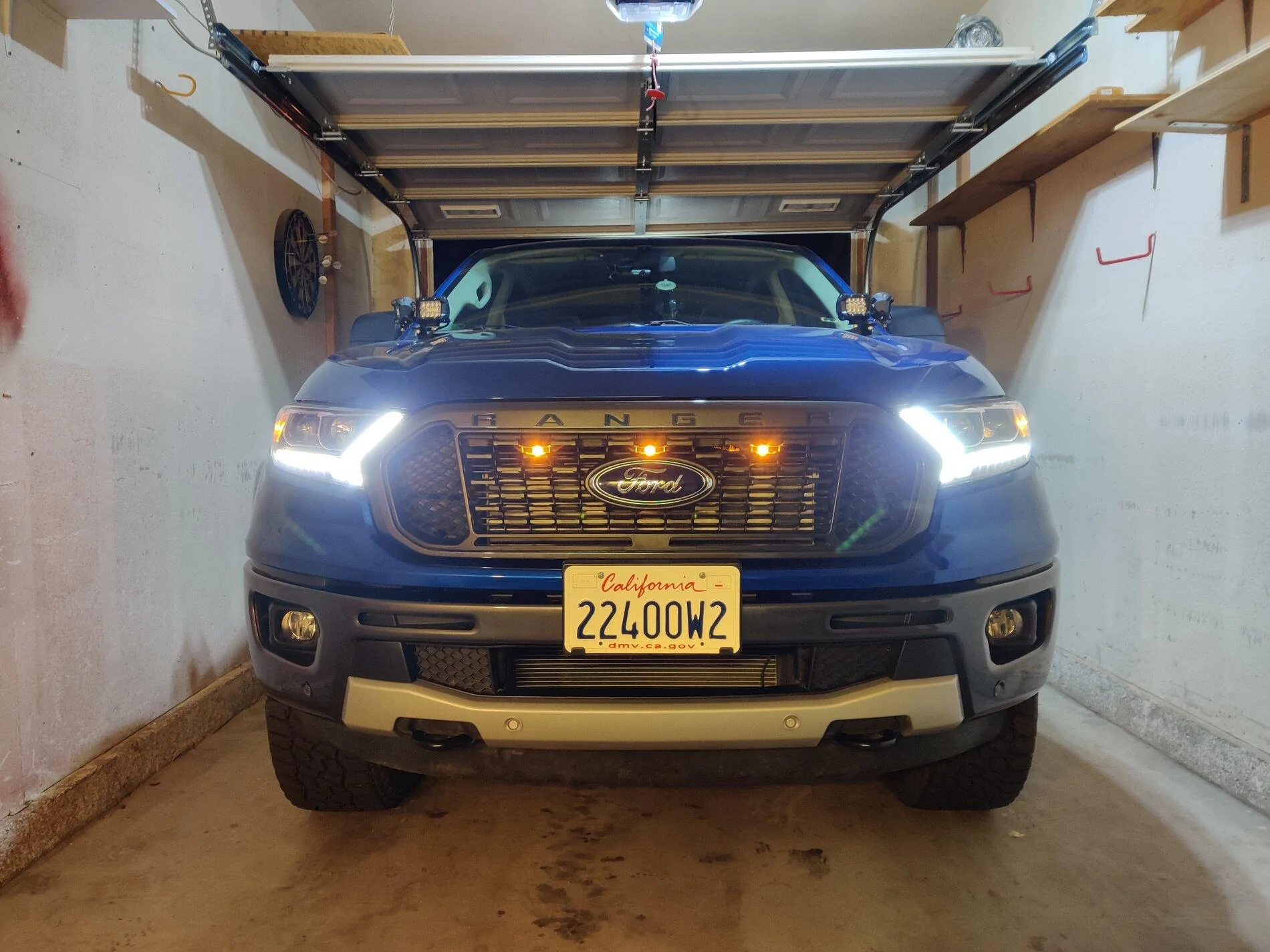

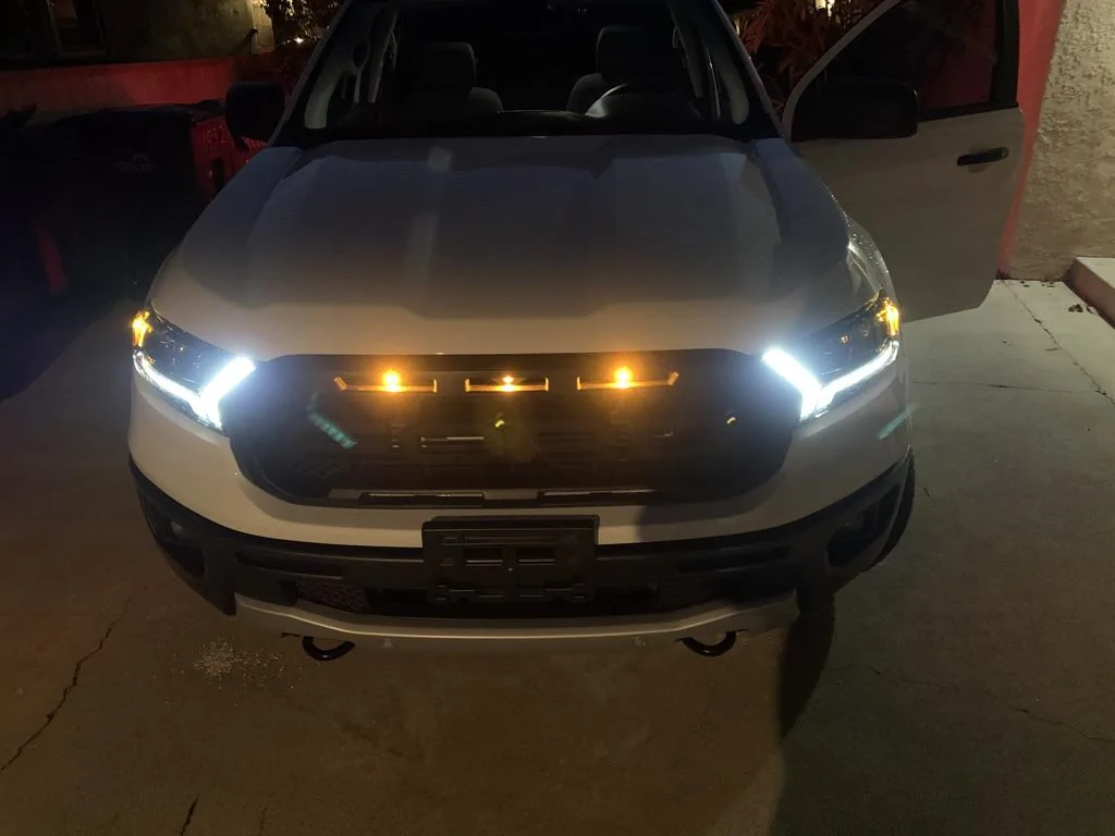

I think it has been said already., but here it goes. if You hook the extra wires provided with headlights. You will have DRL, without having to turn on lights ( stock headlight you needed to put light switch in "Auto mode " in order to have your low beams as DRL ). Alpharex actually has DRL. The white lights on ( those are DRL, come on when inigtion is on { in this picture my parking lights are on } provided you hook up extra wire ).
