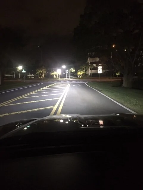

If we could do a group buy, I'd be in for a pair of the Pro's. For now, my stock lights with the Auxito LED's are pretty darn good.
Halogen vs Auxito LED's

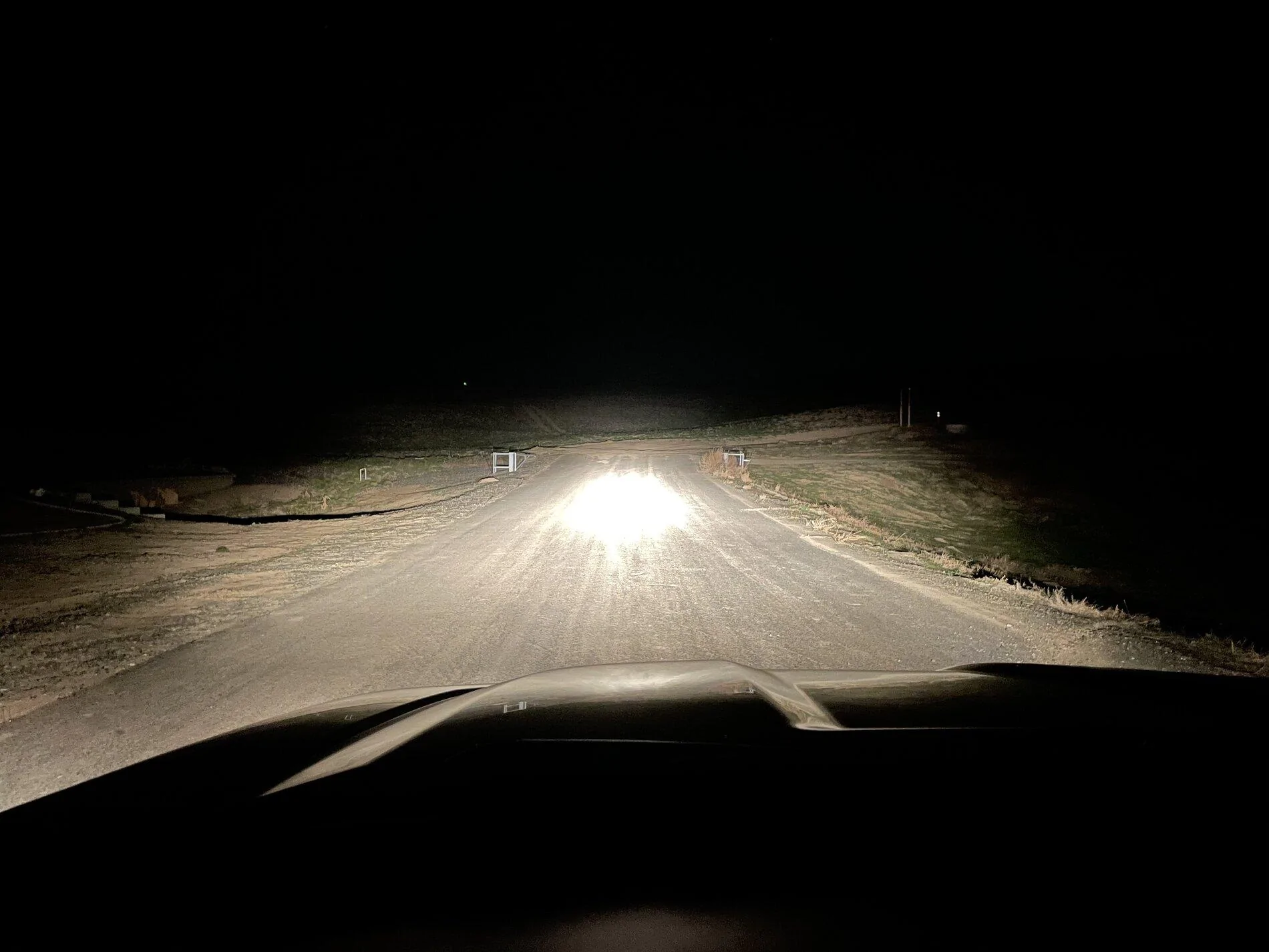

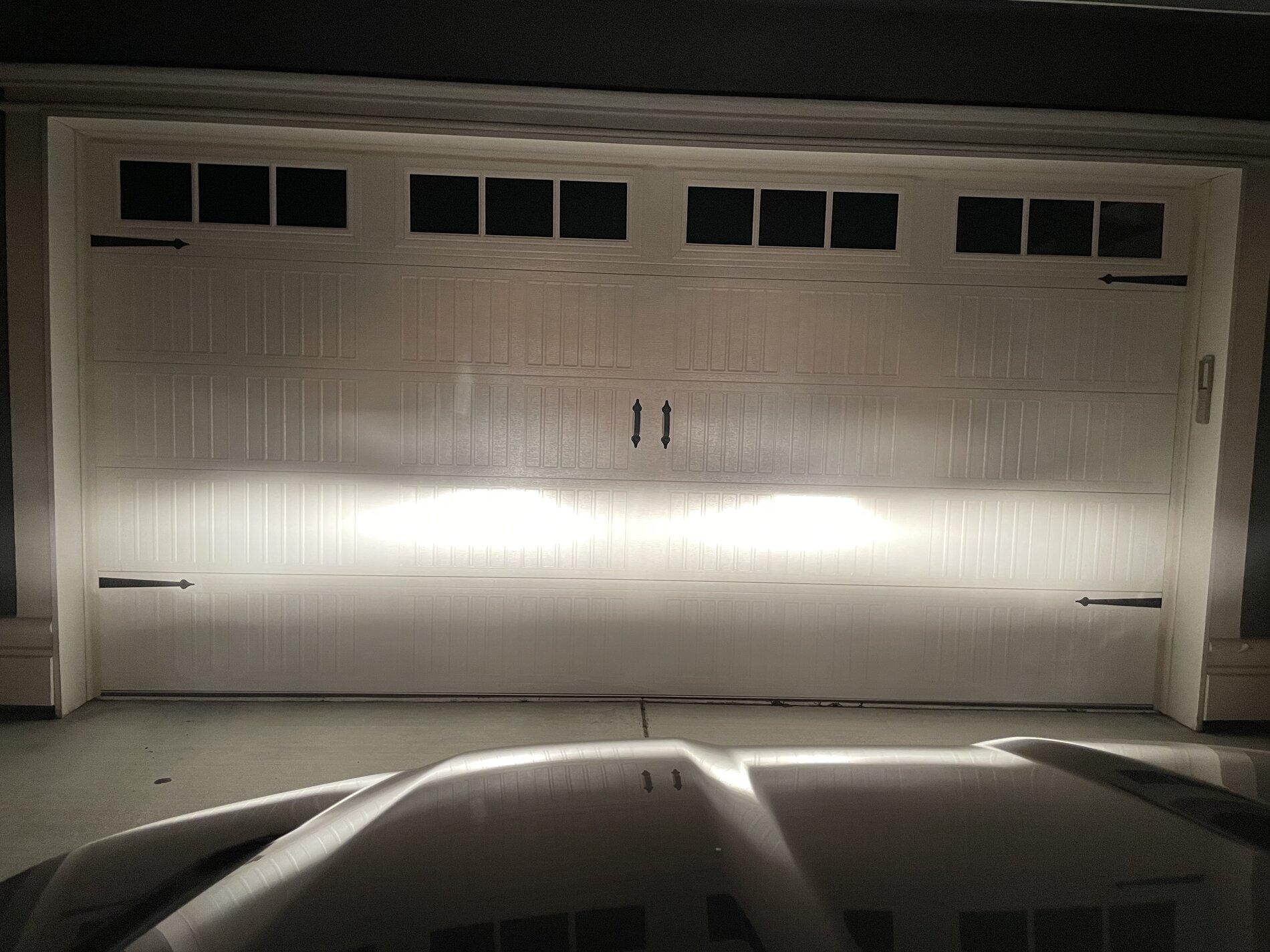

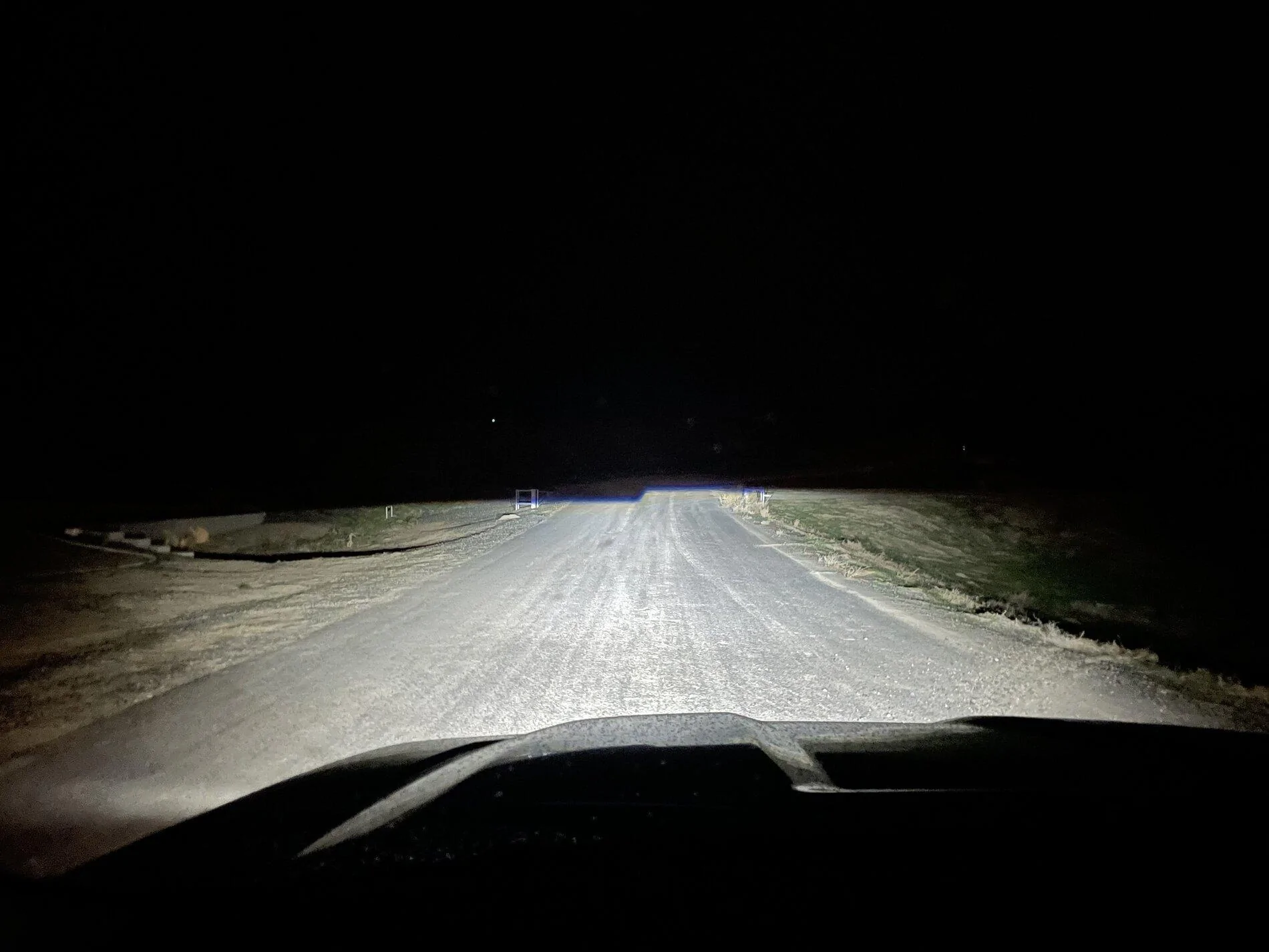

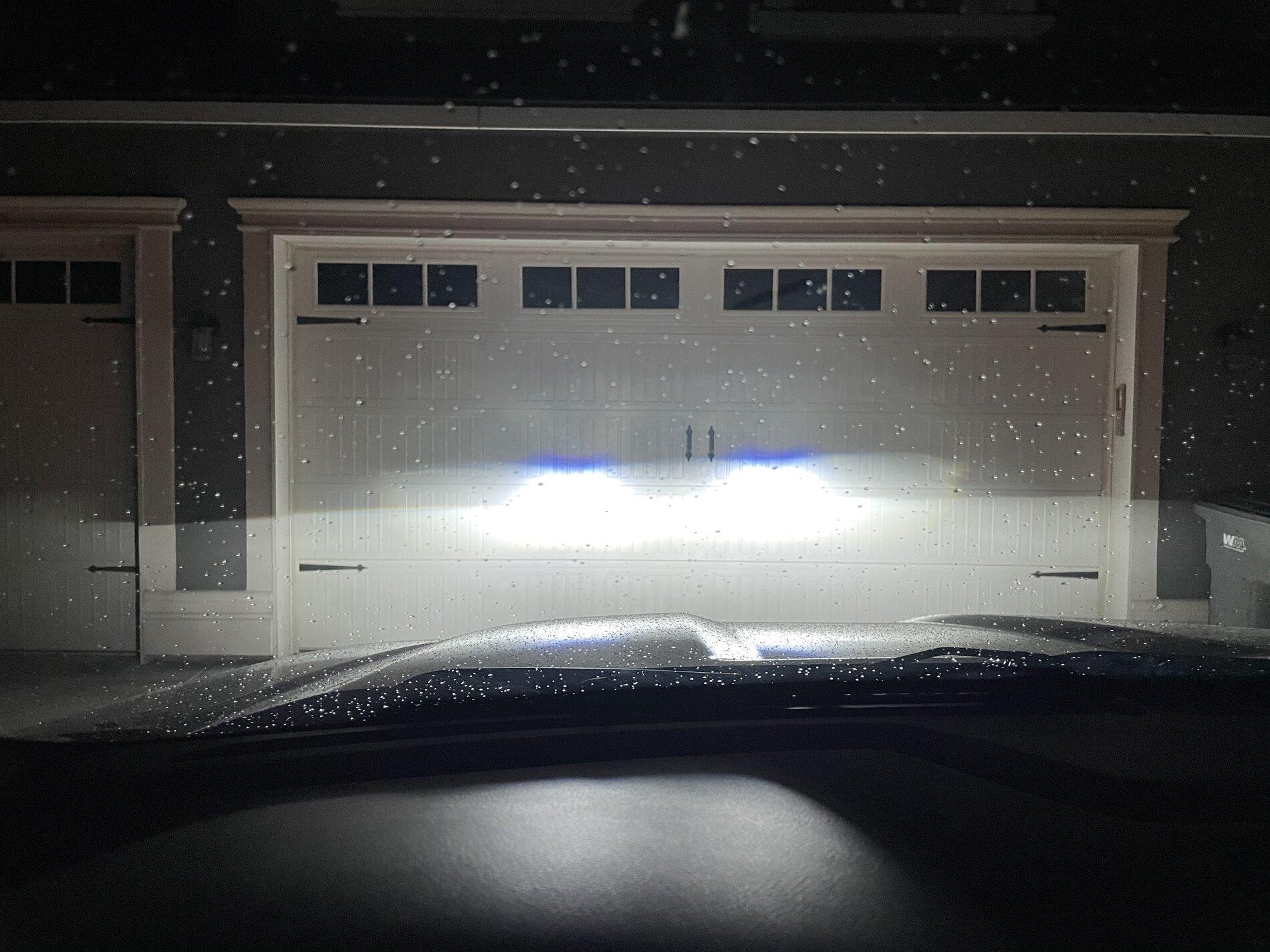

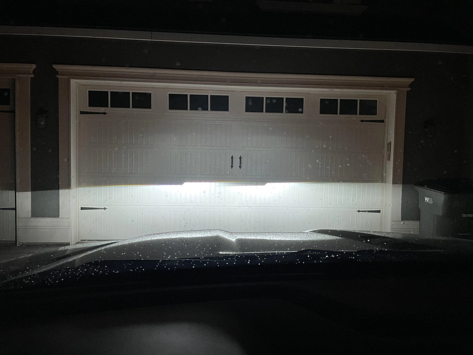

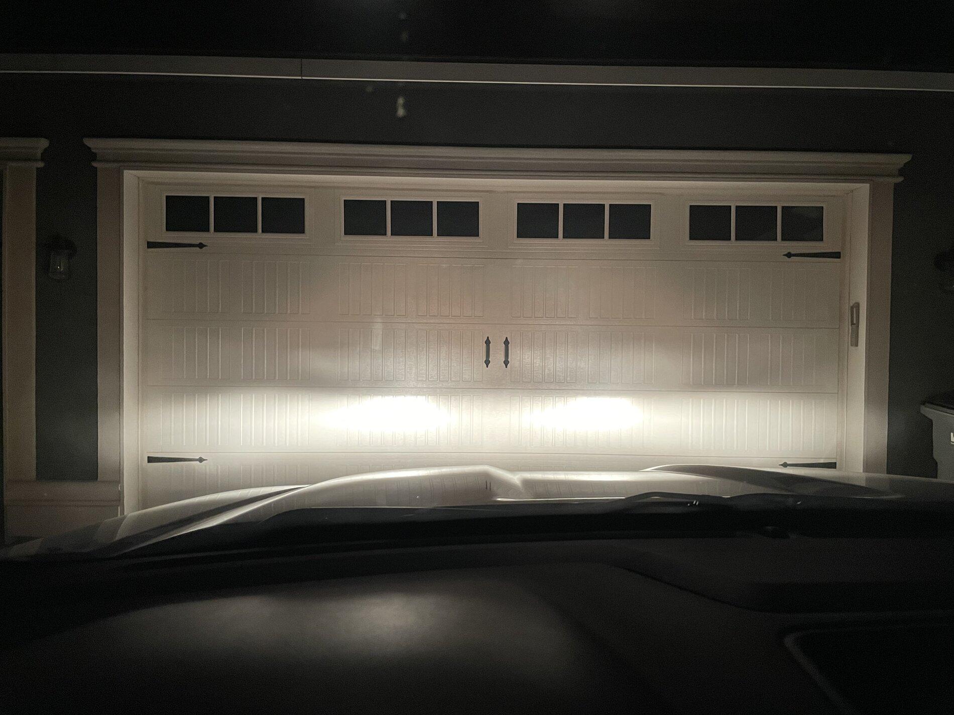

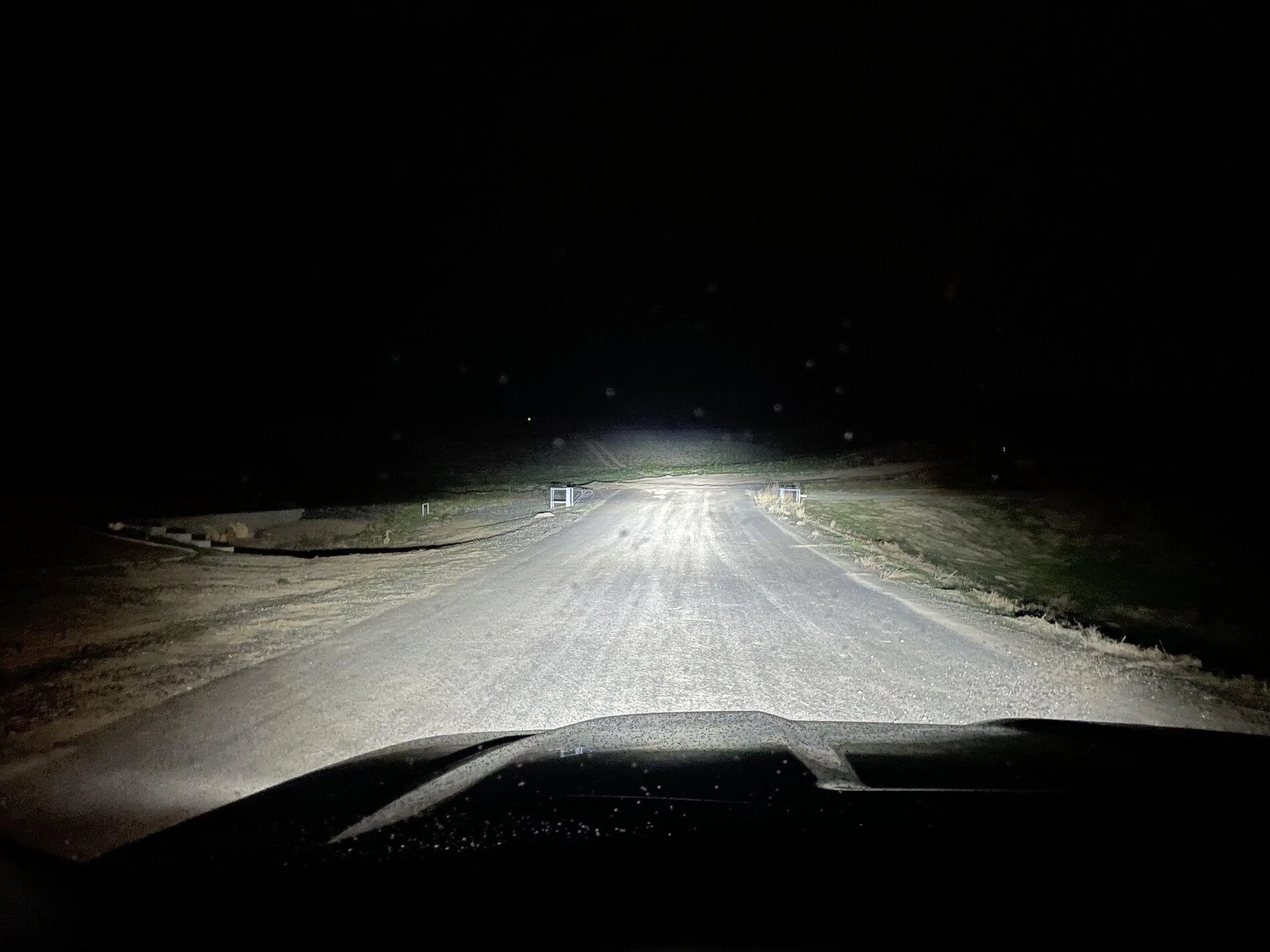

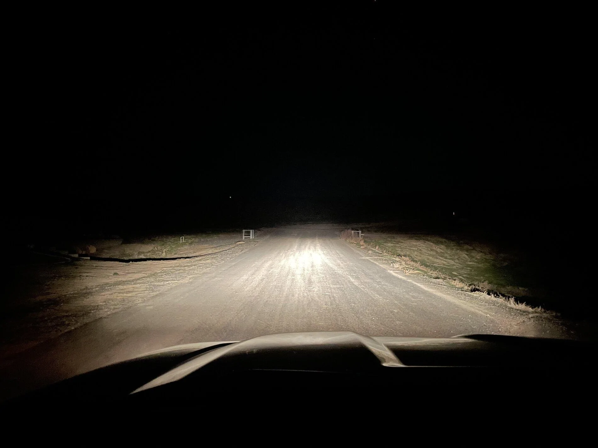

Here's some before and after. It was a little rainy tonight (just a drizzle) but otherwise I tried to keep it the same. I live on a dead end road that backs up to a farm so I marked the spot I was at yesterday to try and recreate. I do think my passenger side projector is a little high, but hopefully this is helpful. There's hardly any light around here so I figured it'd be a good show of just the output from the headlights.
Alpha-Rex Luxx in alpha black
Before [driving against garage door @ 10 feet]
After [driving against garage door @ 10 feet]
Before [brights against garage door @ 10 feet]
After [brights against garage door @ 10 feet]
Before [driving along road]
After [driving along road]
Before [brights along road]
After [brights along road]

I appreciate it, what series did you get? The biggest thing I notice is the light pattern is wider. Distance seems about the same compared to stock but yet a better light output

Luxx in alpha-black. The light output is much brighter, and the distance is the same on low since it has the cut off to not blind other drivers. Brights do seem to throw farther but it's hard to pick up in a photo. I'm going to try to get a video I took up and post that too.

I do see it now that you mention it. Did you hookup the extra wire for the driving light or do you keep it on auto?

Also did you have halogen or led lights originally? Its a bit tough to tell

I did hook up the DRL wiring, but that wouldn't have any impact here I think it's showing the lights on, and then with brights.
Just halogen stock XLT headlights.

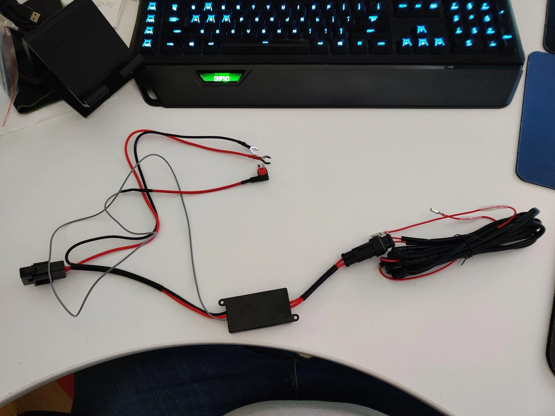

Just another reminder before I post this, I went with their "normal" Black LUXX housings (not Alpha-Black, because I wanted the chrome offset) for my stock replacements.
In trying to understand all of their wiring, I took a look at the harness that comes with the lights and asked them some questions. Here's what I've got for you.
This is their DRL Harness. The left side wires to the vehicle (positive, negative, grey fuse-tap to ignition-tied source), the right side runs to each of the headlight housings that have a single lead they connect to:
  1. The DRL harness (shown above) is a dual-purpose device:
    1. It is used to power the LED bars startup sequence.
    2. It appears (this is still slightly nebulous based on the information I have) that it also controls whether or not there is any DRL function in the headlights at all (they haven't given me concrete answers, but it sounds like the "standard" DRL signal from the truck is ignored in the housing if you don't have the DRL harness installed).
  2. The lights will function just fine without this DRL harness, the LED bars will then be activated with the parking lights, including the startup sequence.
I will be testing this on Sunday to get a confirmation one way or the other about point 1.2, because it would be weird to me if there was a special signal that the truck was sending to the headlights to run the low beams at low-voltage for DRL usage.
Hope that helps, let me know if you have other questions and I'll try to get more answers.
Alright, UPDATE TIME! (Especially for you @the1mrb and @User79)
  1. The DRL harness is still technically dual-purpose, but modified:
    1. It powers the LED bars startup sequence with whatever trigger is tied to the grey wire (supposed to be ignition). However, if this isn't hooked up, the startup sequence will trigger as soon as lights come on, meaning it's not required for this.
    2. The stock DRLs *WILL* power the low-beam bulbs just like they do in the stock housings without the DRL harness hooked up. If the DRL harness is hooked up, the LED bars will light as soon as ignition is powered, and they will dim slightly when the DRLs kick on (when the truck is put in gear).
  2. Still confirmed, the housings will function just fine without the DRL harness wired up, including normal stock low-beam daytime running lights.

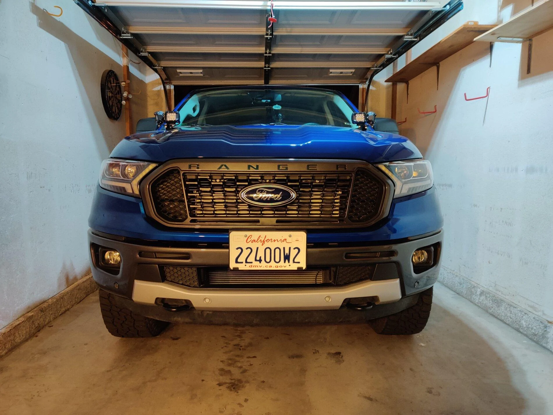

Lights Off:

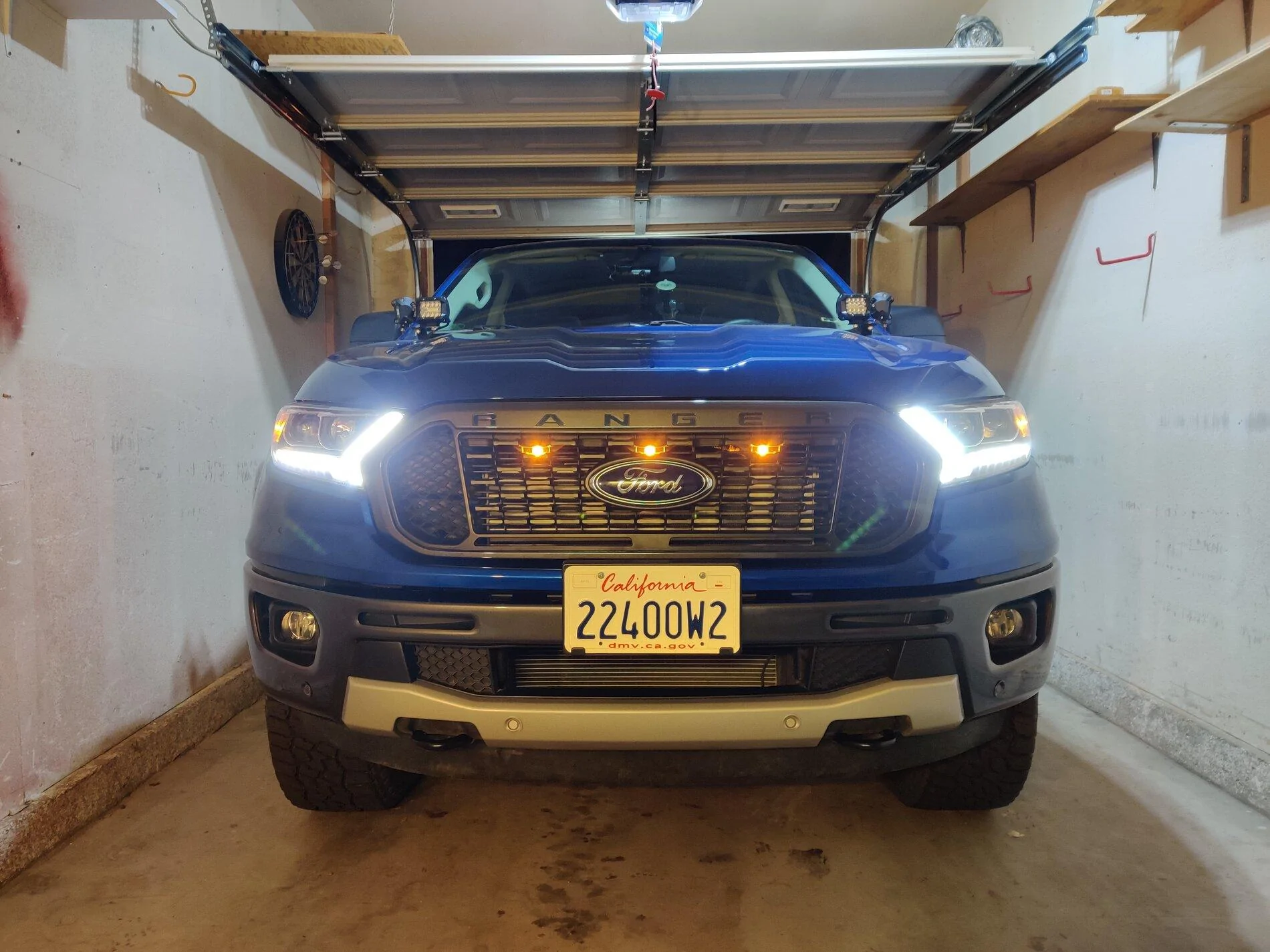

Lights On (from unlock with remote):
If you have any other questions that I can answer let me know. I have some videos to share when I can get them in a shareable format. I'll also be putting together a how-to for this install since...Alpharex hasn't yet provided one for the Ranger.
