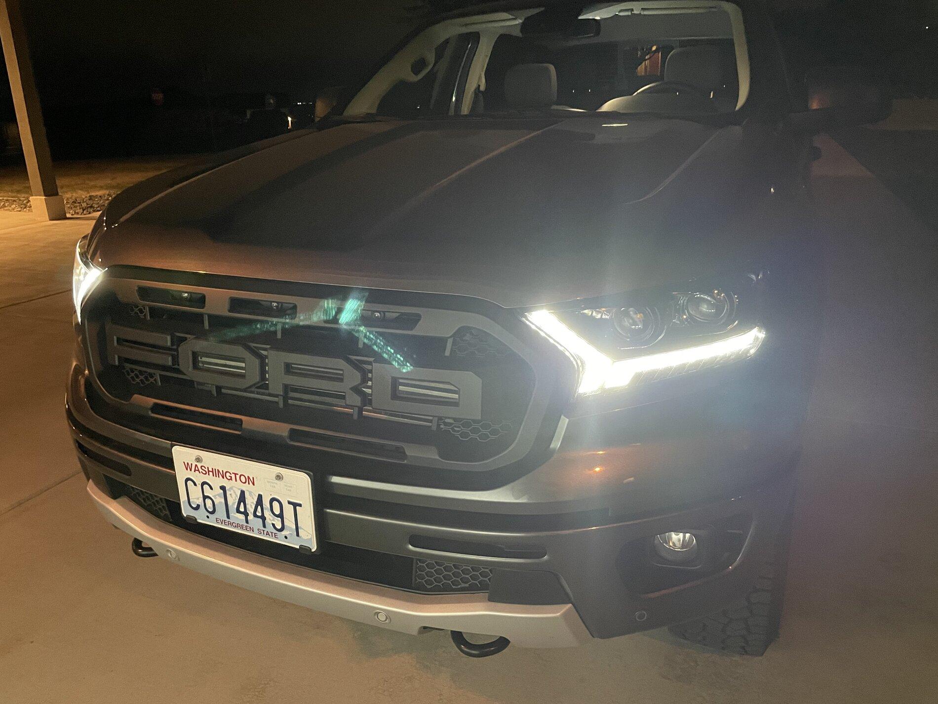

Here's the DRL on the Luxx.
While I have the Luxx, I'm still interested in how the Pro with LEDs look. Wonder if the cutoff is the same which would be a cool option (and possibly better than the Luxx with the ability to change bulbs :D).

And with this, there's one thing to be clear about.
"DRL" is used in two ways here. Alpharex calls their module the "DRL" module, however, that has almost no interaction with the *vehicle DRL*. Stock DRL is low-voltage low-beam activation (with switch in auto mode), which works with or without the DRL module from alpha. The impact of the DRL module to the headlights is to dim the DRL when vehicle DRL (low-beams) are triggered, and to manage the startup sequence without turning lights on.
Yeah I'll be honest that I've been a bit confused on what is what with DRL. This picture was with the lights off but when I turn the lights to auto during the day I perceive a brightness difference between on during the day and actually on. I'll try to test it more tomorrow.
