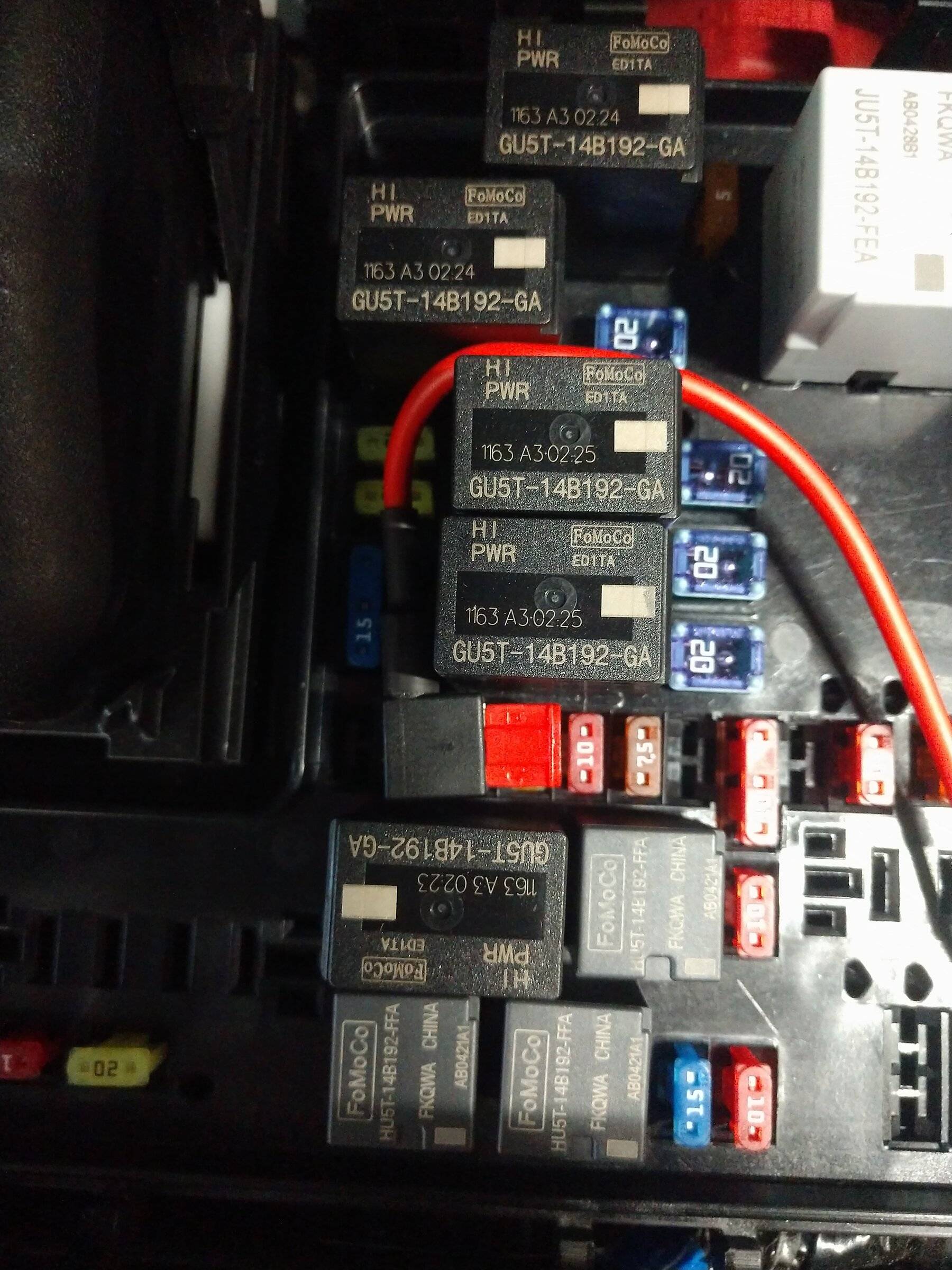

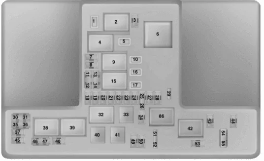

Does anyone know why my DRL harness for the LUXX headlights does not seem to fit into fuse #24? It seems really loose and is not working as expected when my automatic lights are on. I tried to call alpharex numerous times but they don't seem to have a clue. Thanks!
No, it does not fit in that slot, since there's no terminals there, at least on my '21. I contacted them and told them this and they said they would add it to their description, but I guess that didn't happen?
I used the electric steering fuse and everything works as it should.
Wow thanks man. I have a 21 as well. Can you please take a picture? I don't know where that is ha
Sure! Give me a second and I'll go take a pic.
Pic was tough to get, but here it is.
It's #19, which is a 10amp already. That's the Electric Power Steering :)
