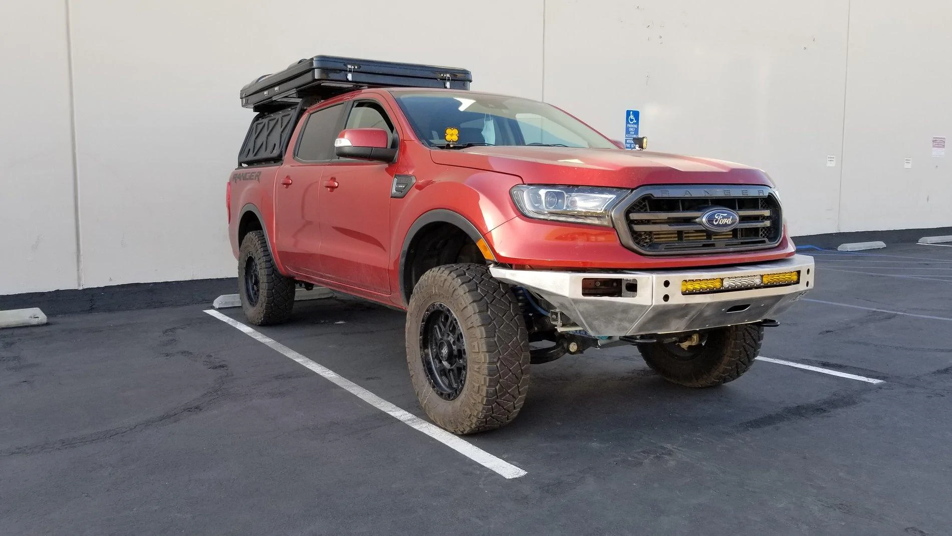

Mounted my prototype this past weekend. Modular 3 piece design, winch capable, keeps factory parking sensors, aluminum (super light weight and strong).
Gotta tweak a couple things and run it a while to make sure there's no issues then I'll have a production version ?
Man this looks so good. Add a little brush guard bull bar and it'd be just what I've been looking for. I realize this is an older thread but whatever. I really like it.

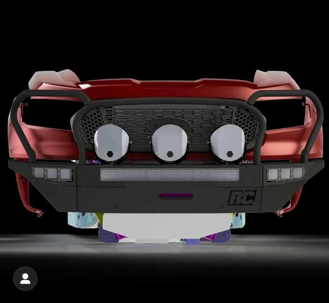

Thanks man! You mean like my initial rendering? *attached below*
Been working on my v2 for testing that will include the removable bars up top that I should have done somewhat soon. This year's been...not helpful with progress haha. I'll post up about it when I have it done ?

Yes, many prerunner style bumpers are to lower weight but maintain most of the strength (with a winch and all the lights mounted I'm still within a few pounds of the total weight of the factory bumper).
Not bad! I am curious though - it's a bumper made of aluminum?

Hunh. Wonder how that works out in an auto collision, or roadkill situation.

Totally depends on which metal variant is used, thickness, design, structure, what's mounted in and around it, etc but generally a well designed aluminum bumper will still be stronger than the body of the truck and everything else around it, so if you're having a problem with the bumper, the truck likely won't be driveable. In a major accident, the bumper won't save these aluminum trucks. But that is also one of the many reasons I designed it to be 3 pieces, so if you have a front 3/4 accident/roadkill/hit a rock/wall/whatever and dent one corner of the bumper, you don't need to buy a whole new bumper just that piece if you want it to look new again.
I'll take a small strength loss for the enormous weight loss when my focus is generally keeping performance for both on and off road performance (mpg, speed, weight distribution, etc) rather than absolute strength at all costs.

That's interesting. I'd actually never really thought about it before. I come from bicycle world, we're endlessly discussing materials science re: steel vs alum and where to use it and why. Frames: steel. Wheels: alum. Bars: alum. Racks: ehhhhh. I guess the only real reason to have a steel bumper is if you intend to recover it. That segmentation affair is an interesting direction to go. In bike world we use replaceable derailleur hangers on alum and carbon bikes for similar reasons.

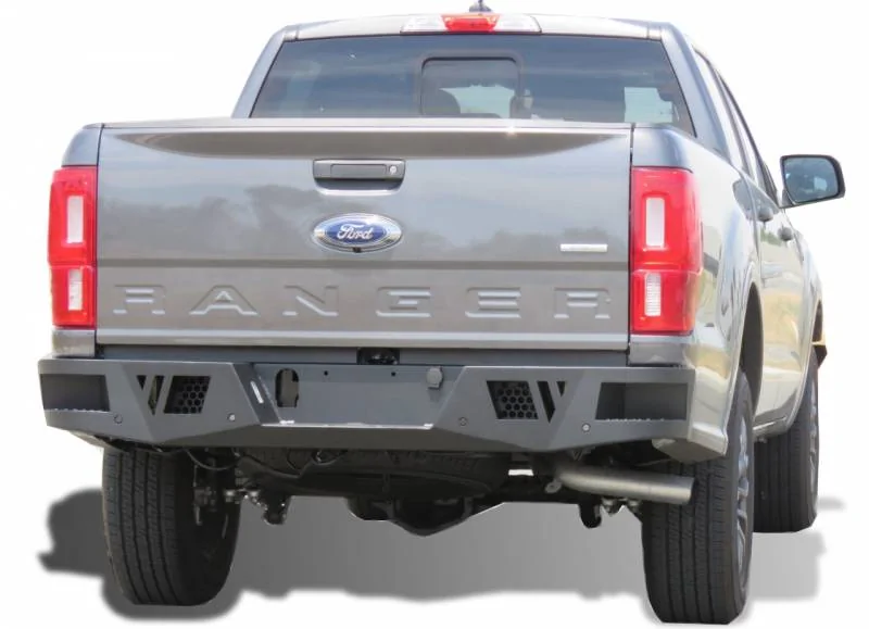

I've always liked the Colorado rear bumpers with corner steps and have been looking for a rear bumper that is similar and just found this one.
Black Horse Armour Rear Bumper
I like the steps built into the side of the bumper and this one is quite a bit less than others that I find less appealing.
No idea about the quality though and the price makes me wonder about that.
Edit: Well I ponied up and ordered this one.
I'll let everyone know how it works out.

Well? Verdict?
DOH!
Forgot about this particular thread as I've posted it in a couple of others.
I like it.
The corner steps are awesome for accessing the bed and the LED pods make for great backup lights.
Quite a bit heavier duty than the factory steel rear bumper.

Ah yeah and in the bicycle world, ounces matter not just pounds. Same with motorcycles (one of the other worlds I'm designing things for coming up).
Yes, steel is good if you intend to bash it up all the time and are ok with the huge weight difference. I have been offroading decently hard, running it thru undergrowth, etc for a while now and haven't had any serious enough impacts on mine to do any damage.
I like the segmentation idea where things can come apart/off without destroying the whole thing. That's what I figure is most likely to happen, clipping a rock or something and even if it rips up that side piece, you still have the other 2 pieces totally fine and can just replace a side.

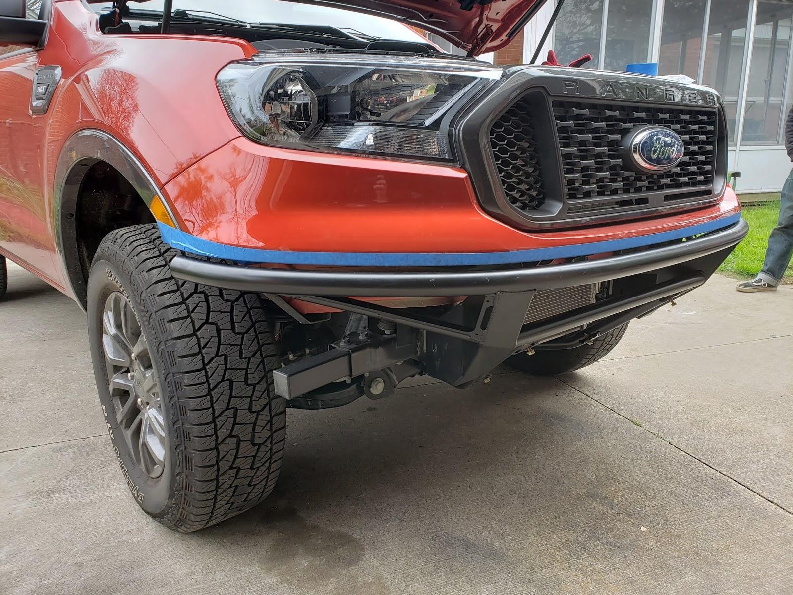

Working on it the SVC Bumper install...
I am in LOVE with this thing. It's so CLEAN looking with that straight top line.
-Tom
Hey Tom, I'm resurrecting this thread here. Do you have any more photos with the SVC bumper I haven't seen anyone else post it.
