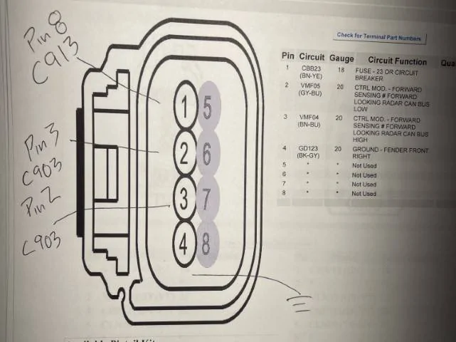

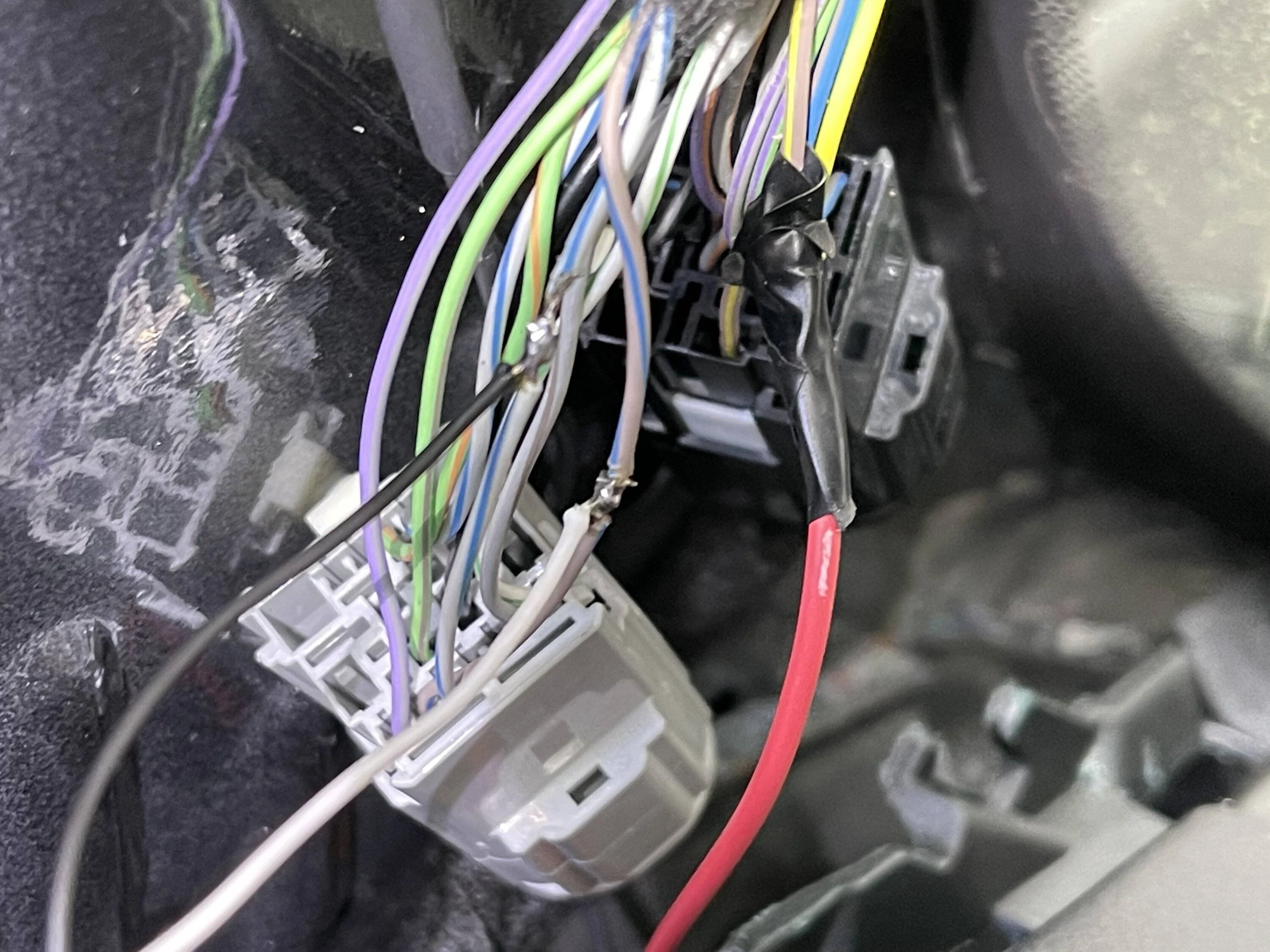

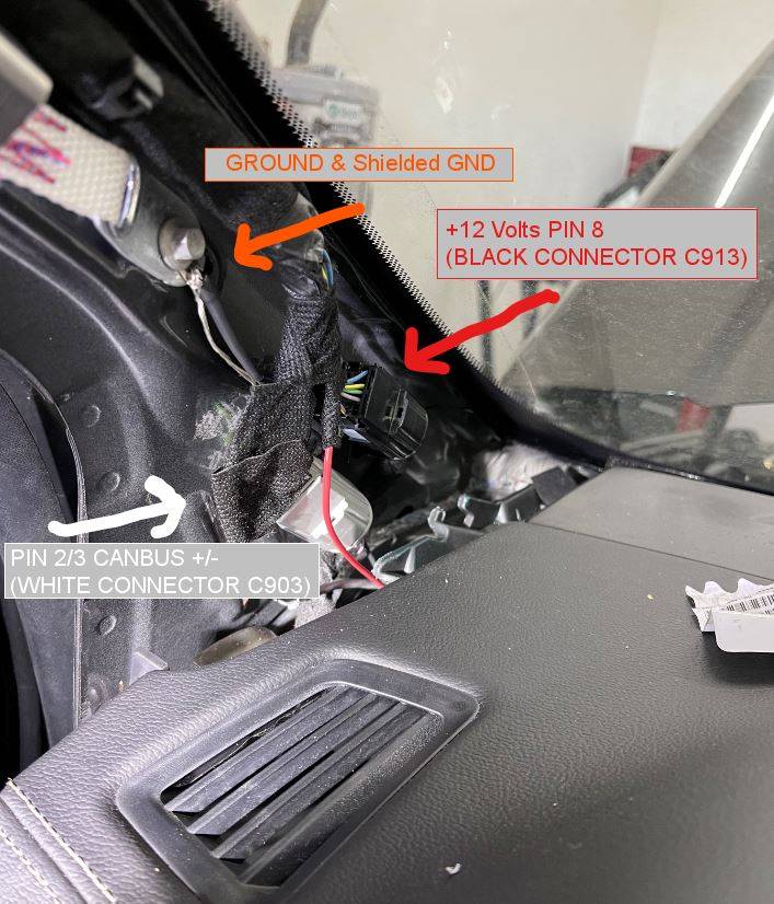

Oh no, I think that was covered a few pages back - that's why I just made my own harness from the pigtail of the sensor.Well after much work on this front the factory wiring harness (listed previously) has no connections, Power, Ground or CAN BUS @ the connector C145.
