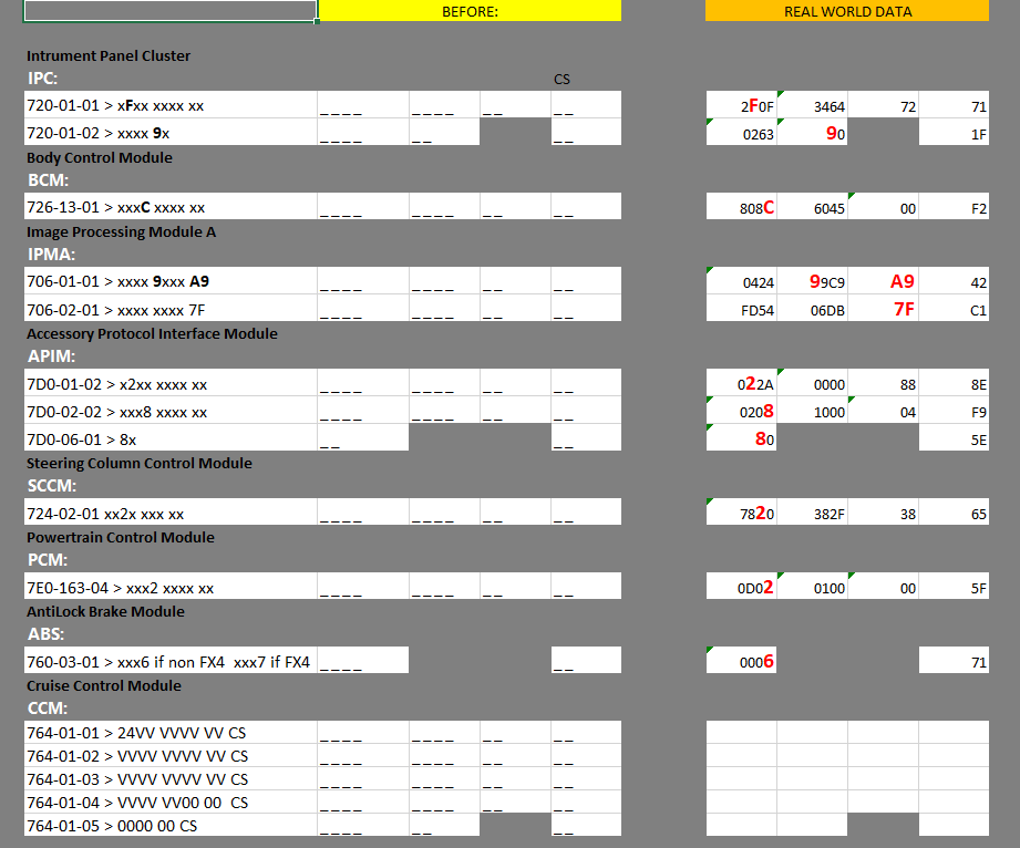

Yes it is a supercrew FX4 with elockerYep that's TC... Your 760-03-01 Block is 0005 CS 70 which I based on this observation:
ABS Blocks 760-03-01 decoded:
No options 0004 6F
ELocker (FX4) 0005 70
+ACC 0006 71
+TrailControl 0007 72
which is ELocker (FX4) but the +TrailControl of 0007 at that block is a bust.
I know no options is 0004 Checksum of 6F
pretty sure FX4 (elocker) is 0005
ACC is 0006
and Loaded is 0007 Checksum of 72 <- but not sure what this includes.
I show your truck is a SuperCrew with the FX4 package based on:
760-02-01 of 0505 (x5xx = FX4, x1xx = without)
760-02-02 of 0503 (5 = supercrew, 4 = supercab) (3 = FX4, 2 = without)
based on my observations. Hopefully that is correct.

Hey DaveThis is what I think it takes to add Adaptive Cruise on a US Ranger:
| ;Block 9 ACC and Menu enabled | ;Block 9 ACC and Menu disabled | |||
| 7D0G9G1 | 2004 0000 0005 | 7D0G9G1 | 0004 0000 00E5 | CHANGE |
| 7D0G9G2 | 0000 0200 00E4 | 7D0G9G2 | 0000 0000 00E2 | CHANGE |
| 7D0G9G3 | 0000 0000 00E3 | 7D0G9G3 | 0000 0000 00E3 | SAME |
| 7D0G9G4 | 0000 0000 00E4 | 7D0G9G4 | 0000 0000 00E4 | SAME |
