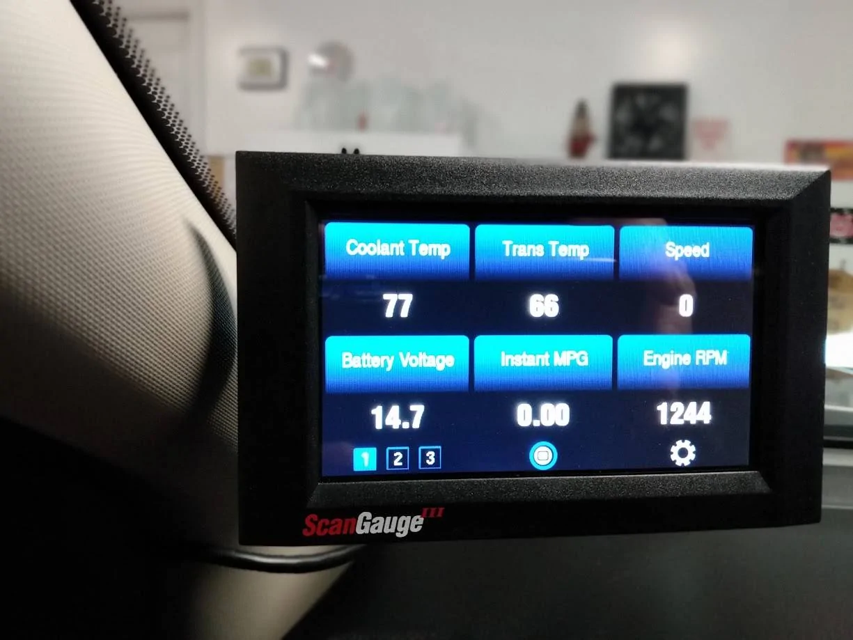

Save yourself money and grief trying to route/run/attach gauges.
Get a Scan Gauge 3...it monitor dozens of info points, including the coolant temp and the important trans fluid temps.
Check their webs site for a complete list of what it monitors. I tow a travel trailer, and have one...pretty much what I look at now instead of instrument panel.

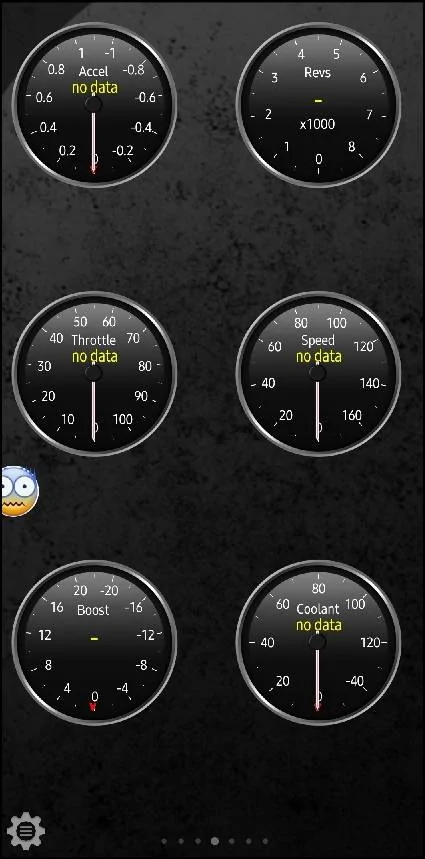

Here is another option. This is the Torque app. You need to use a BT
OBD2 adapter in the diagostics socket. It has multiple parameters that you can set up on different pages. Their is also another new app that works with Android auto, DashOBD but the parameters available are somewhat limited.

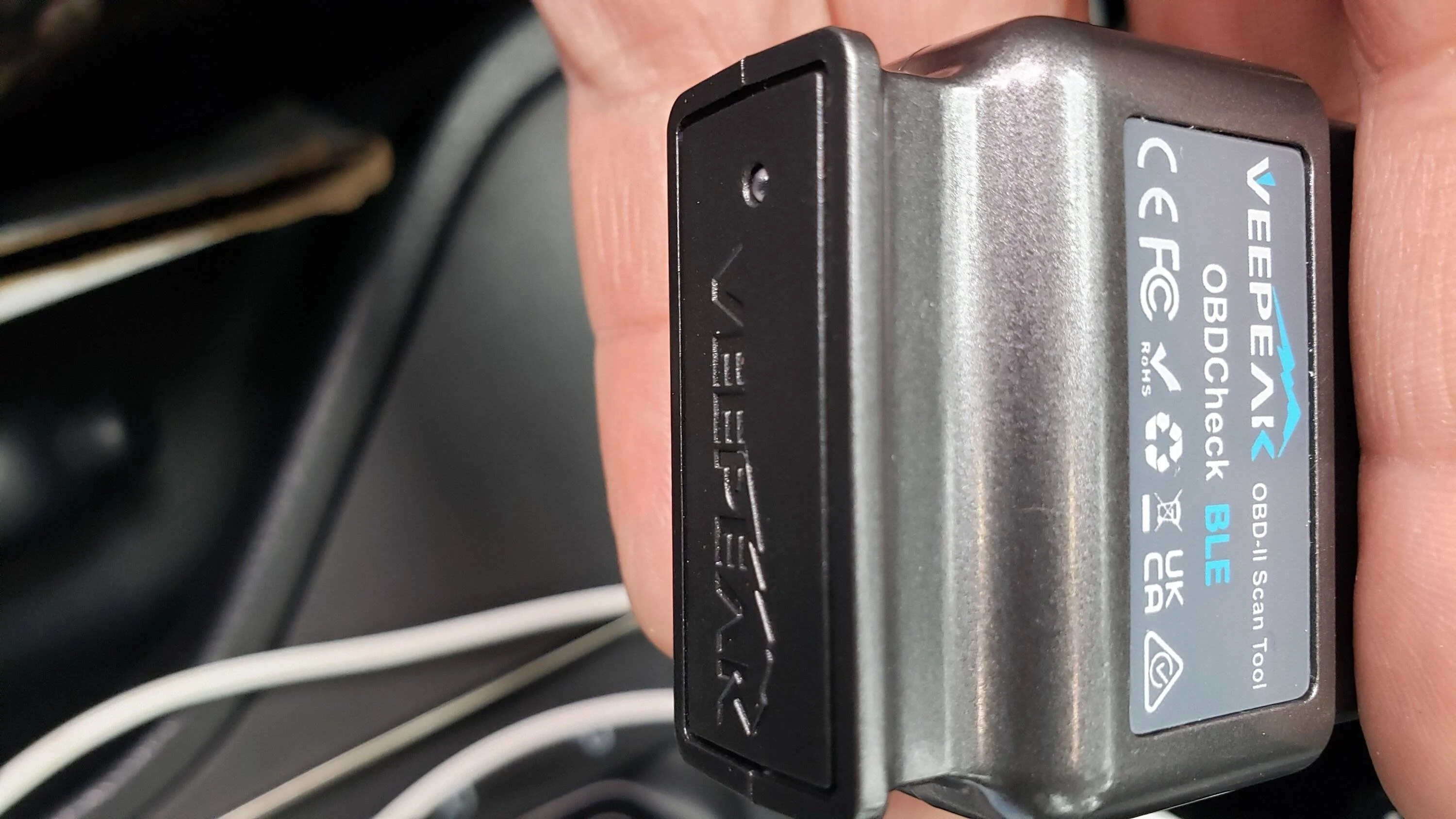

Which one is not available? The dongle or the app?
Thanks, very nice. Does it display boost?

No...unfortunately no boost.

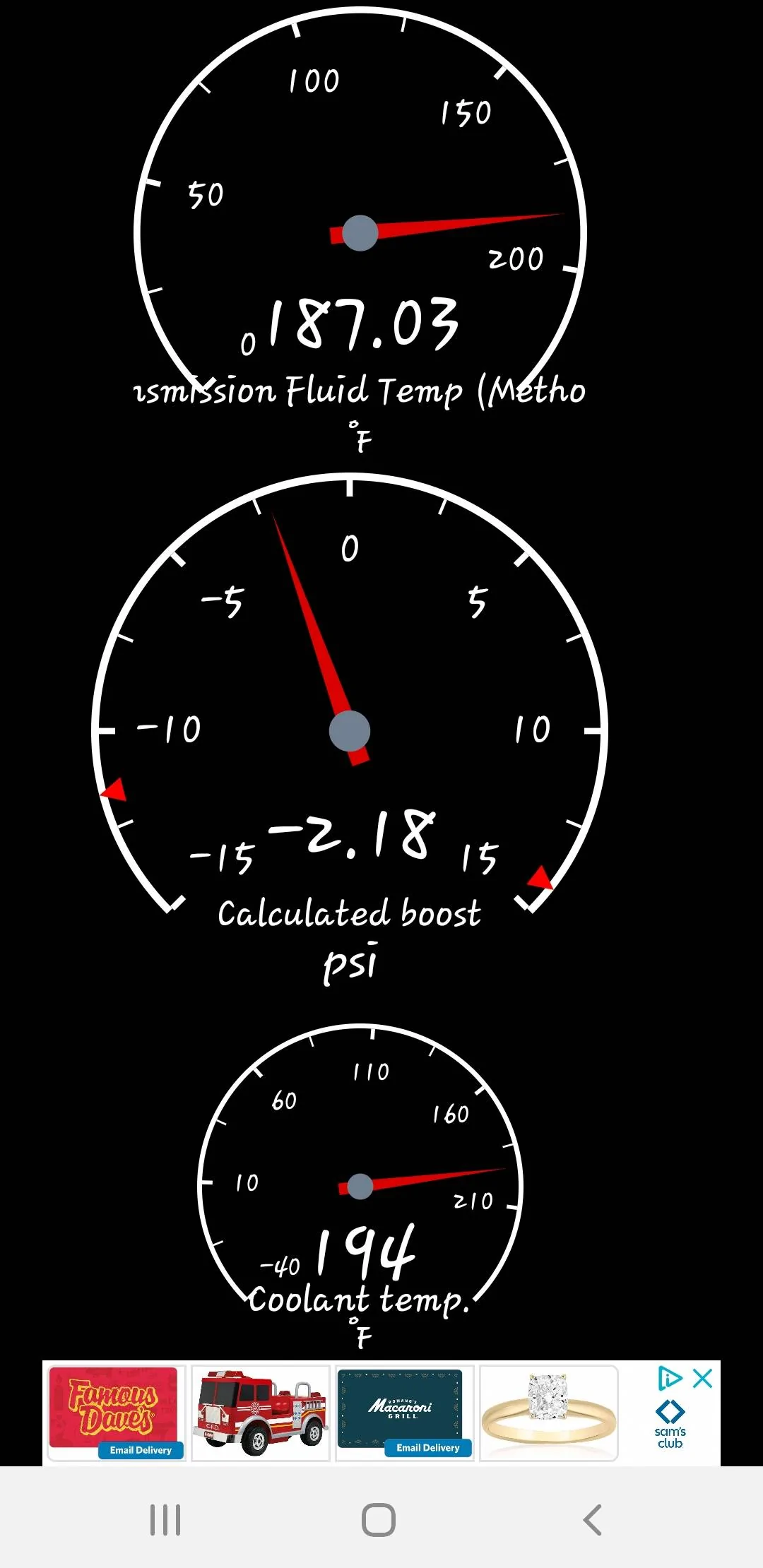

Well, this worked for me!! I am loving it!

Same one I use...great product...
Did you design your own gauge or are you using a different app than mine? I designed mine but use OBDfusion's templates...

I have samsung phone and tablet. I used the car scanner pro app. I had to change the setup a few times with canbus reading and the technical stuff a few times before i found the correct programming pids for the app. I have a very informative screen i want to use for the tablet, but, have to get my homework done first lol. Ill send a screenshot of what i am wanting to put on the tablet. My phone is just to small.
