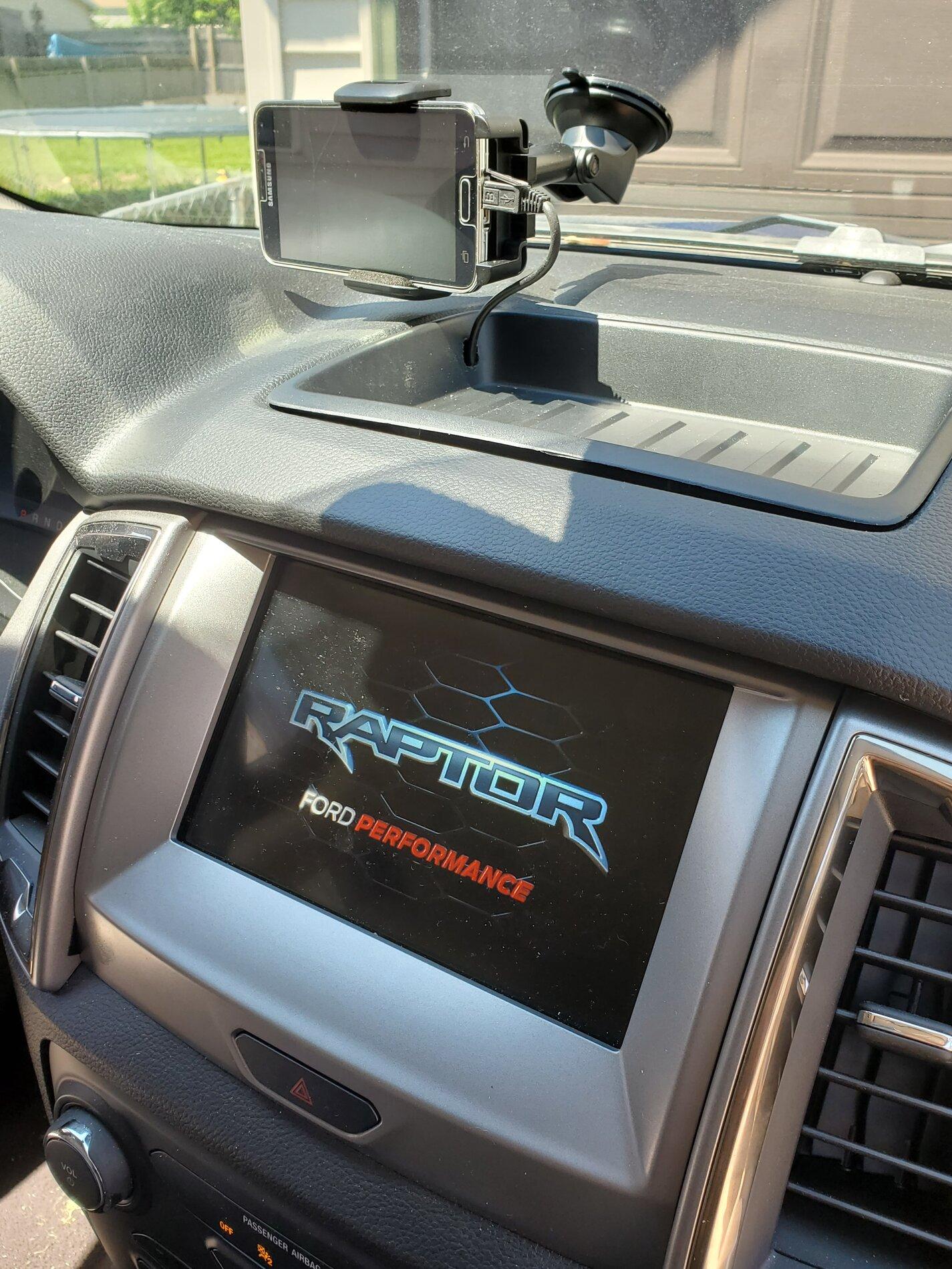

I'm an Android guy, but I'm sure there are apps for IOS that will work also. I use the Torque app on and old Samsung Galaxy phone with a OBDII adaptor to show boost, Coolant temp and Transmission temp. Haven't found the PID loops for the oil pressure, oil temp or transmission fluid temp. Not sure if our trucks have them or not.
Here's a picture of my setup. The USB cable goes down to a USB power port plugged into one of the 12v sockets. Use the factory USBs for Android Auto and my Music USB drive
