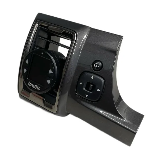

I agree with you there! I do like the idea of it going into a 52mm gauge mount on the air vent though to make it seamless.
I agree it is a clean place to put a gauge, of which there are few in our trucks. But, I feel it is too far out of the drivers sight line to be conveinient. Especially to read numeric gauges.

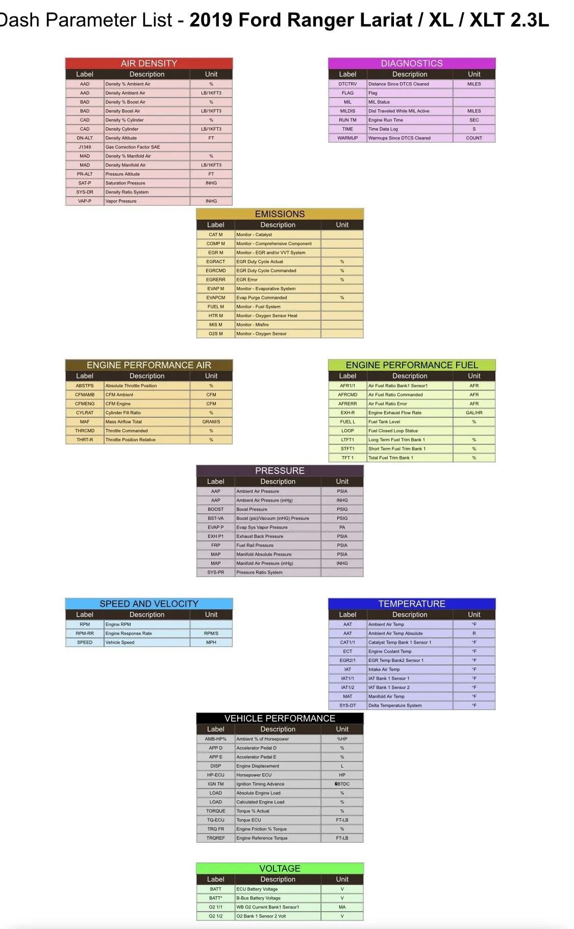

I thought the OBD port would pick that up.
It does but it is not listed in the loops shown for the Ranger on the Banks unit. Unless they let you program user defined PIDs in. I monitor mine using Torque Pro.

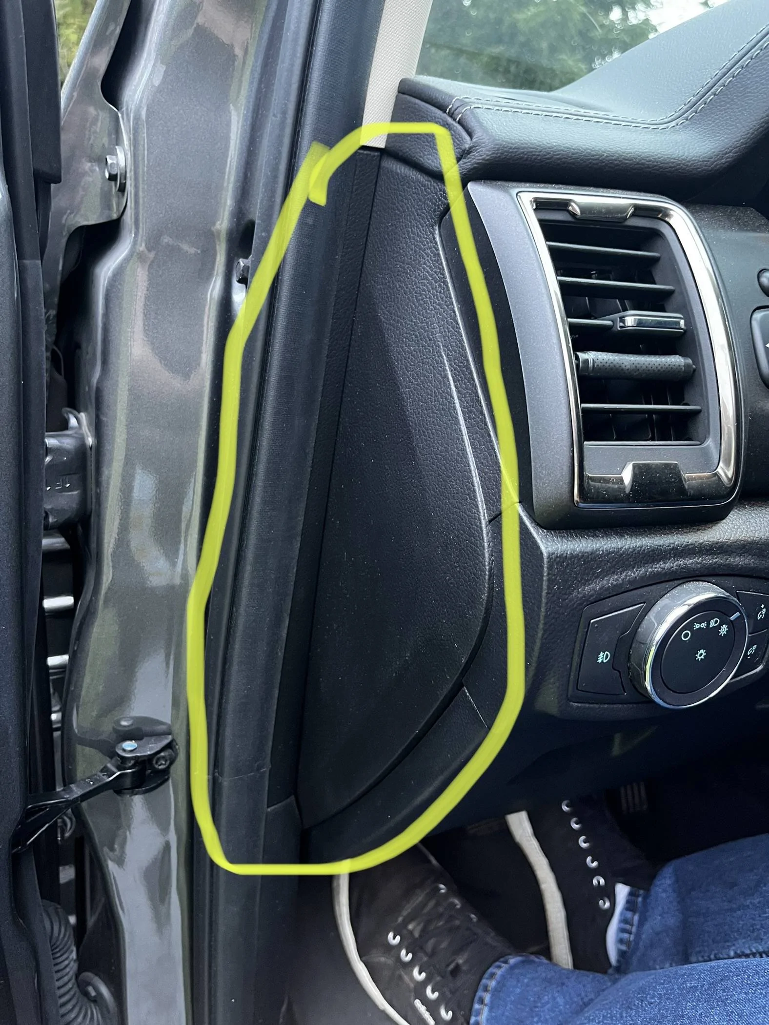

Does anyone have any insight how to remove this dash trim piece?

This is the data the iDash displays. I am going to call Monday to figure out how to get trans temp

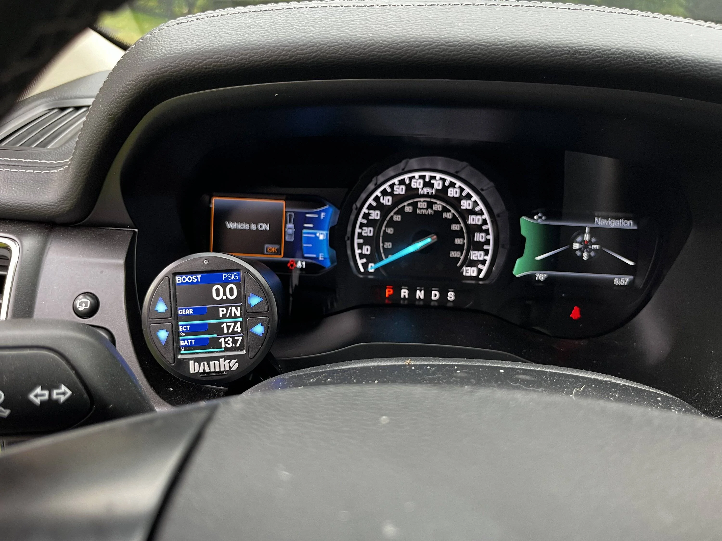

Here is my temporary set up until my gauge pod comes in the mail.

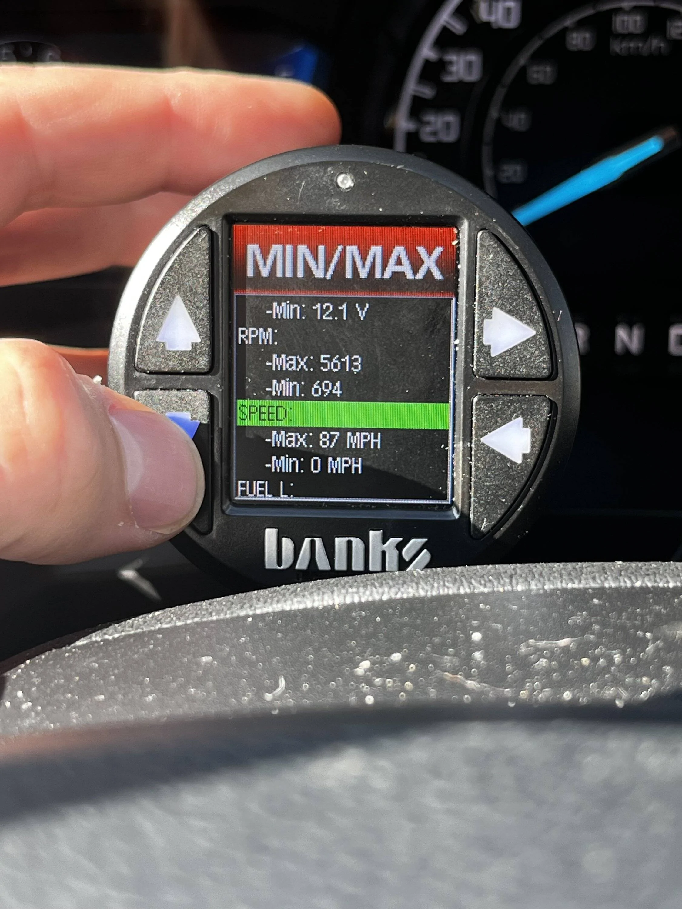

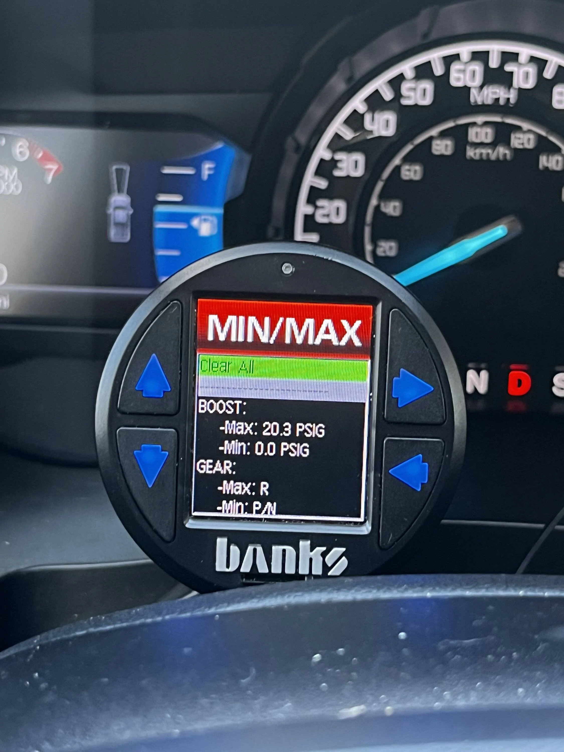

Update. After a few days of driving I wanted to see some of the data captured I have been looking at.
