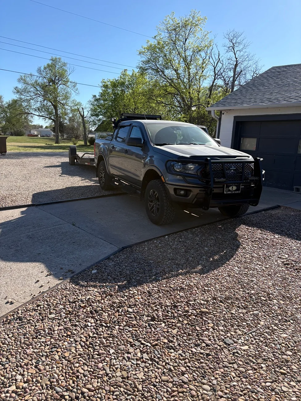

Had that issue couple months ago with car trailer. Electrical grease stopped it next run, then started doing regularly. Dang going to have to do a change out pickup plug, hooked up to camper, doing spring system flush/maintenance, driving around, no issue, so replaced car trailer pig tail. No issues since.
