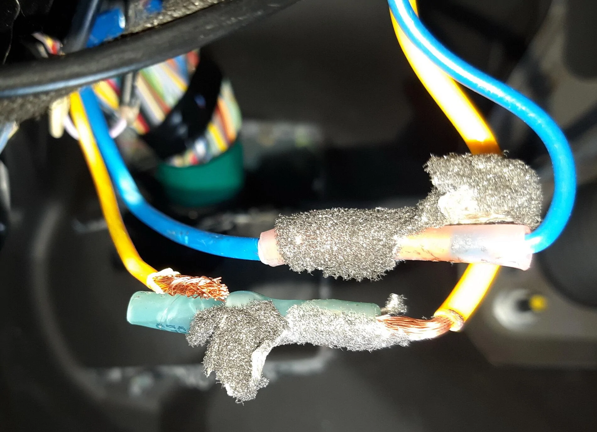

I have been towing with the Ford controller since March and it had been working flawlessly. Then a couple of weeks ago, I felt some wires tickling my toes. When I looked under the dash, I noticed a couple of wires loose and dangerously close to my feet. I pushed them back up out of the way and zip-tied them to keep them out of the way and forgot about it.
A week later, we were leaving on a 1,700 mile vacation. After connecting the trailer, I noticed that the controller was flashing green & red, and that the trailer brakes were on maximum, which made backing out of my somewhat steep driveway difficult. I rushed over my dealer to have them take a look. A lower-level tech who had not yet left came out to look at it. He looked under the dash and fiddled for a moment until the controller went totally dark. Since it was 5, there wasn't anything they could do until sometime the next day, and they suggested I get in the service queue in the morning and they might get to it before the afternoon. My fear was that the controller had cooked and that would be the end of our vacation before it even started.So I went back home to investigate. I found that the wires that had come loose were the power connections, and that one of the wires was loose in the compression connectors they had used. I discarded the connector, soldered the wires and insulated with shrink tube. Problem permanently solved and vacation saved. Only 2 hours lost on our start.
The flashing red-green meant that the controller was in "calibration mode", as if it was just installed (or battery reconnected) and is something you don't normally do with the trailer connected. Every time the power connection intermittently failed, the controller would fall back to calibration mode as if it has just been installed, and the trailer brakes are applied with maximum force as a safety fallback. After a few miles of driving, the unit achieved confidence in its orientation and all returned to normal.
It was fortunate that I discovered this before we left instead of after we were on the highway. We'd be passing through some rather steep highway passes and would would have been quite problematic had the power connection failed while heading down one of them.
