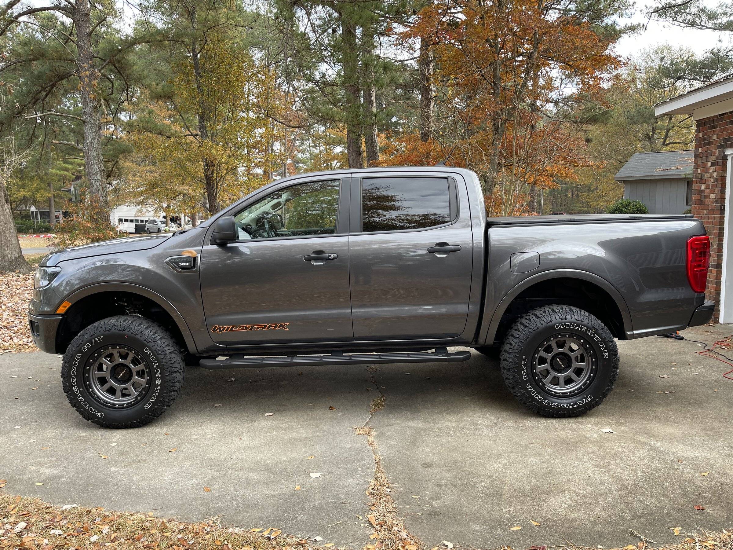

I have a 3.5 inch lift with proper coilovers, UCA’s 33’s and an aggressive offset. Other than removing my crash bars, I don’t have any rubbing. A cheap 6 inch lift simply lifts the truck and offers no benefit of more articulation. It also looks ridiculous unless you run 35’s and aggressive wheel offset. And don’t run 20’s, 22’s etc…. 17 or 18 inch wheels look best and ride best.
