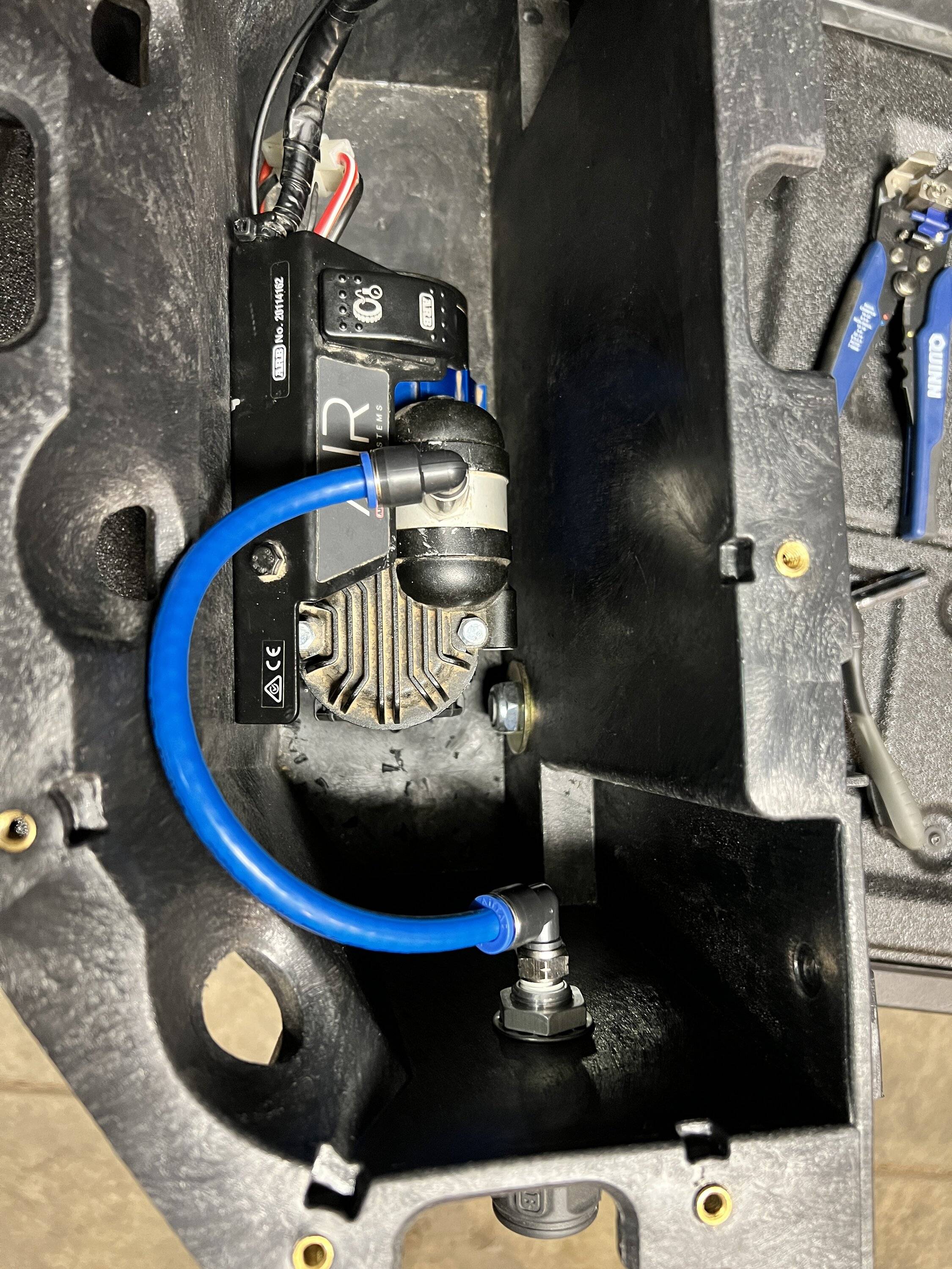

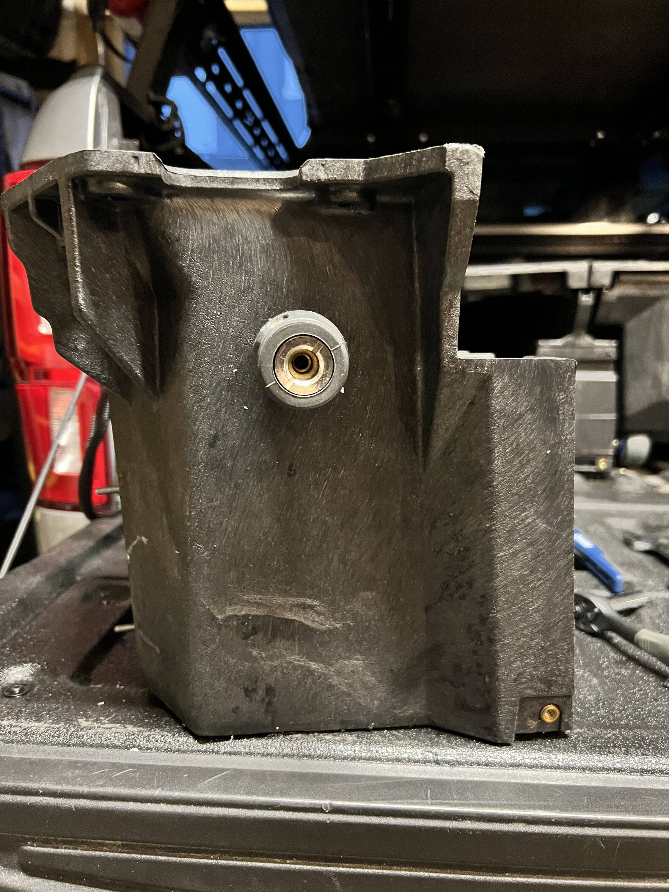

I moved the ARB single air compressor from the engine bay to the Decked ammo can. I used the Power Trays ARB chuck relocation kit to run the compressor to the outside of the ammo can. I can run the setup with the lid on.

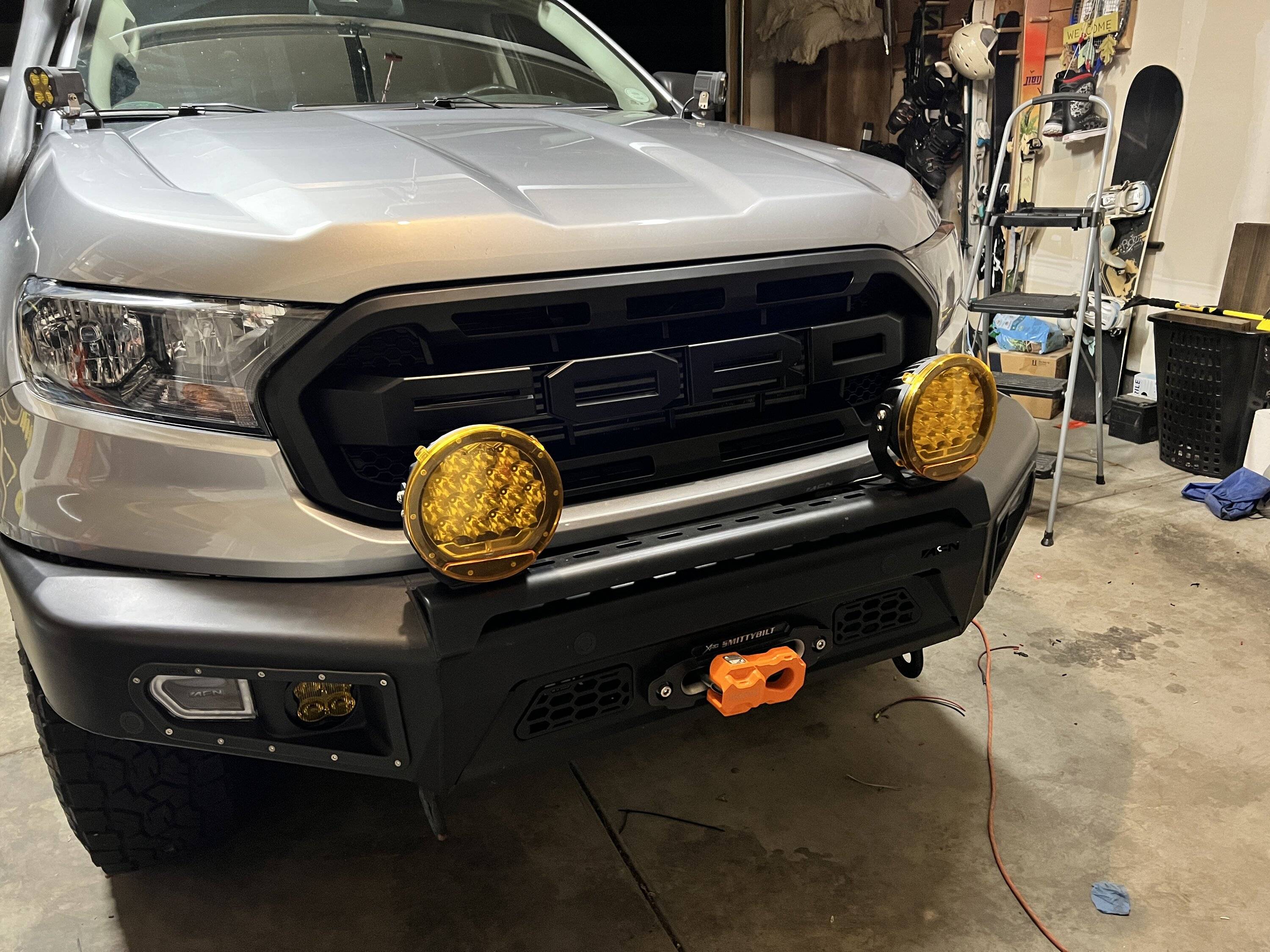

I knew after the last time I had the grille off that the next time would be my last. I did a *ridiculous* amount of wiring on the truck and had to remove the grille. Replaced with a Raptor grille.
Below is the best way to show what I did. The video sucks, but its not that long. I installed the LightForce facia with CH4x4 switches. It looks super clean in person.

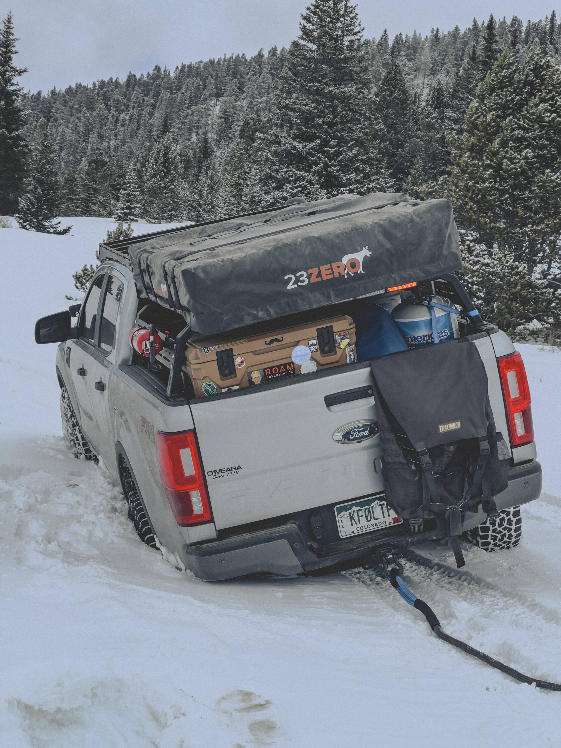

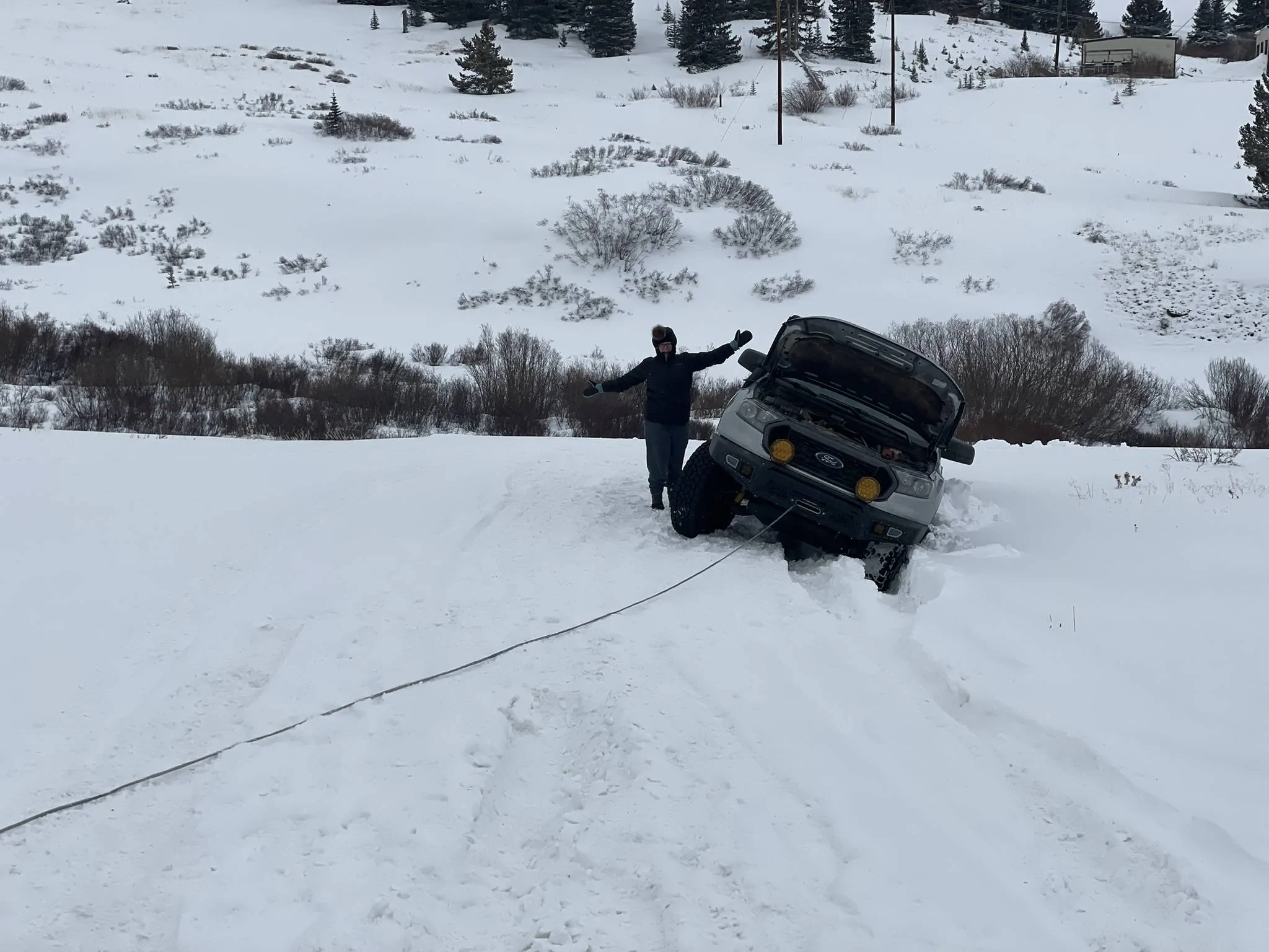

Went camping with @AndyMedic a couple weeks ago. It was a short trip because it snowed and my wife wasn't having it...
We tried to run a trail in the morning. Did not go well. You can see in the first picture (below) that the snow is almost to the driver mirror. I got stuck twice. Once Andy could pull me out, once I had to winch. We made it ~1/4 mile into the trail before we turned around and went home.
