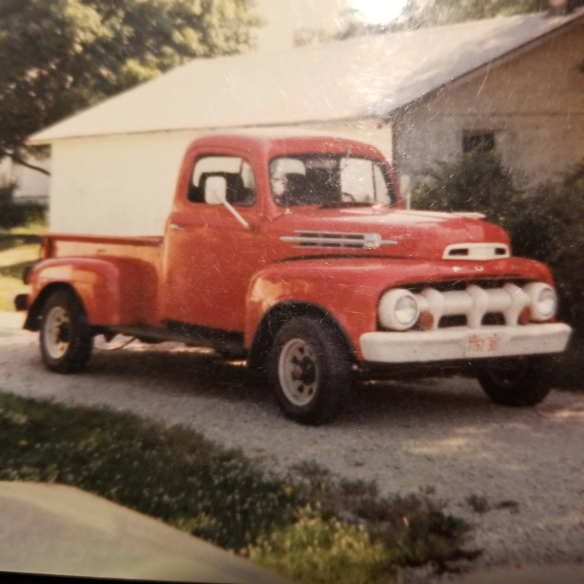

Also... LOVE your F1 ! I built one that looked like it on an Econoline chassis.

Nice "F1" That is impressive work! Looks really well done! Do you still have it?!

My Econoline 300 I-6 got totaled, so I took it home and built the F-1 on the Econoline Chassis..
I only spent $500 and about 6 weeks to build it. the hardest part was the steering since the F-1 Cab set a good bit further back on the chassis. The Econoline column was gutted , then the tube expanded, the guts from a Pinto column were then installed in it , the the compound U-joint from an Escort column was attached after being sectioned with a '65 Mustang steering shaft grafted in, then it was attached to the stock steering box... WHEW! Worked Perfect, looked pro!
I drove it for a few years then sold it.
