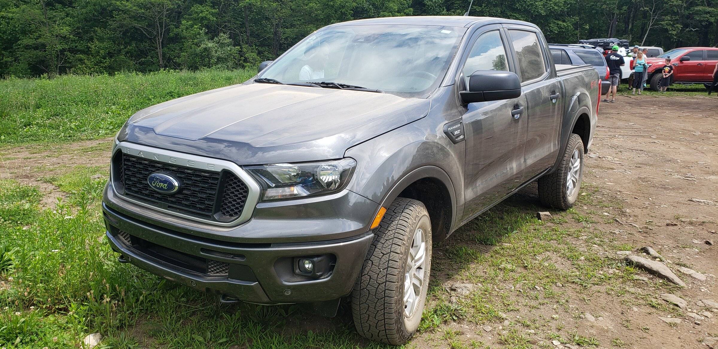

I know you wrote that you're not in 4-wheeling, but I highly suggest you get out once with a group to see what your truck's capabilities are. If you're anything like me, the bug will bite you and you'll enjoy getting out and wheeling the Ranger! I became immensely impressed with the capabilities as I've been out and I'm learning too.
First trip out 4-wheeling the Ranger on 6/14/2020:
Last trip out 4-wheeling on 10/18/2021:
Can you tell I was bit by the bug? ?
