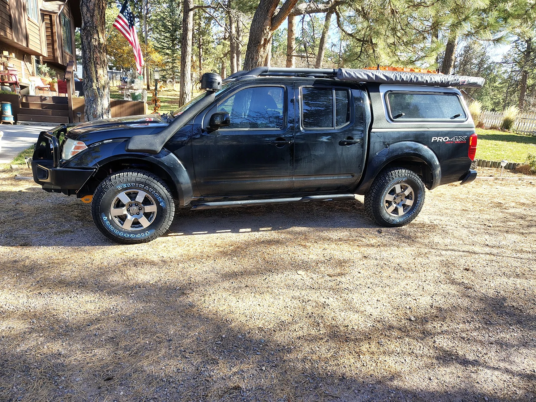

Here is the old Ranger I had
Here is the Frontier I have. It easily crawls through snow with no questions.
