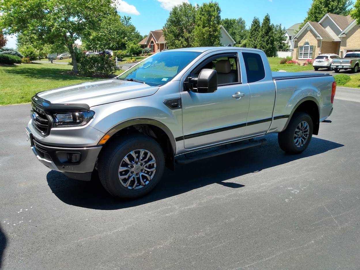

I decided to get a bottle and try it out. I'm pleased, it was very easy to use. I used it on everything, paint, trim, moldings and glass. Everything feels slick! My Ranger makes this product look good! Did I say that right? Ha-Ha

It does work good. Just did a quick touch up on mine before our road trip. Really like it what it does for the glass. Makes rain-x worthless, which it was pretty much anyway. Nice posters!!

Thanks! I'm anxious to see how well it sheds water.

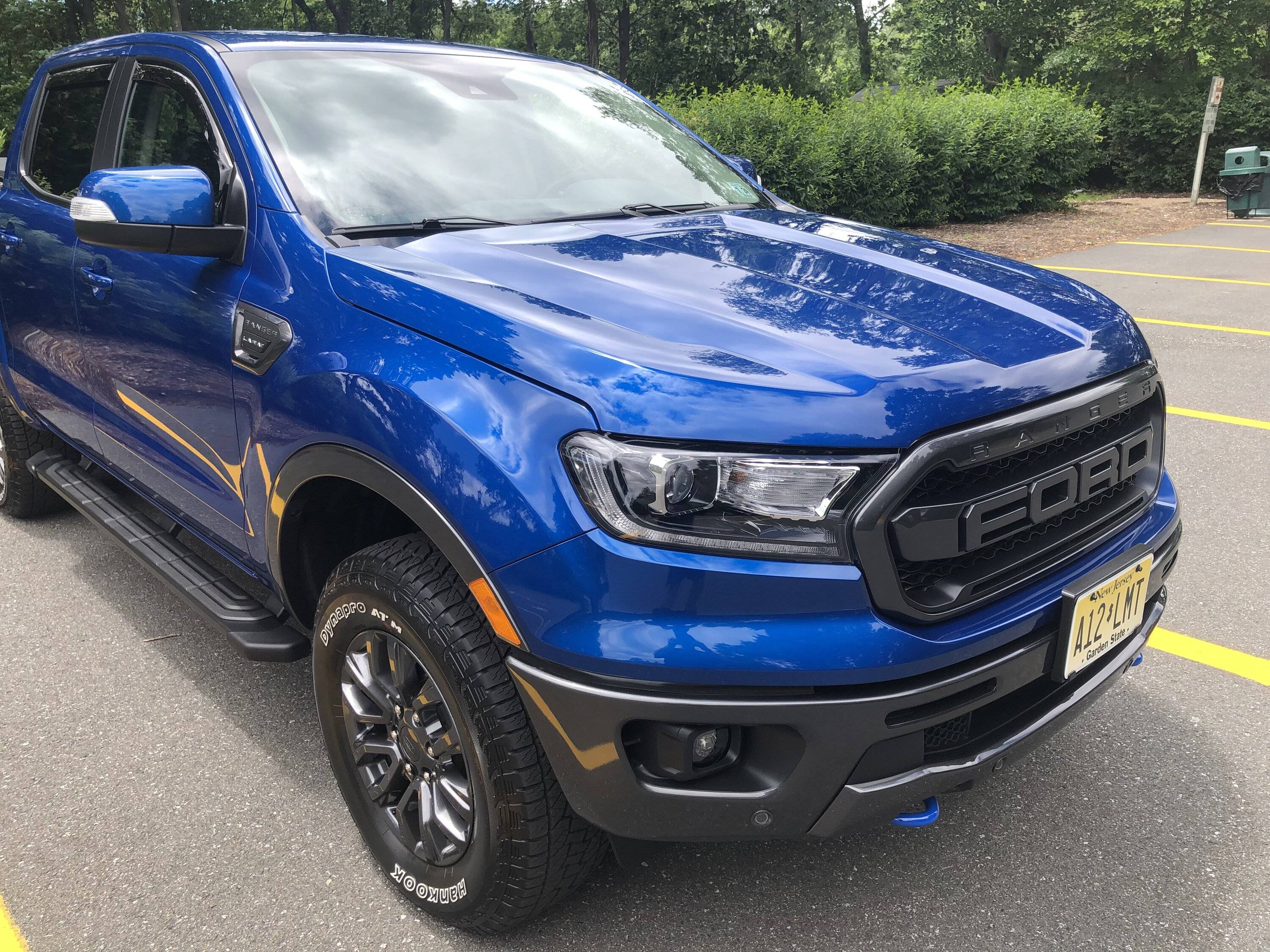

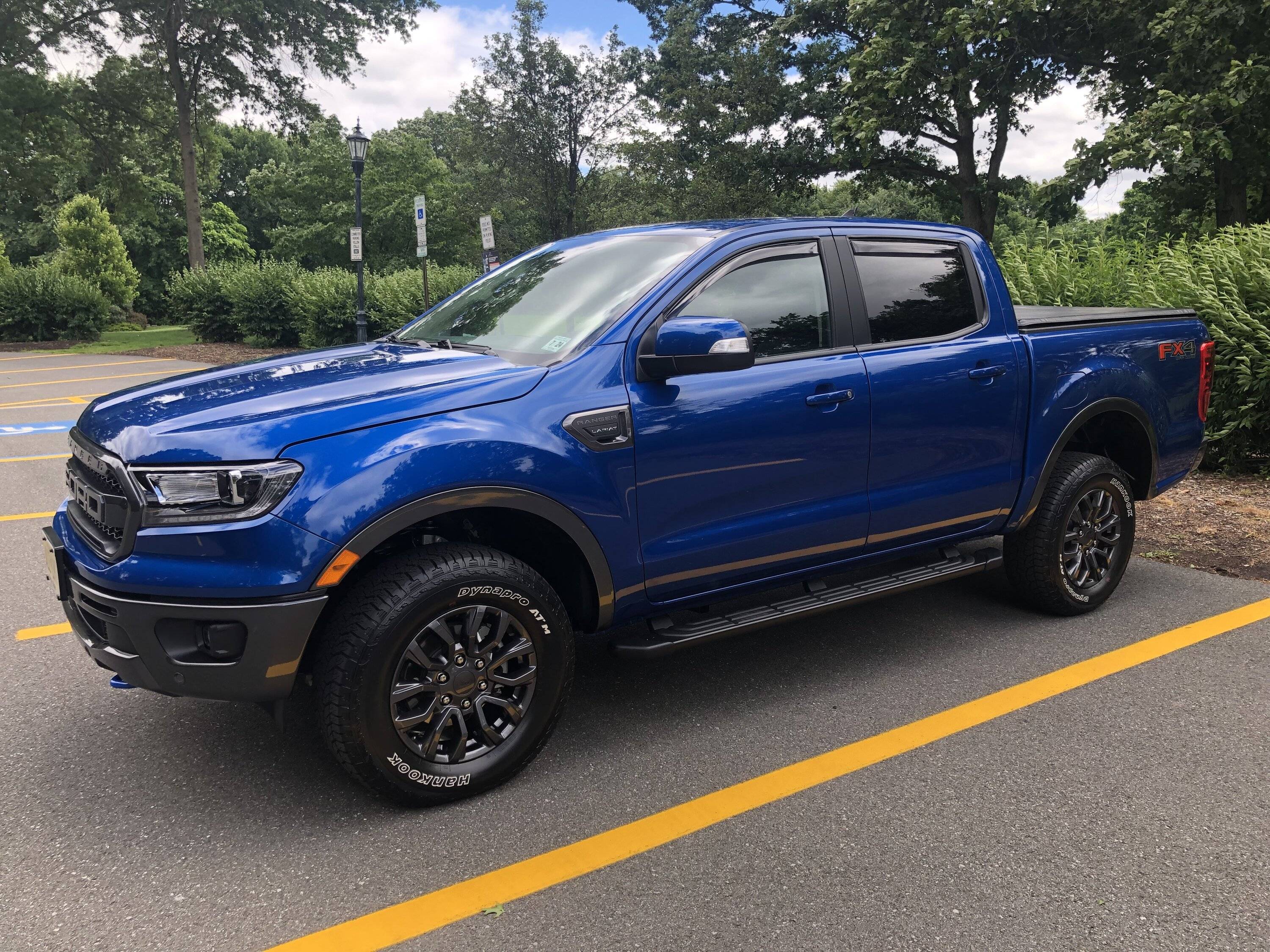

Coming from being a big Carpro fan and ceramic coatings, I decided to give this a try. I dont know if my coating contributed anything to the shine but I did it almost 3 years ago. So I purchased the bundle pack that included the detail spray and microfiber towels. First I foamed and washed the truck with Chemical guys citrus wash to strip what was on the paint. Then I used Carpro IronX for chemical decontamination, then I used Autoscrub clay mitt with ONR as a lube and car shampoo. Then one last wash. Once dry I went over it with Carpro eraser to clean and prep the paint. I usually do a light polishing with my flex but skipped it this time. For the coacting, I did 2 coats, first I started out with 5 sprays on a microfiber pad and it was very sticky and hard to remove.. once I dialed it in to 2 sprays on the pad each time it got easier. A day later I applied one coat of the detail spray, I sprayed 2 pumps into a microfiber towel and did 1 panel at a time. Well my thoughts on this product. It’s pretty Amazing! I was skeptical but this stuff brought out the blue in my truck that ive never seen before, its much deeper and richer looking With TONS of gloss. Also went over all the black plastic and running boards. Thank you to @AzScorpion for drilling this into our heads Lol Dave you have a winner here. I recommend everyone at lest give it a try. If there’s anything I’d do different is maybe go the extra step and do a light polishing. Detail spray is excellent. Microfibers are very nice I recommend washing them first. Picture’s were taken with an iPhone 8 NO filters. It pops that much.

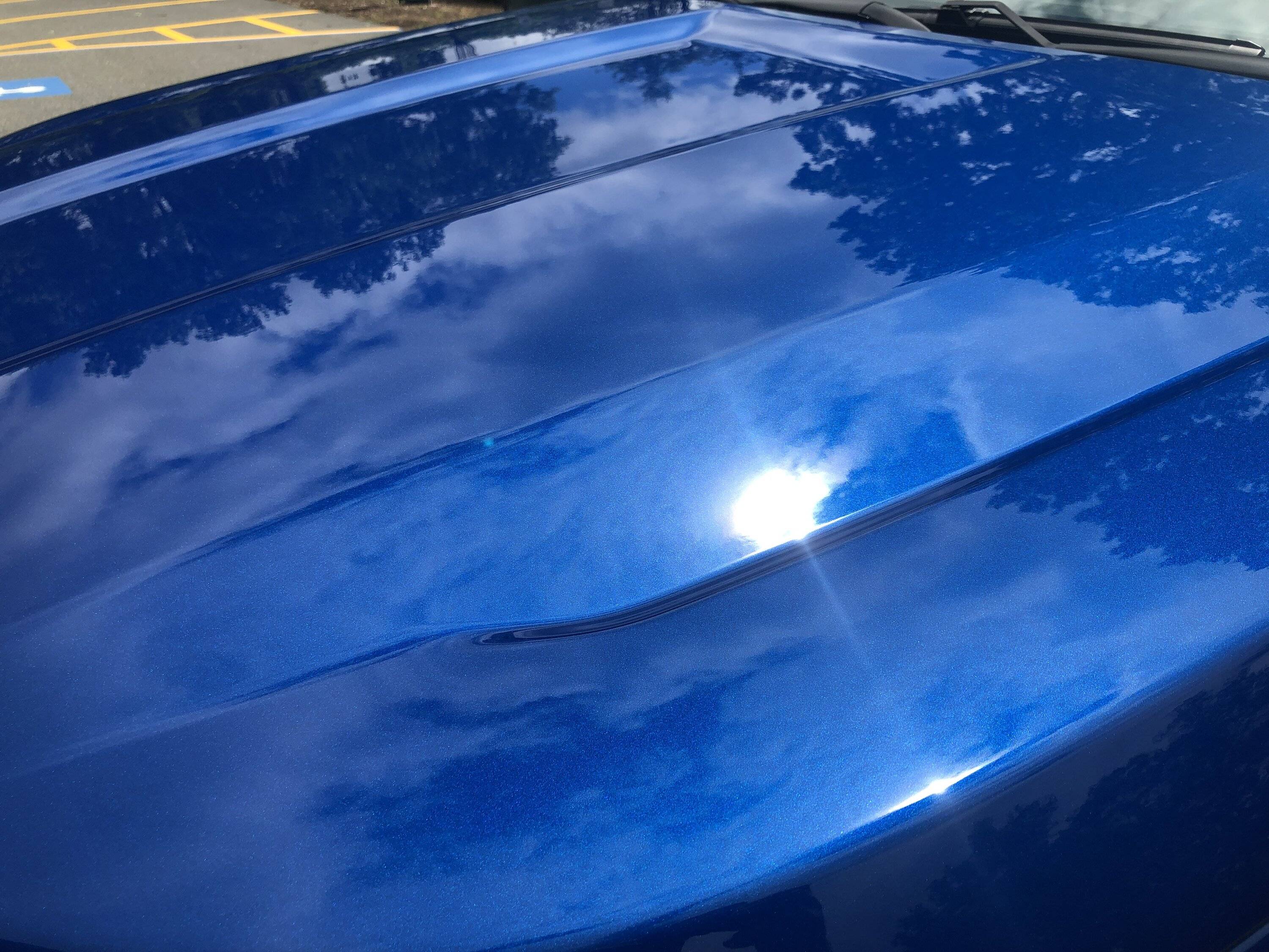

This is mine, done today. I give it a coat every 3 months or so, and use the detailer every couple of weeks in-between.
One thing to remember is that when using the detailer, use it after a wash and thoroughly dry your truck. The detailer will bring back/keep up the shine and coating, but it does not remove water spots. If you wash and don't dry, and water spots occur, the detailer will not take em off.
It's strictly a detailer...no cleaners in it.

Wow Tony your Ranger looks great!!? I'm glad you were happy with it and it does work great over other products, I love the depth of the blue.:like:

Thanks Dave, If you do a little bit of prep the stuff is pretty amazing. It actually looks like “Lightning Blue” now. Everyone should give it a try especially at its affordable price point. ?

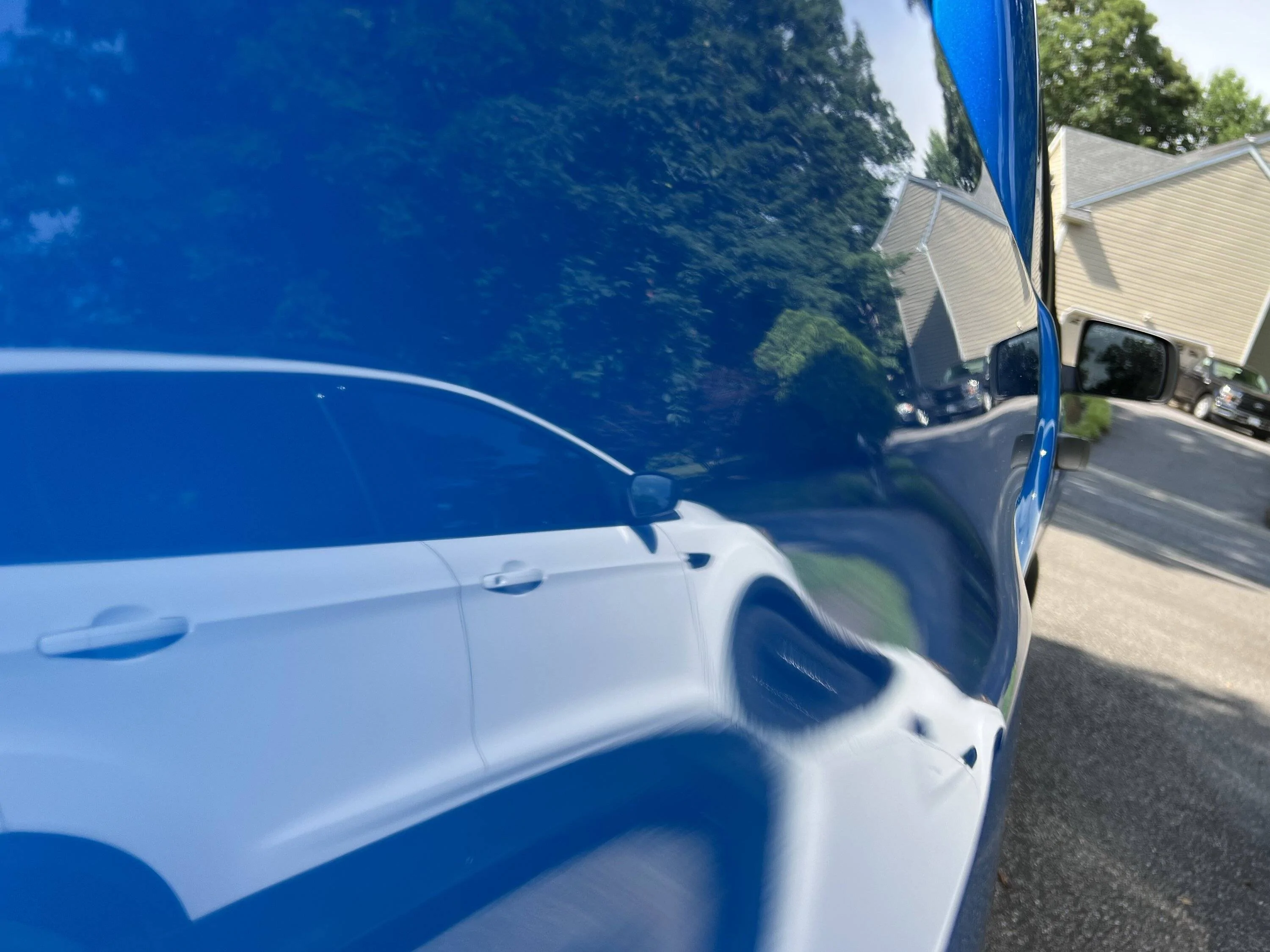

As soon as I put this stuff on a random rain storm appeared..... It seems because I tried to clean a black truck. No rain was forecast.....
So... How will it look when dry..
So far. Better than it normally does after it rains.
