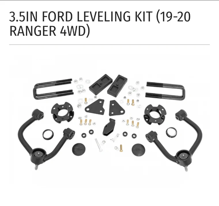

3 1/2 l" leveling kit!

If I get these then 285's would be no problem?

I have the exact same lift but my 285/70/17 BF Goodrich KO2 are on the factory rims with 1.5 inch spacers. I did swap out the intrusion bars but did not have too.

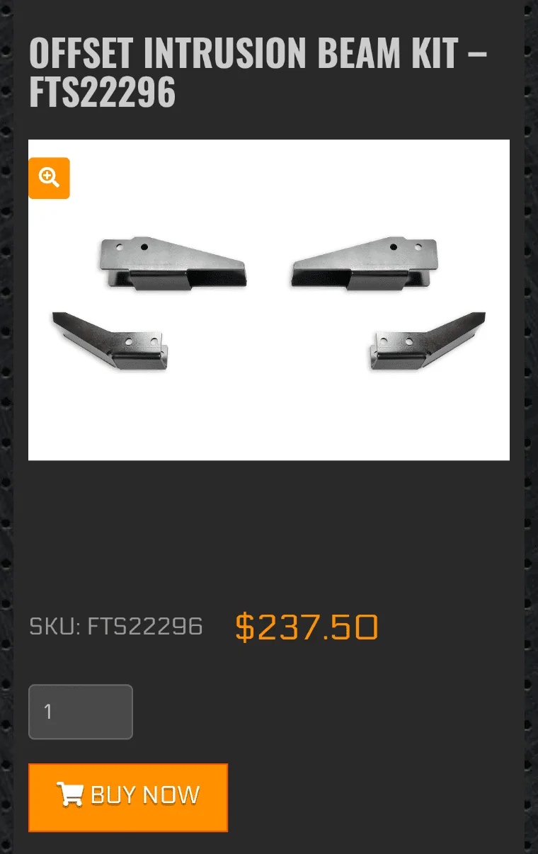

Ah, nothing’s a guarantee but those would likely be necessary. You might not rub on the street but at full lock and full compression while off-roading, or if braking hard into a corner, you’ll have the extra room those bars provide.

I'm running 285/65/18's with +30mm offset and a 3" spacer/leveling kit. I had to swap out intrusion beams due to a full lock rub. I only had to do the fronts. +30 wheels clear the knuckles with 1" of space and set my wheels right at the fender lip. However I did add mud guards due to the trash being thrown down the sides from to the way the body panels roll inward.

thinking if going with these. But save the rears. Can't buy them seperately. I see everyone cutting there's out. I don't think that's a good idea, they're there for a reason. Don't need my front wheel coming thru the firewall and sitting in my lap if someone veers over the middle line.
