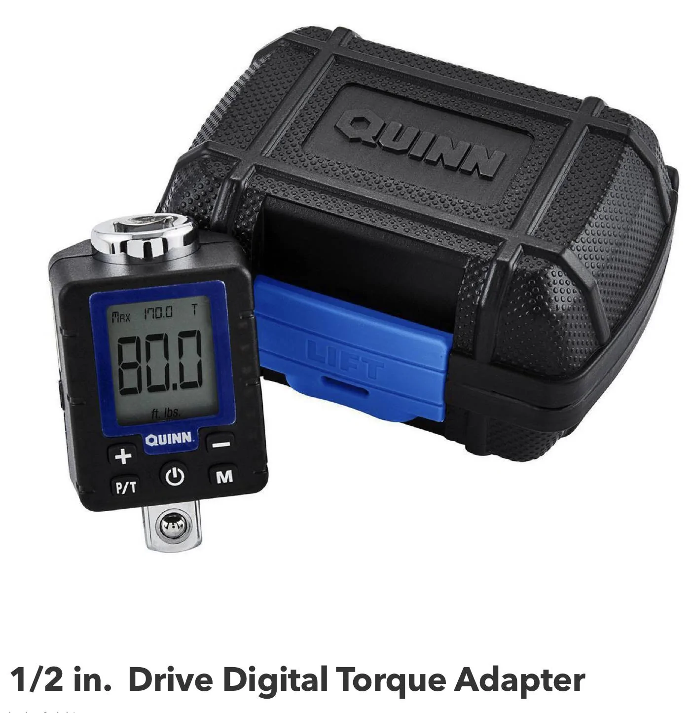

I stumbled on an ad for this, or more likely, it found me through all my Googling.
I thought it was an interesting idea and wondered if anyone here had any experience using one and what their thoughts were? I wouldn’t want to rely on it completely and run into a dead battery situation, but it might be handy to have one around. I carry a torque wrench in my truck but not everyone does. Plus, I like gadgets. ?
Good idea or Paperweight?

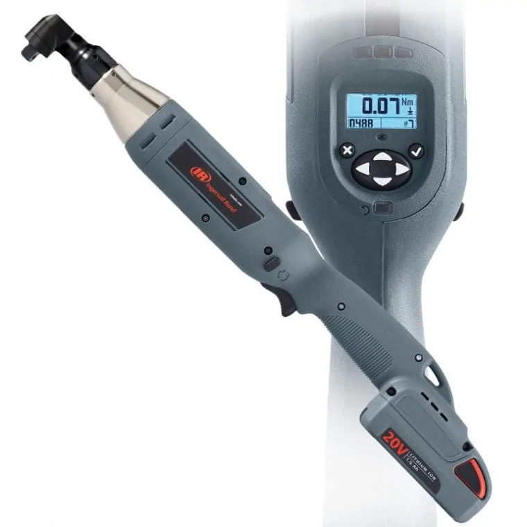

I use digital torque wrenches often. All calibrated for my work.
would be interesting to know how accurate this would be, and if it can be calibrated successfully.
I can see some instances in my work where this could be handy.

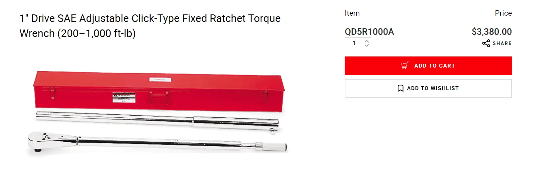

I have this one at my disposal. I didnt have to foot the bill though, the company did.
Thankfully I am man enough, sans damper, to actually use it to its max value without hurting myself.

I have this exact one. Picked it up at Harbor Freight. Fairly inexpensive and gets pretty decent reviews. Seems to be pretty accurate against my standard torque wrench. Use it primarily for lug nuts.
You are the man, and I bow down to you.
I cannot put much more than ~250 ft-lbs on my own wrenches. After that and I fear tearing my hernia repair :)
Although it does look like that wrench has an extension to the handle which probably helps..

FWIW, Hot Rod Magazine did a test on torque wrenches including that Harbor Freight unit. They tested the accuracy and the repeatability over time.
The Harbor Freight unit was the most accurate and was the most repeatable over time of the units they tested which included some high end units from the likes of Snap-On.
FYI, the worst thing you can do to one of the click type torque wrenches is not turn it back down to zero when you are done using. This type of wrench works by loading a spring and over time the spring can/will take a set so when set to a torque you will actually be applying less torque.
Sounds like something to take PRIDE in?
The handle on that wrench looks slippery. Like a Banana!

I've seen those an they won't work for tight areas. I thought they were more for checking you regular torque wrenches.
