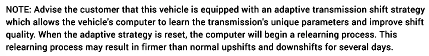

I was in for an oil change today, had 23-2250 applied. I had no codes, so they only did the shift strategy update.
So far, I highly recommend it if you had shift issues.
I know this does not mean I am out of the woods for the CDF drum problem or not, but its a step in the right direction.
Told me to give it some drive time to adapt. Make note of the terminology from 23-2250.
My adaptive has been off for some time apparently due to my tuner disabling it. That may be why I haven't felt any weirdness.

"As far as what we are actually doing to the transmission we are rebuilding the internals with new parts including clutches, seals gaskets and valvebody and will reprogram the transmission control module and relearn shift adaptive, technician will put new fluid in it and test drive several times to make sure the repair is complete. If you have further questions don't hesitate to reach out to me. thanks"
