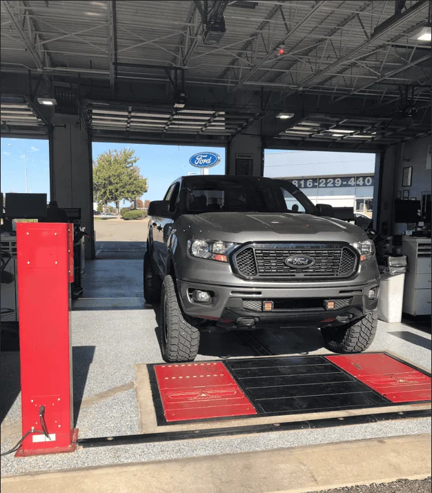

welp mine is now at the dealer for trans issues... mine started getting worse to the point i couldnt rely on it to get me to work anymore and had to borrow a car from a family member hopefully i hear back soon on it like you did and hopefully it doesnt take forever to fix
