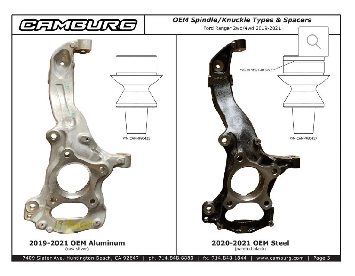

Hi and thank you for your help. Have had my 2022 XLT FX4 now for one week now. I am trying to understand the lift kit differences for a 2021 and older. Please correct me if I’m wrong.………………………..…… On the 2022 the upper control arm is different and the spindle arm is cast iron where I believe the 2021 and older spindle is aluminum…… Is that correct or is there more to it? Thank you again.

It depends. I think all of the 2019 and 2020 had aluminum and after that it was a mix. I know my 2019 did. It only made a difference when I changed my upper control arm, not when I added lifting coilovers.

Thanks......... I'm just trying to understand the 2019 - 2022 differences so I can understand the lift kit differences.

The knuckles changed as others have said. I believe the upper control arms are the same but the taper on the upper ball joint is different for those with cast iron knuckles.
If you’re lifting or levelling without changing your UCAs, no problem. If you’re upgrading UCAs, be mindful of the fitment - it might indicate they’re for 2019-23 Ranger online but not specify aluminum or cast iron knuckle. Also, not all UCA manufacturers make arms for both options and you may be limited in your choices. Most of the big brands seem to have both now.
Of course, not all online resellers carry both options, or even know there’s a difference (“Yeah, no worries Bro’, they’ll fit your truck Dude”). Hmmm, it might be best to stick with folks who make it a point to really know their stuff.
@Stage3Motorsports likely has what you’re looking for and Frank always does his best for ranger5g members, whether it’s a group buy or a deal on shipping or price - and he will likely never call you Bro’ or Dude. ;)

Just found this….. kinda helpful but not for a 2022.
That was likely published before Camburg even knew what Ford was doing in 2022. Go to a Ford dealer parts site and find the part number for a 2021 steel and a 2022 steel. 99.9% sure they’ll be the same. Then you’ll know for sure.
