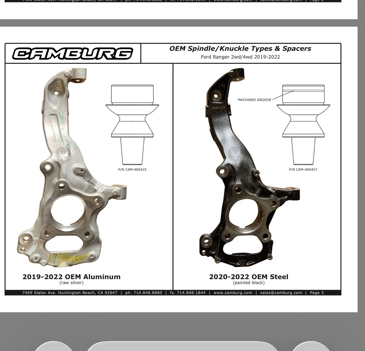

Other than 2 different materials what is the difference? Anyone?

So besides the cost is less why is the upper control arms different steel to aluminum, different ball joint taper or?
2 Different Lower Control Arms and Ball Joints, they will not interchange from what I gather from other posts - having issues installing then realize they have wrong part number due to the spindle difference.
