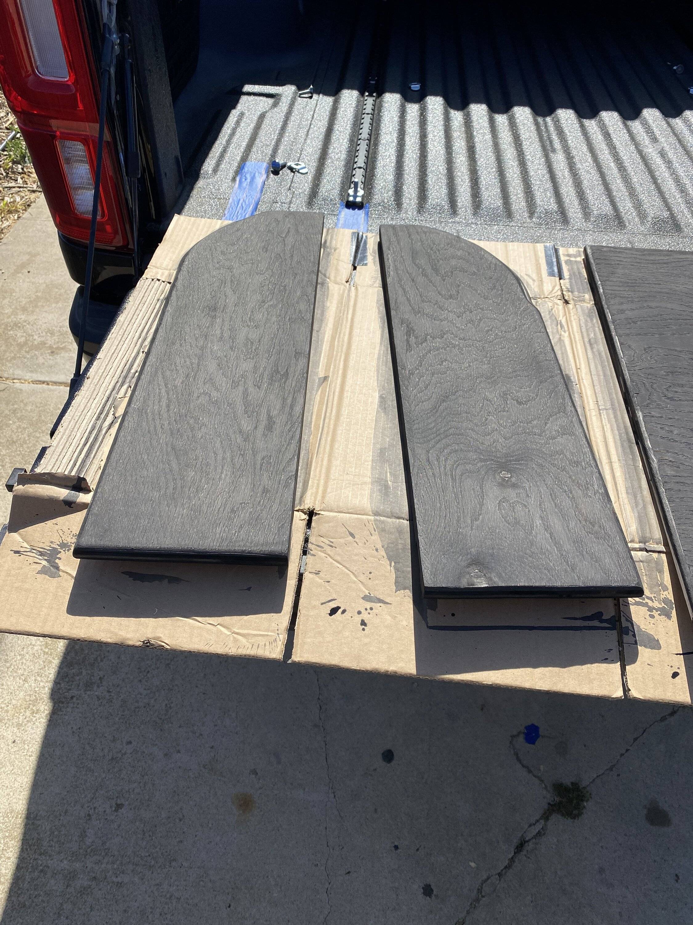

I dont do built journals but i figured this would be a good place drop all my mod photos. If anyone has questions about the build hit me up.
this first will he a photo drop then ill update as i go.

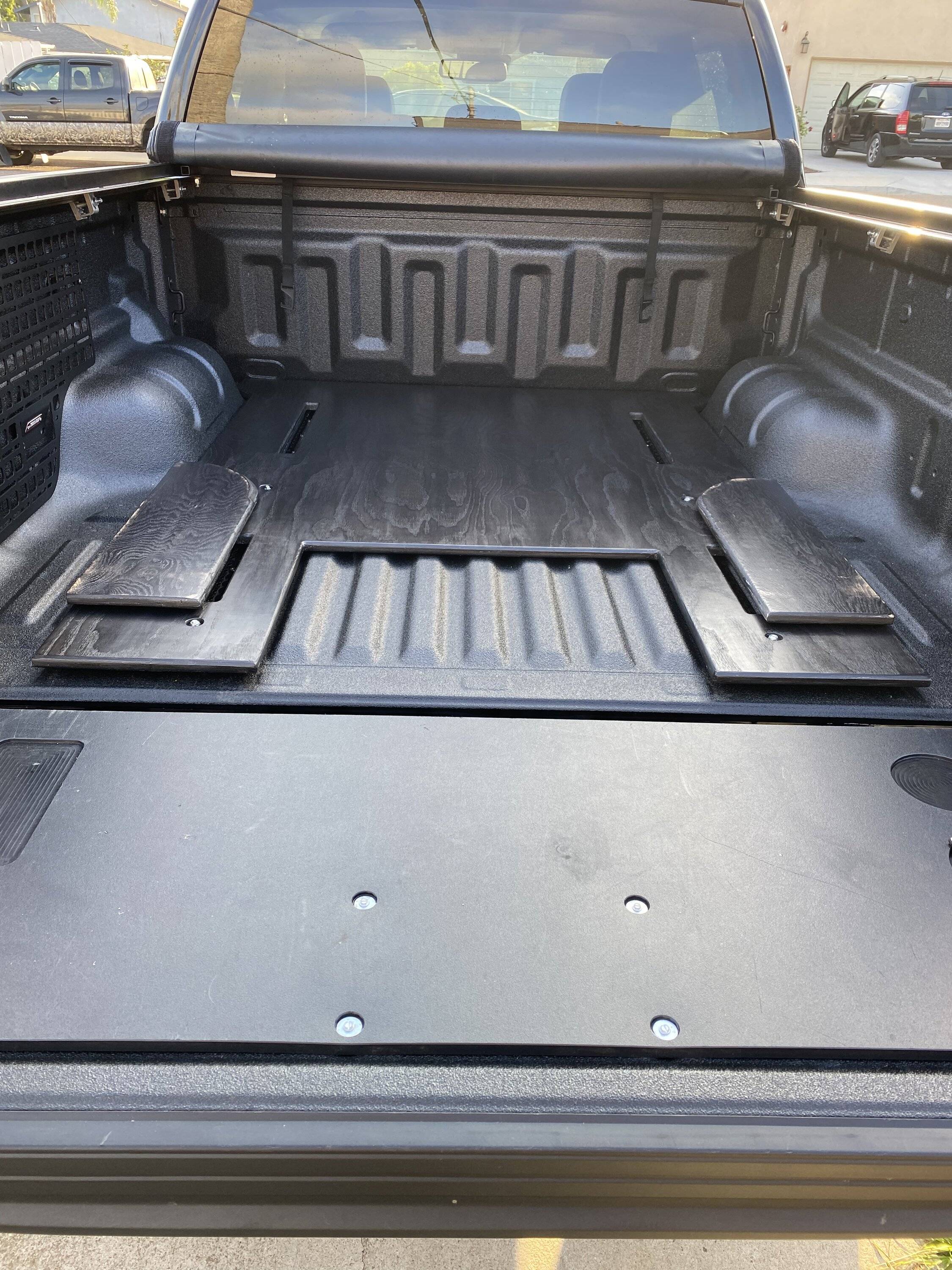

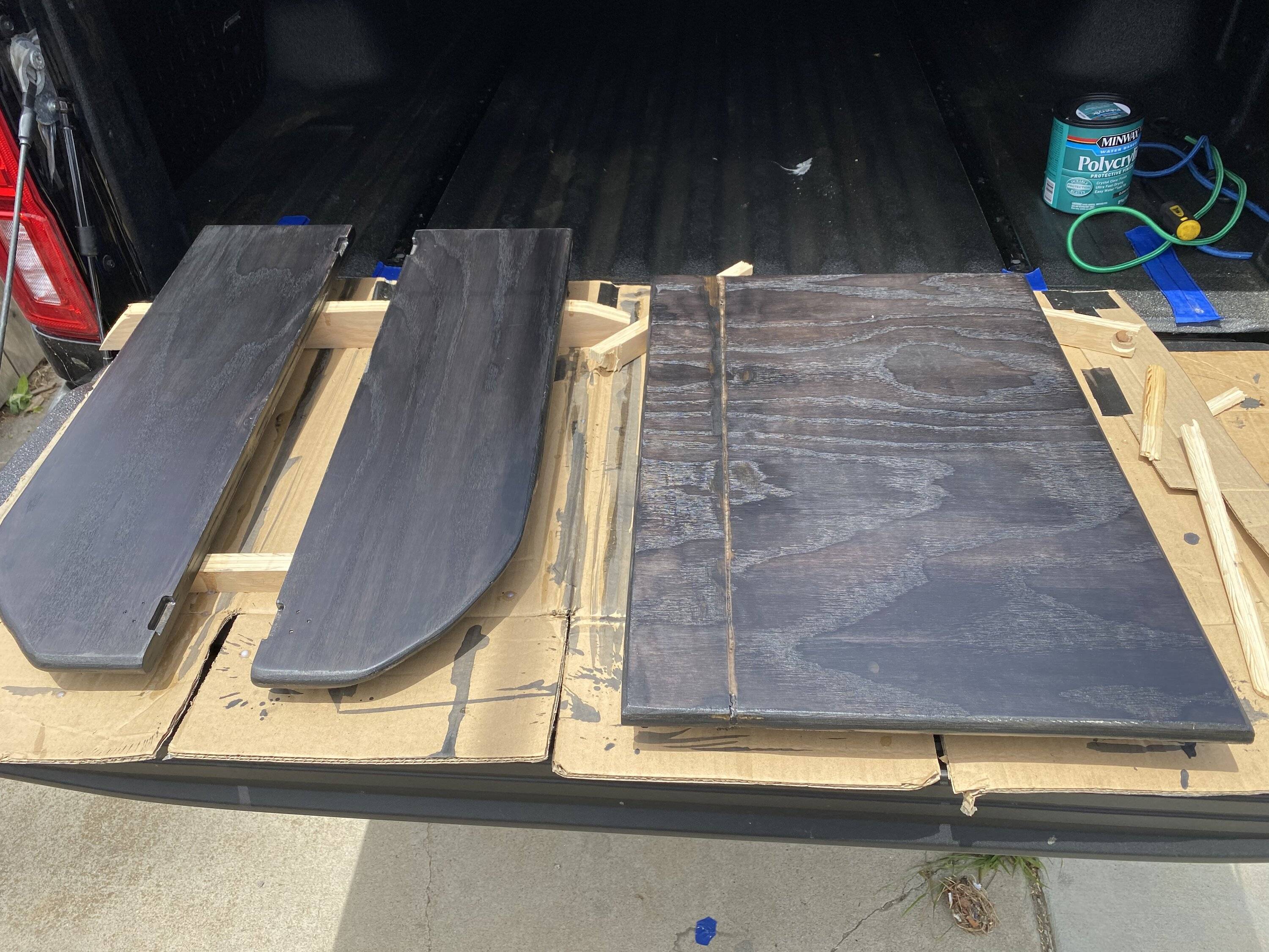

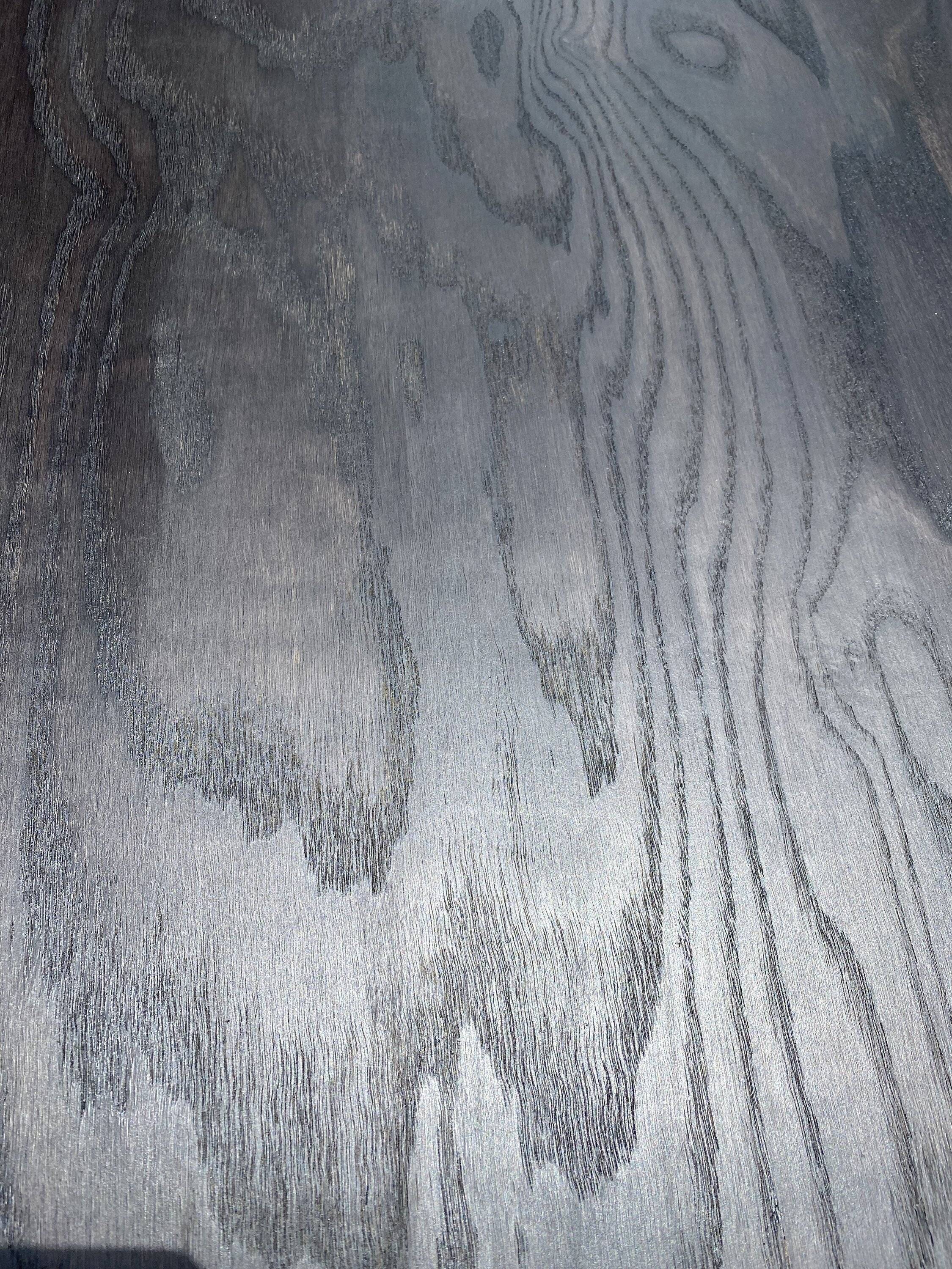

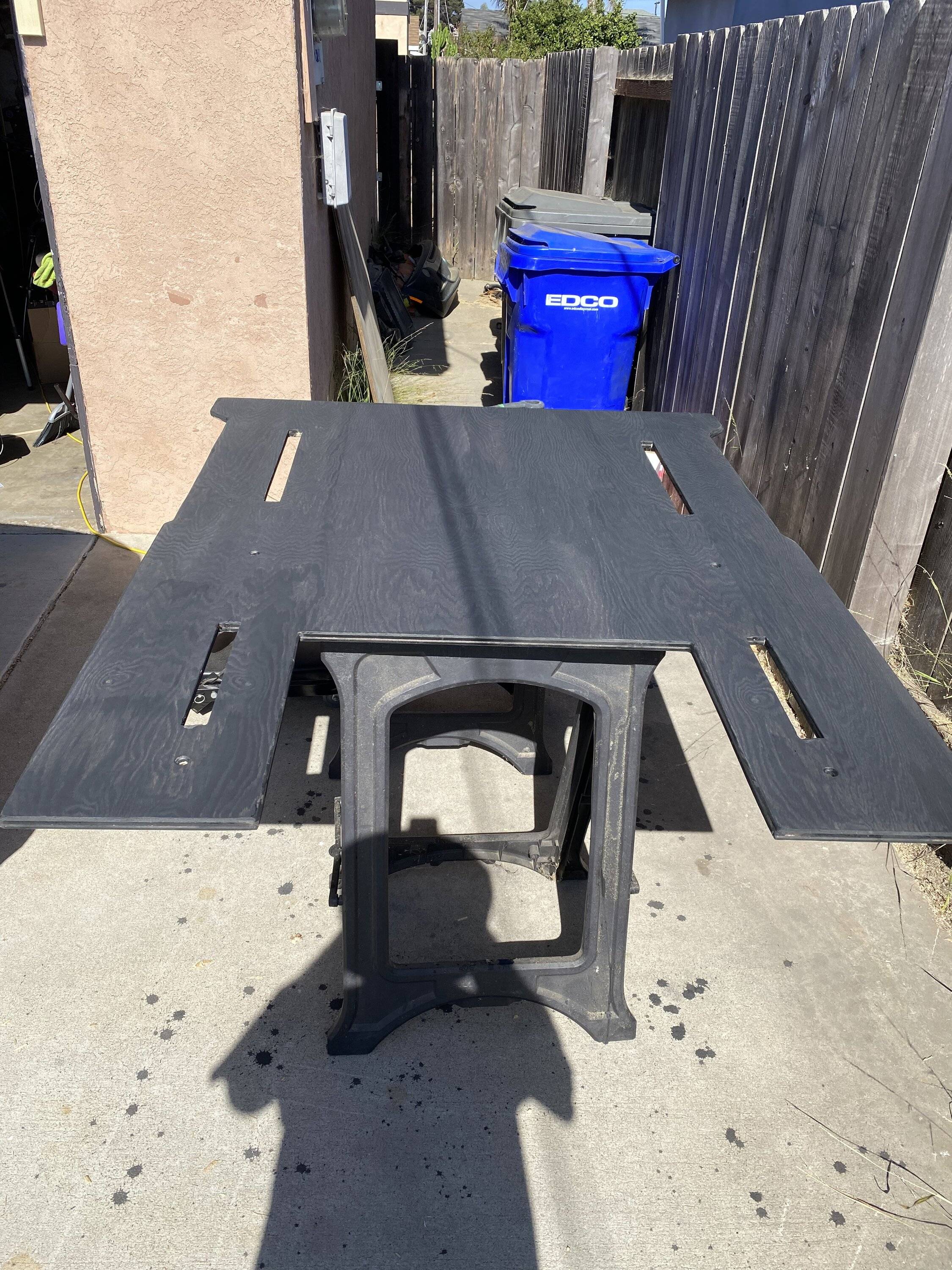

Looking great! And I love that I've got the exact same truck so I get to see some things as though I've already installed them.

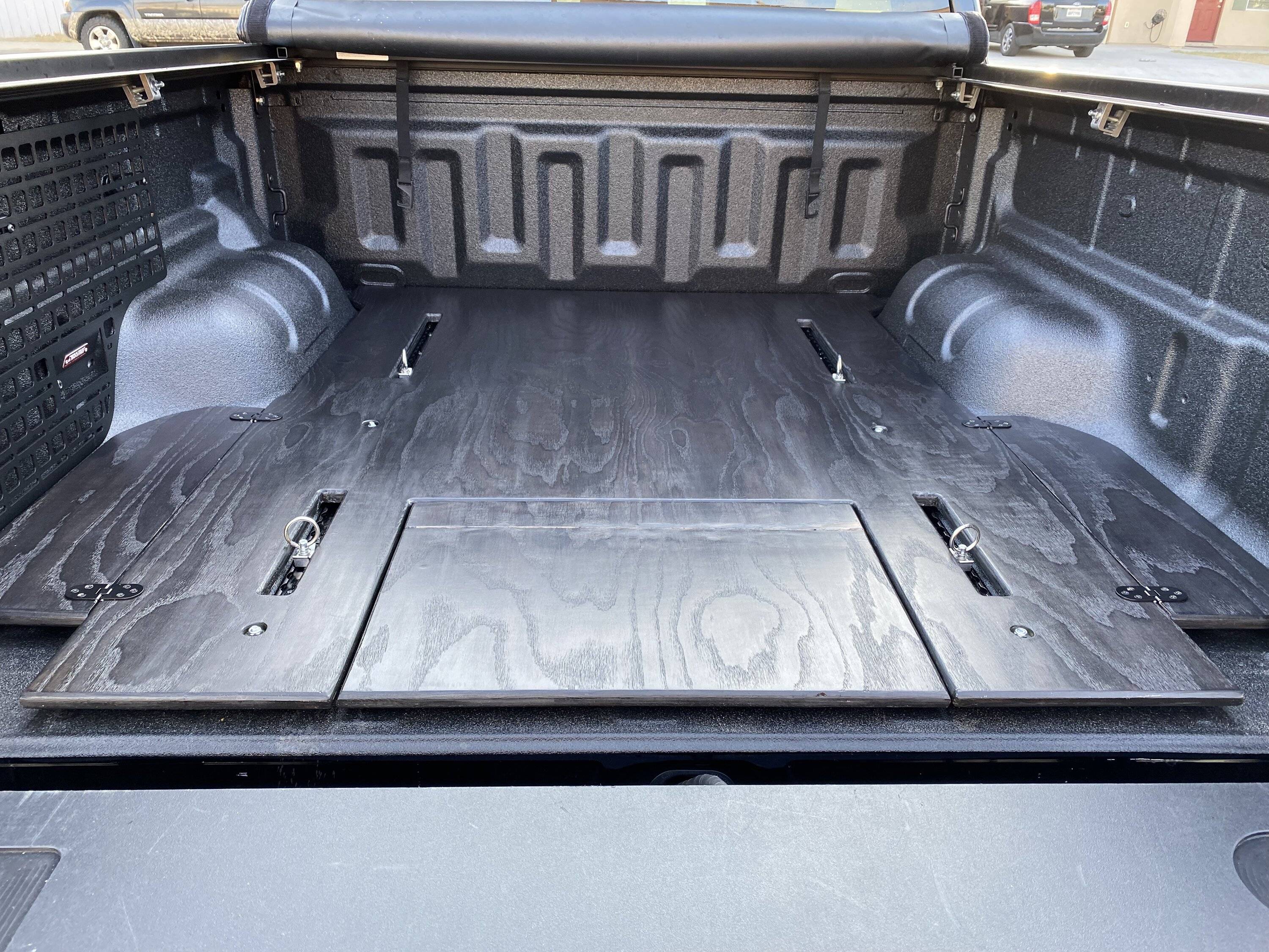

Love the wood deck... if you're looking to make it more durable, Raptor coat it. Adheres to wood fantastically and really toughen it up. And it looks great and will match your bed.

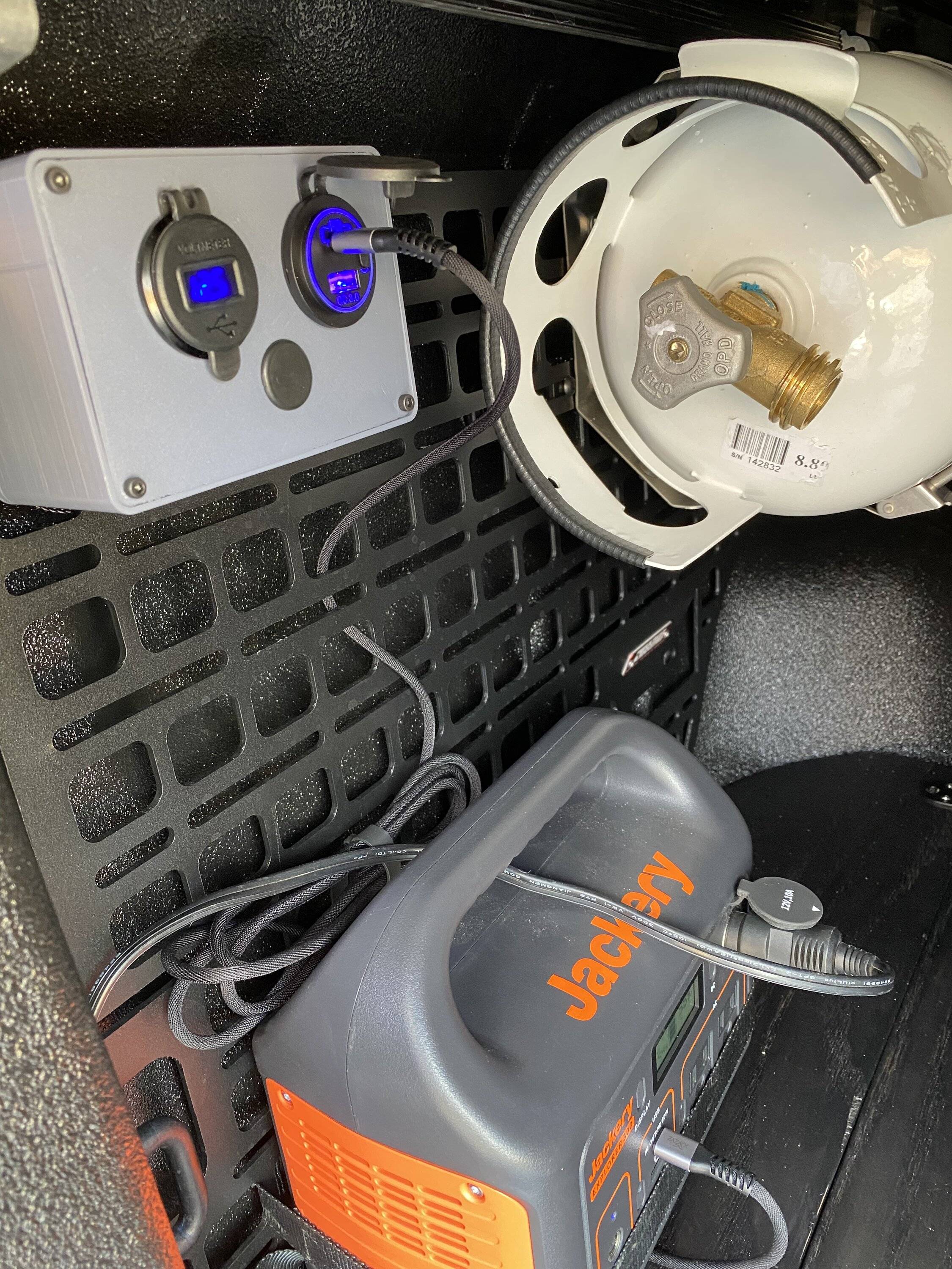

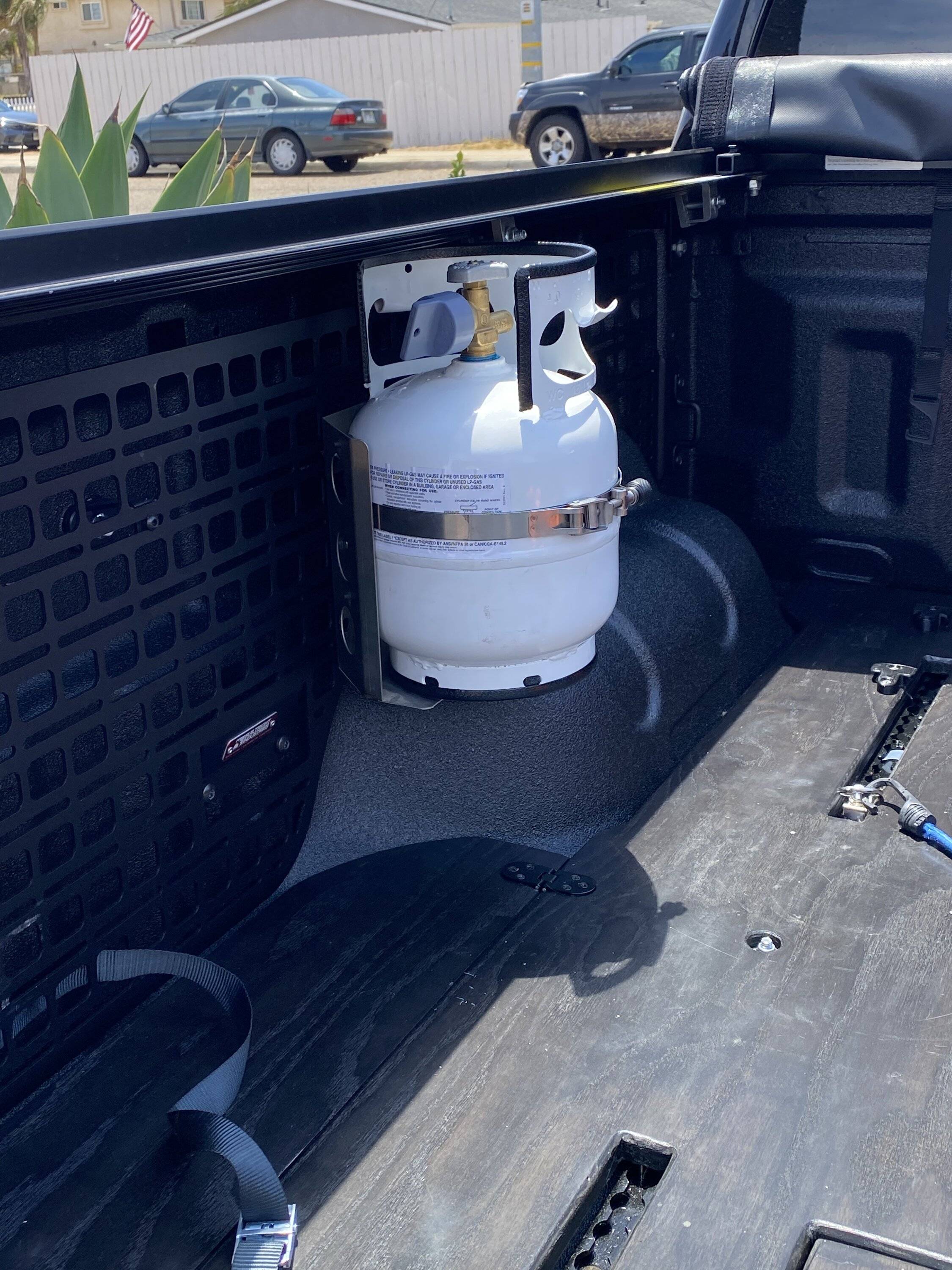

i like to think that i have everything i need in my truck for a night in the sticks but i gotta admit he has me beat lol. im liking the gas and power options like that!

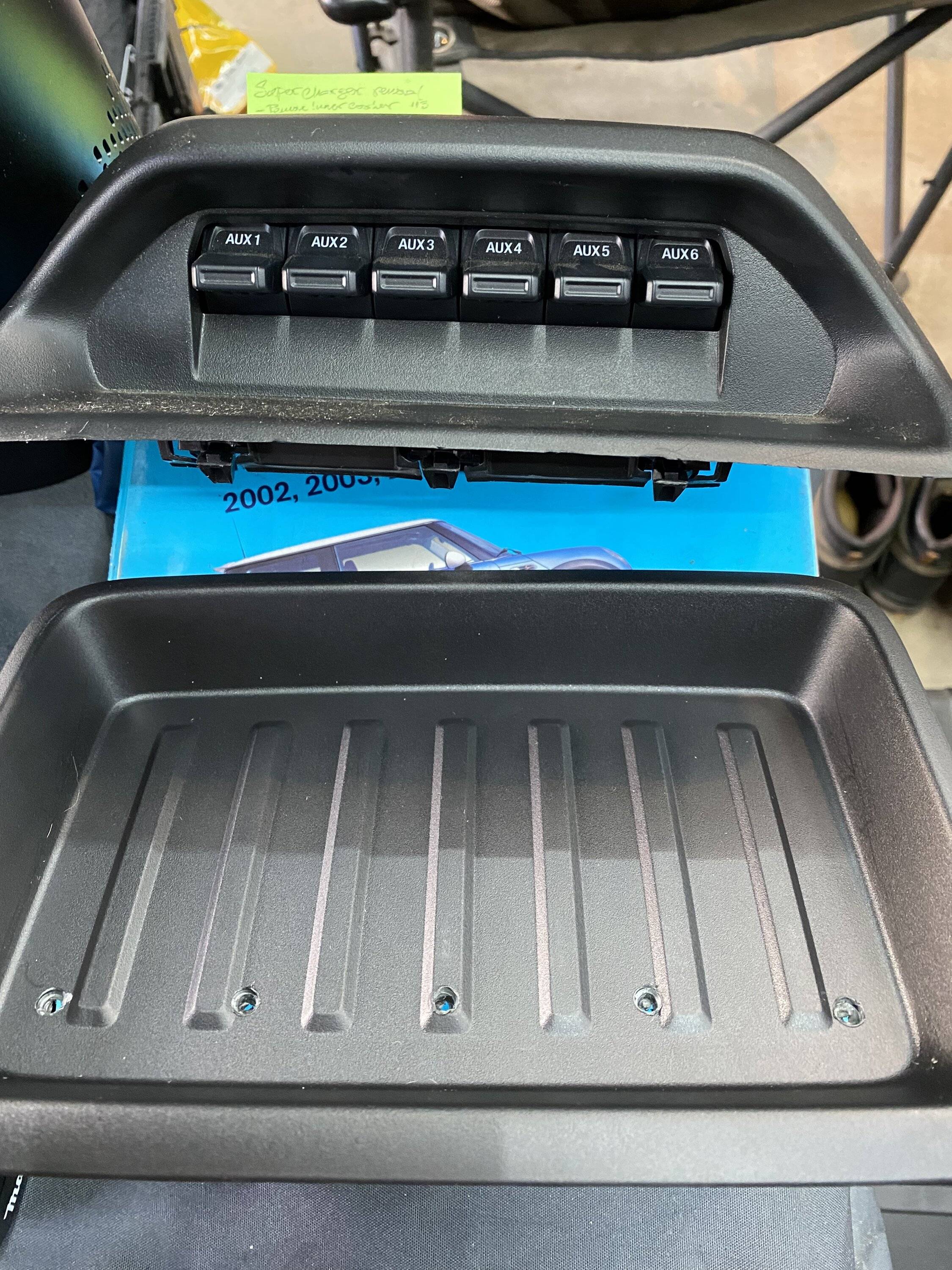

Pulled the Tremor aux switches, not using them right now plus im going to go with something smaller down the road. Props to WLFPIR8 for the ram mount set up. https://www.ranger5g.com/forum/threads/ram-mounts-my-setup.5323/

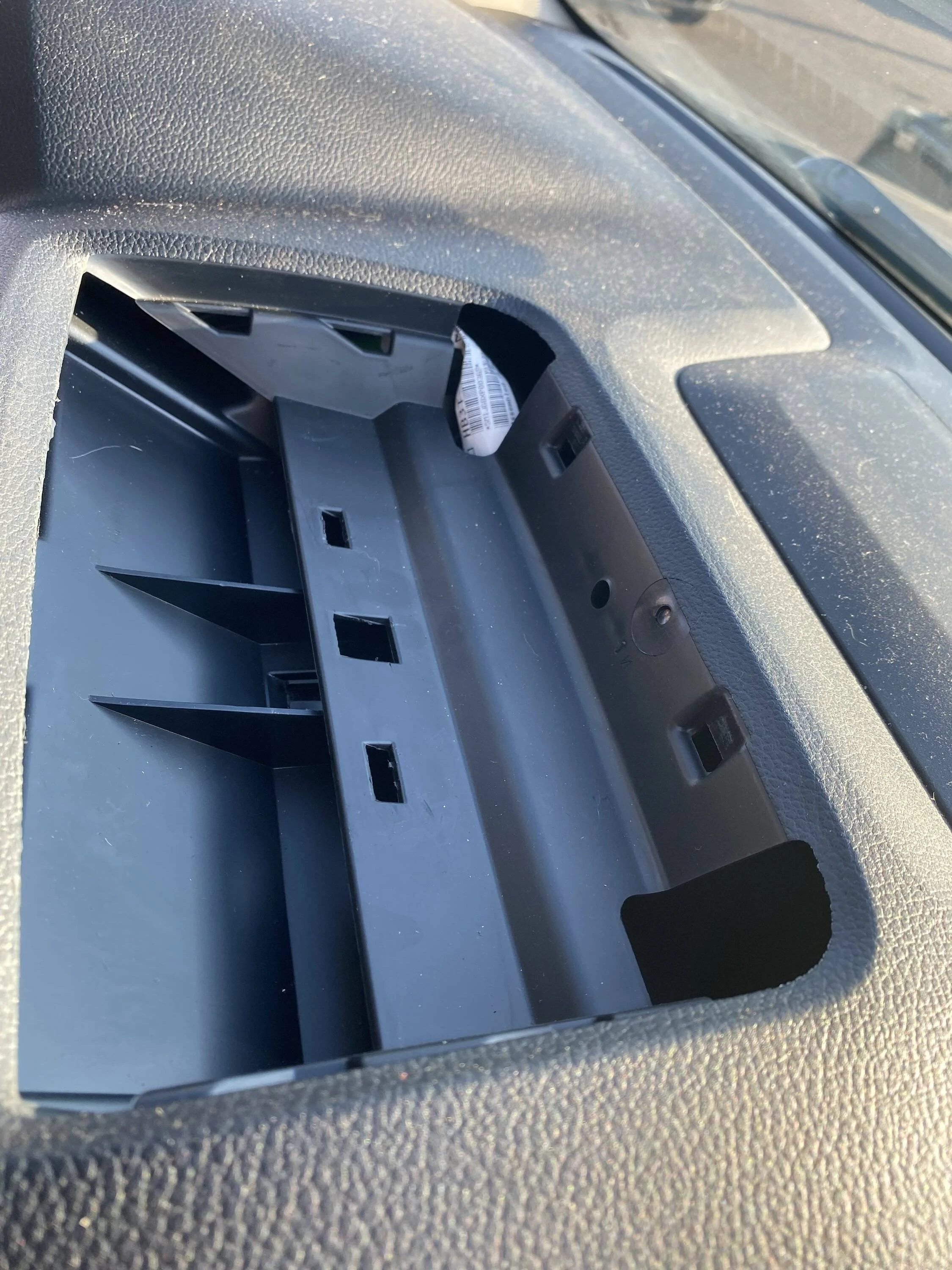

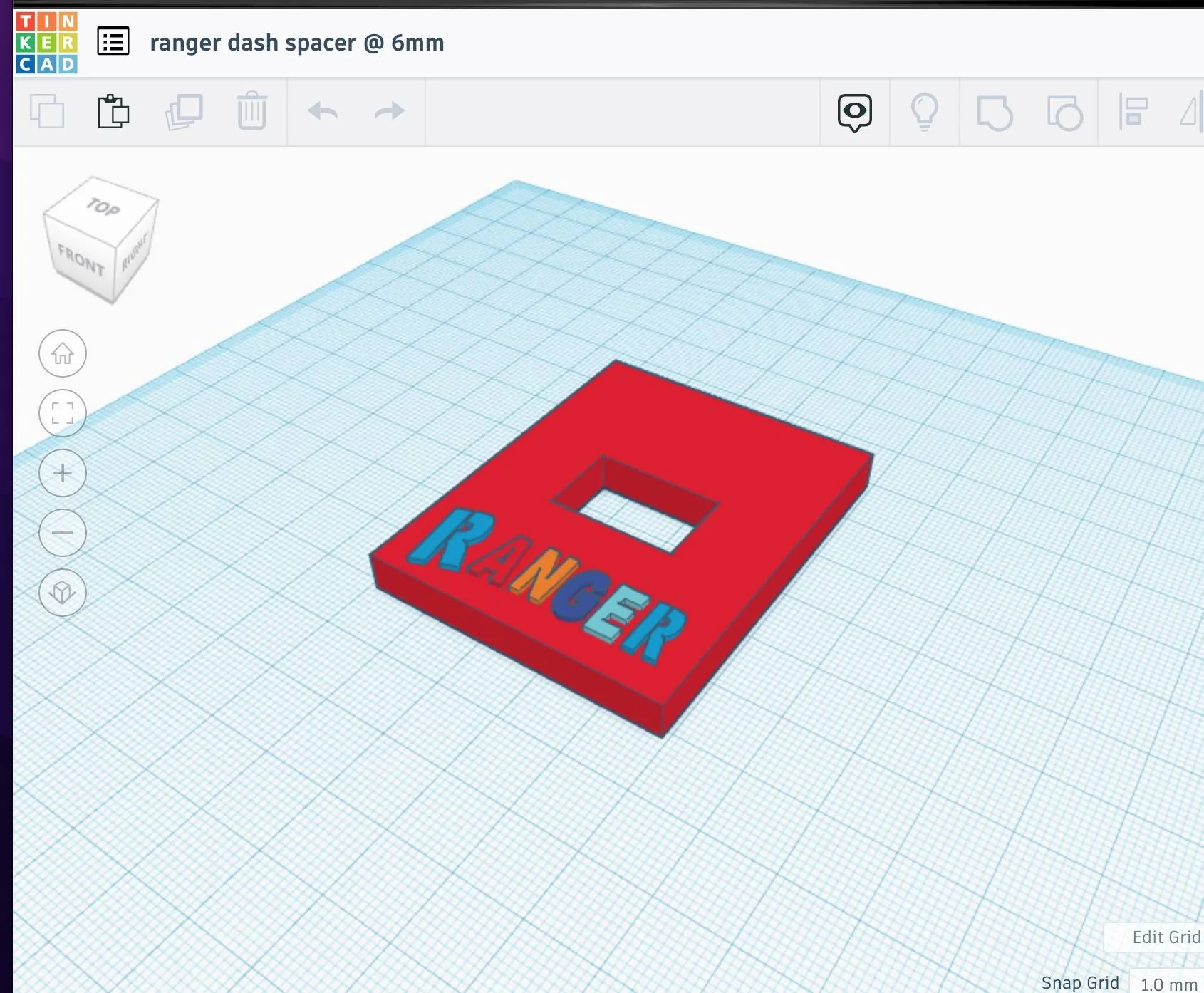

I took my tray out a while ago looking for a wiring harness... anyway, when I put it back in, I cant get the clips on the front facing side (the side closest to me as the driver) to clip in... leaving a small gap. Man, I tried everything. Did you have any problem with that? If so, what did you do to get it to fully seat...?
with the way i have the ram arm bending down i was getting a lot of deflection in the tray so much so that is was pulling the back clips out with the weight of the phone while driving and bumps.
i have a 3d printer so i printed a spacer for under the tray ,in the dash there is that middle large clip and then there is a small void before there are a two cross braces i fit the spacer in there supporting tray on the braces. then i took a piece of door seal and put it under my ram arm to have the dash support it when i hid big bumps or drops.
i dont know if that will help you

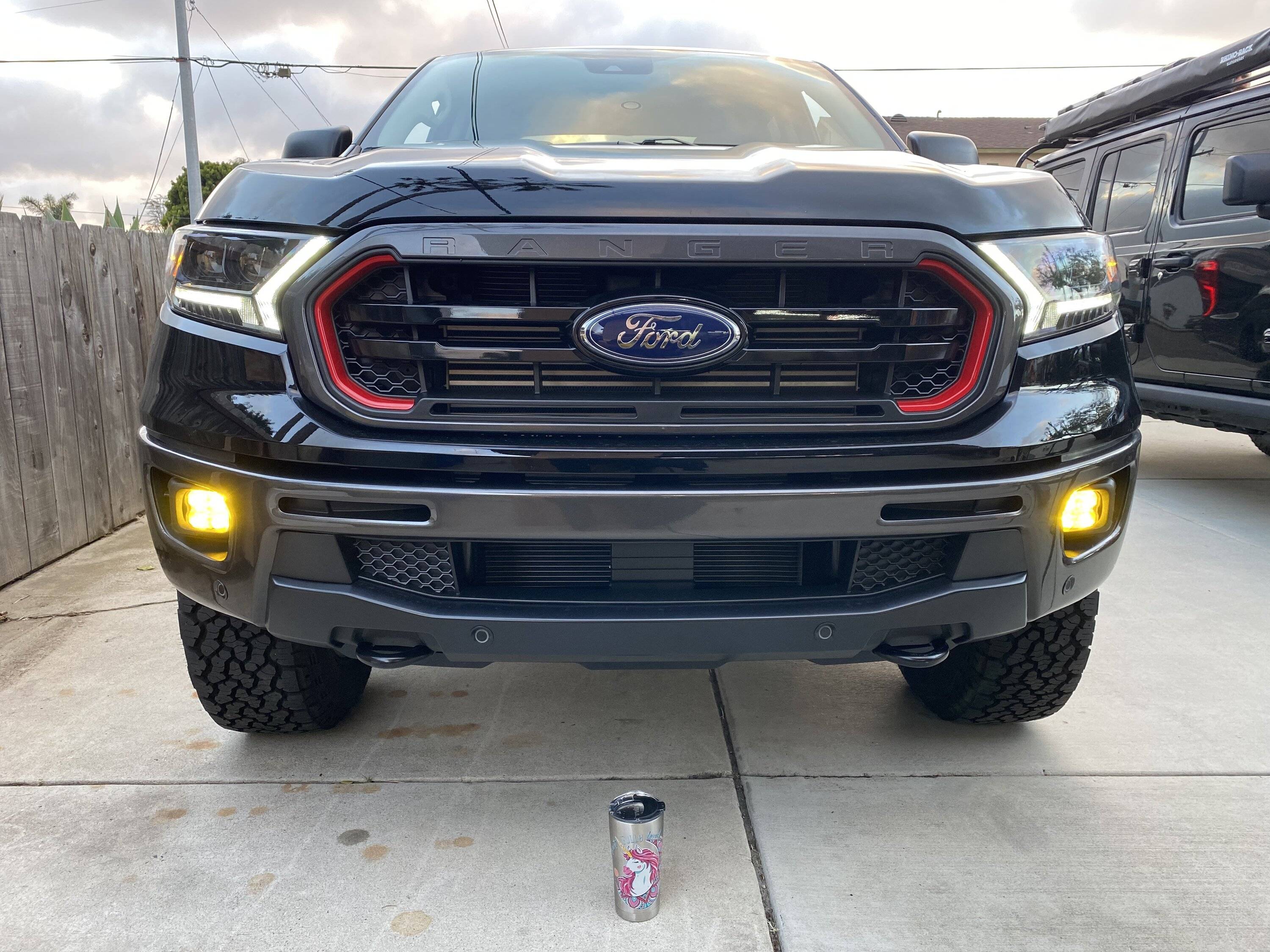

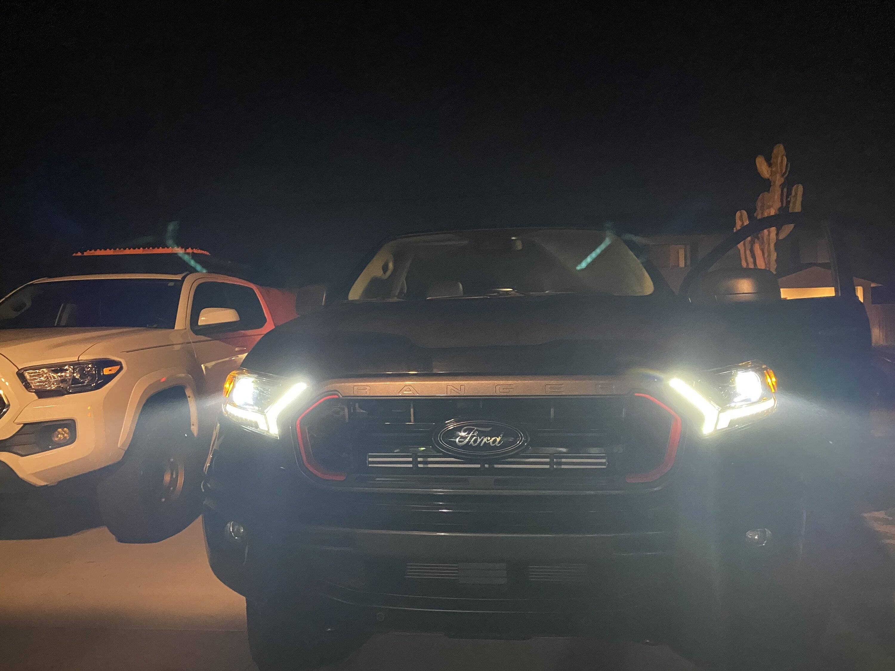

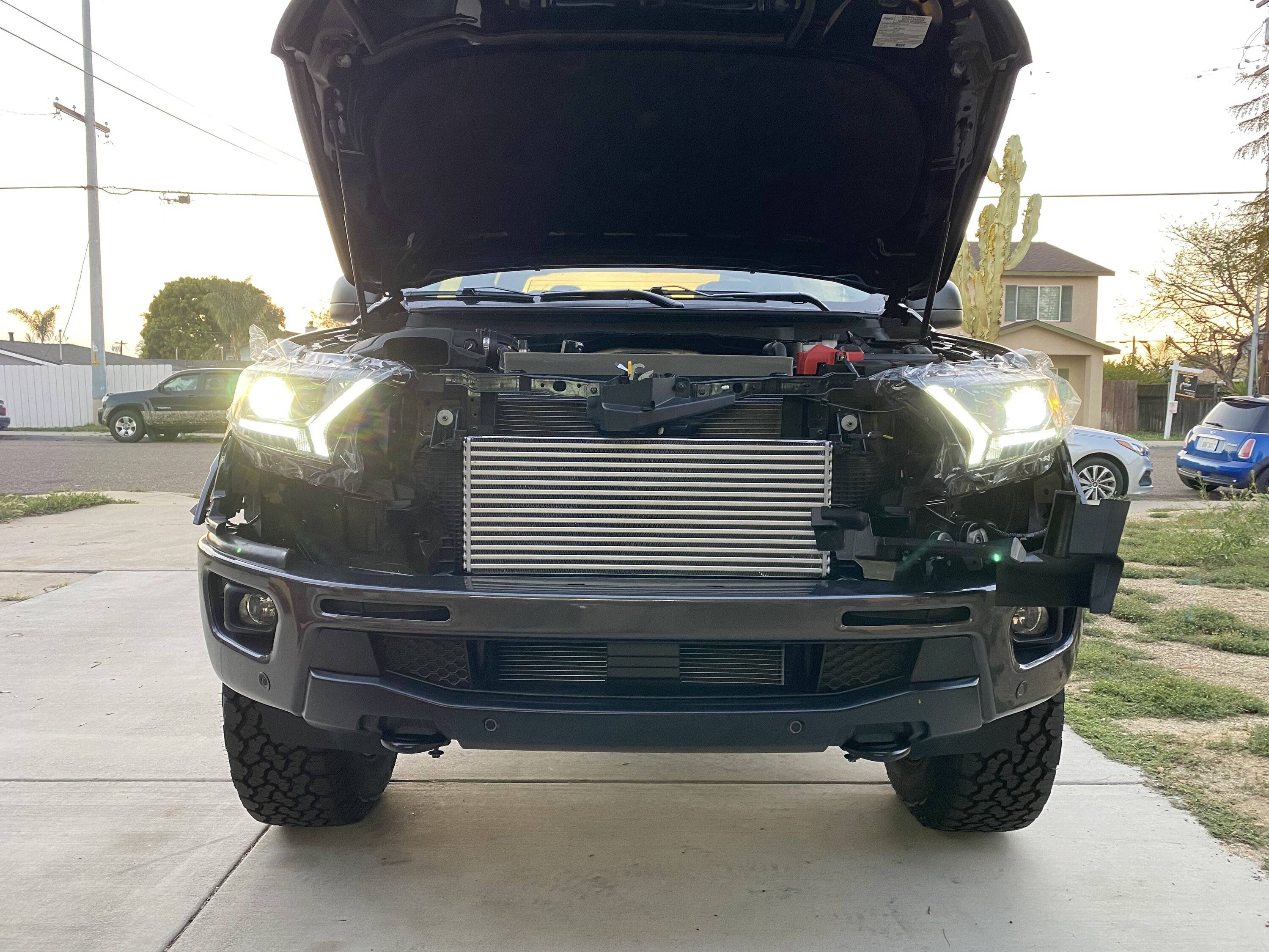

Sharp-looking truck and build, mate. Where are the headlights from? How was the installation?
